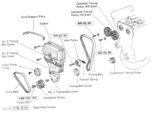

One of the timing belt is kind of wore out; went to two differnt mechanic, one told me that I had to change my water pump and other informed me that I only need to change that old timing belt. Please advice. Thank you.
Oct 24, 2010 at 10:18 PM
  • CERTIFIED EXPERT
  • 75,992 POSTS
All you got is one timing belt in there unless he wants to put another one in there for decoration or whatever. This link will show the timing belt marks and the water pump replacement

You do not HAVE to change the pump, most mechanics will change it as preventative maint.
If you need to change pump 2 months later, you will have to remove timing belt to get to it.

The Corolla 4A-FE & 7A-FE are not cam belt driven water pumps, If your timing belt has been changed as per schedule it will be due again at 300,000 Mls so i would consider having both done at the same time to same some money.

The belt must be removed to get to the WP, so as long as it is removed and not contaminated with coolant, you are OK.
But as Mark said it will save you money, I would replace belt.

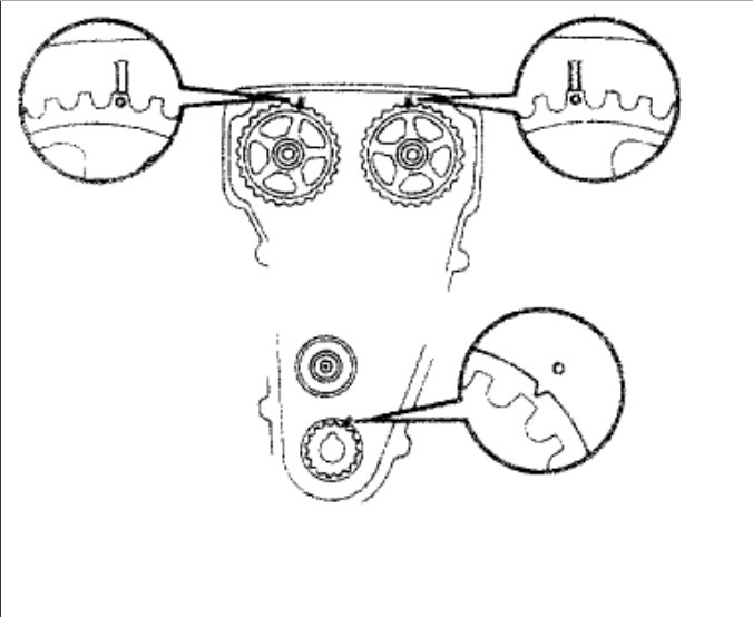

TRISHALL72
timing belt settings because I am replacing it.

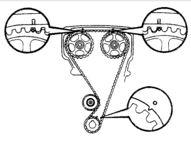

CSBORTHOS
what is the timing marks for the twin cam 5af engine. can you show me the top dead center mark , it is quite confusing. what is the recomended timing for a stock engine.

Does the timing belt drive one cam cog or two?
5AF is a Japanese designation for the U.S. 4AFE, the 4AGE was also available for 1991.

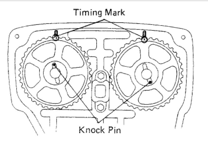

CSBORTHOS
5af drives 2 cams just like the 4af. however, im quite confused on how to set those cams since the timing marks are quite vague similar to 4af. can you show it to me with illustrations. thanks

  • 8,548 POSTS
Best thing to do is use the car repair manual link in this thread or get a Haynes manual.
The two marks on the inside of the cams are installation marks, the marks on the outside (facing passengers side) are timing marks.
You would use a wrench to rotate the cams to align the timing marks, make sure crank mark is aligned, then install belt.
