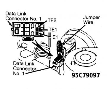

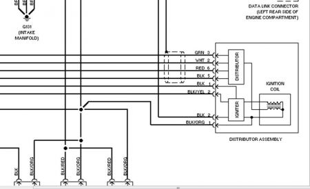

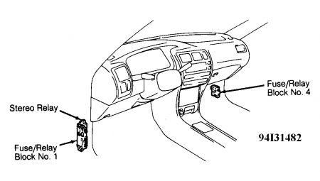

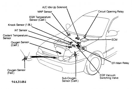

BMRFIXIT
  • 19,053 POSTS
Blk/org wire should have power with key on if not
turn key on do you have a check engine light on if not check fuses and check PCM relay

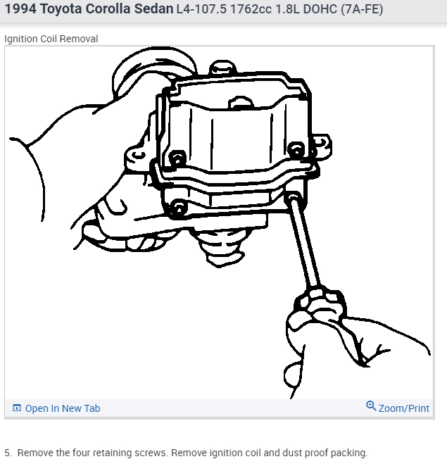

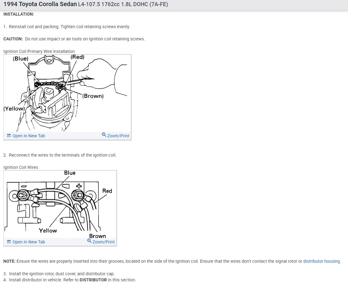

RPCHIVUKULA

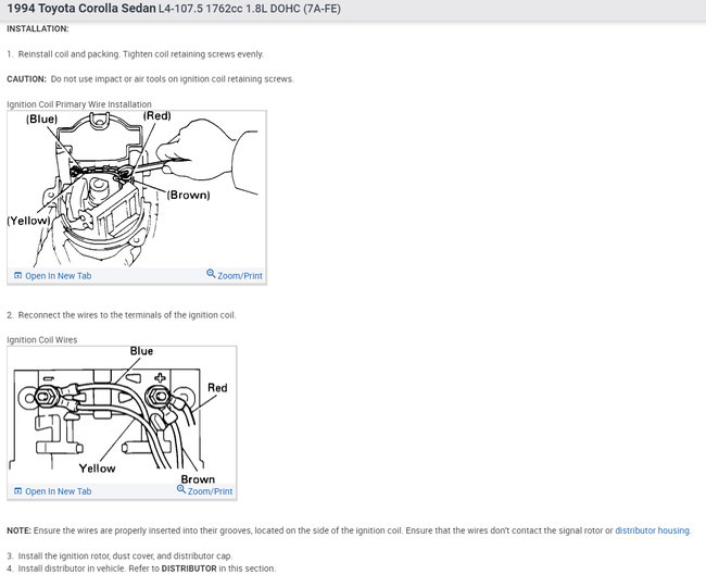

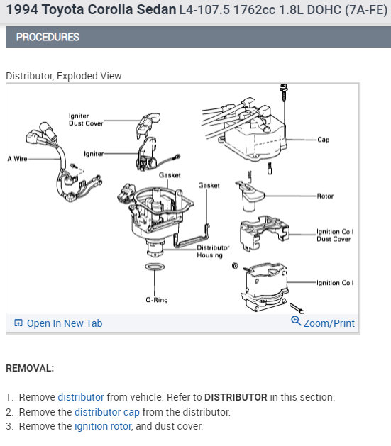

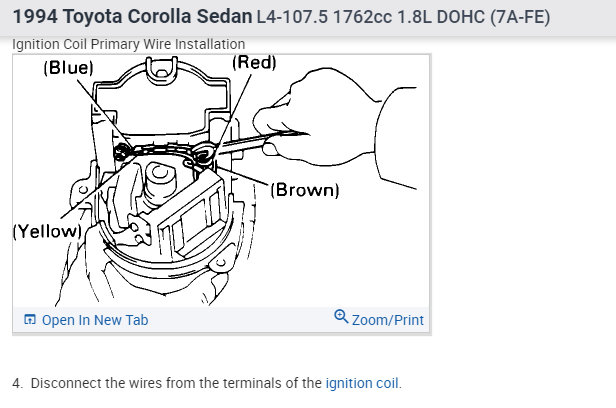

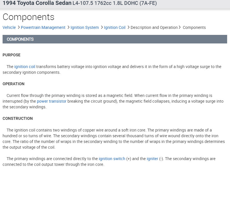

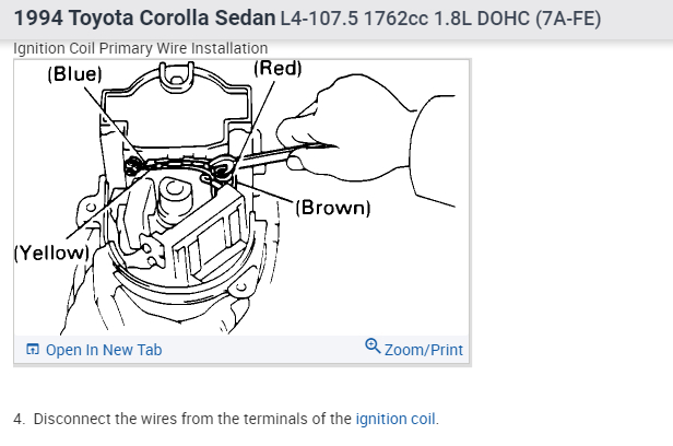

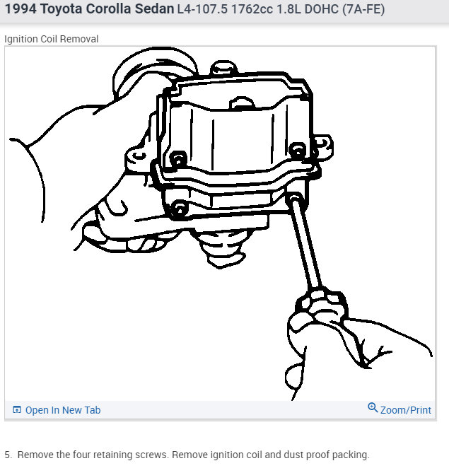

The distributor is new but the coil was not, so I got a new one it started right up. Thank you.
+3
Friday, May 21st, 2021 AT 6:02 PM
SQM
  • 6,383 POSTS
Appreciate you sharing the fix to your problem.
I have attached the coil replacement procedure below for anyone who might be looking for this information.
Please let us know if you have any questions.
