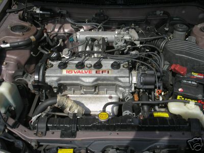

Sounds like a fuel pressure issue as mentioned. The fuel pressure regulator is located on the fuel rail on the passengers side, it is small and round and has a vaccum line to the intake manifold and a rubber fuel return line on the bottom of the unit.
Pressurize the fuel system (don't start it) and pull the vaccum line and look for gasoline, that would indicate the FPR diaphram is ruptured and the FPR must be replaced.
This engine (4AFE) does not have a fuel pressure test port, there is a special fitting that screws into the cold start port on the fuel rail (you have to remove the Cold Start Valve on the rail). This fitting has metric threads on one end and a shraeder valve on the other. You may have to go to Toyota service to get this done, or a garage that specializes in Toyota's.
You need to know what the fuel pressure is before you can isolate the problem.
In the picture below the FPR is the round "cup" directly behind the #1 cylinder.
https://www.2carpros.com/forum/automotive_pictures/108325_b42d_1_1.jpg
