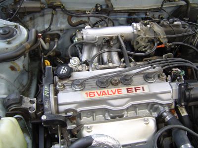

Probably the best idea is to wrap the intake tube on the factory tube with an insulation tape, a company called "DEI" makes a silver tape that insulates from heat. I think I have seen headers for the 4AFE and 4AGE engine. The 4AGE is the high performance version, it puts out 130hp as opposed to the 102 on the 4AFE. Changing would be pretty straightfoward, but the wiring would be a difficult, major difference is the head. Turbos are generally straightfoward installs, but YOU MUST reprogram the ECM and upgrade MAP sensor (2- BAR) to add more fuel to the engine or you will very quickly burn the engine up by running it lean. You may be better off going to an FI engine from a 90-92 Corolla, get engine and wiring harness. Lot of work, but fun to do.
https://images.2carpros.com/forum/automotive_pictures/108325_Picture_149_2.jpg

thanks for the kind help and for the pic
right now i'm trying to improvise on an air intake, try to see if it will work
instead of buying a kit, i'm running a hard rubber pipe fitted with a filter i made out of the stock filter, it's still on the drawing board though...
