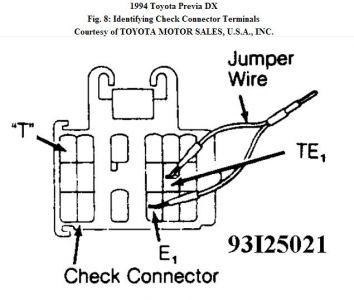

Hi Batman61,
For your year model, it is possible to check for trouble code by bridging the TE1 and E1 terminal of the diagnostic connector in engine compartment.
https://www.2carpros.com/forum/automotive_pictures/192750_DLC94Previa_1.jpg
Turn ignition switch ON and you would be able to read the blinking of the CEL. If the blinking is constant without any pauses, no codes are available.
