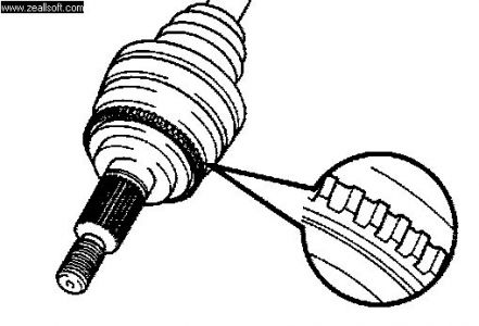

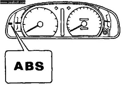

How do I tell if my 1991 camry has antilock brakes or not?

Turn key on do u have ABS light on
or turn thr wheel all the way to one side look down by the caliper if there is a extra wire and sensor
also u can check the cv axle
