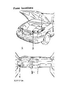

I recently noticed in my 1999 Toyota Solara (Camry) V6 manual that the doom light, the middle dash lights (ac/heat, fan, etc) and the radio and hood & trunk lights do not work. During the day its no problem but evening time only dash lights work are the odometer and its a little hard to see if I am looking for anything. Can someone help...not that it makes a difference but the car has 135k ...hubby says sell the car but I love this car!

hello!! Well, start checking the fuses on the panel... could be as simple as a blown fuse! Location of fuse box:
https://images.2carpros.com/forum/automotive_pictures/576_fuse_box_camry_99_1.jpg

It blew again 50,000 down the road....(the fuse) that is...almost at 200k still driving this awesome car but I swear I forgot how I changed that fuse...go figure!
