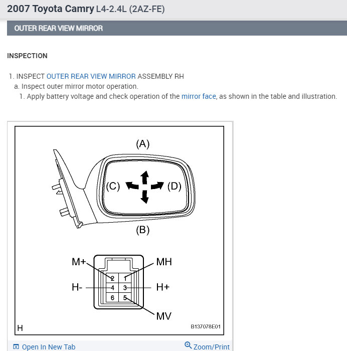

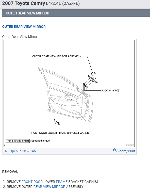

How do I replace the driver's side mirror assembly (no heat). There is no body damage and the electric connection is fine.
Jan 21, 2010 at 5:28 PM
SQM
  • 6,383 POSTS

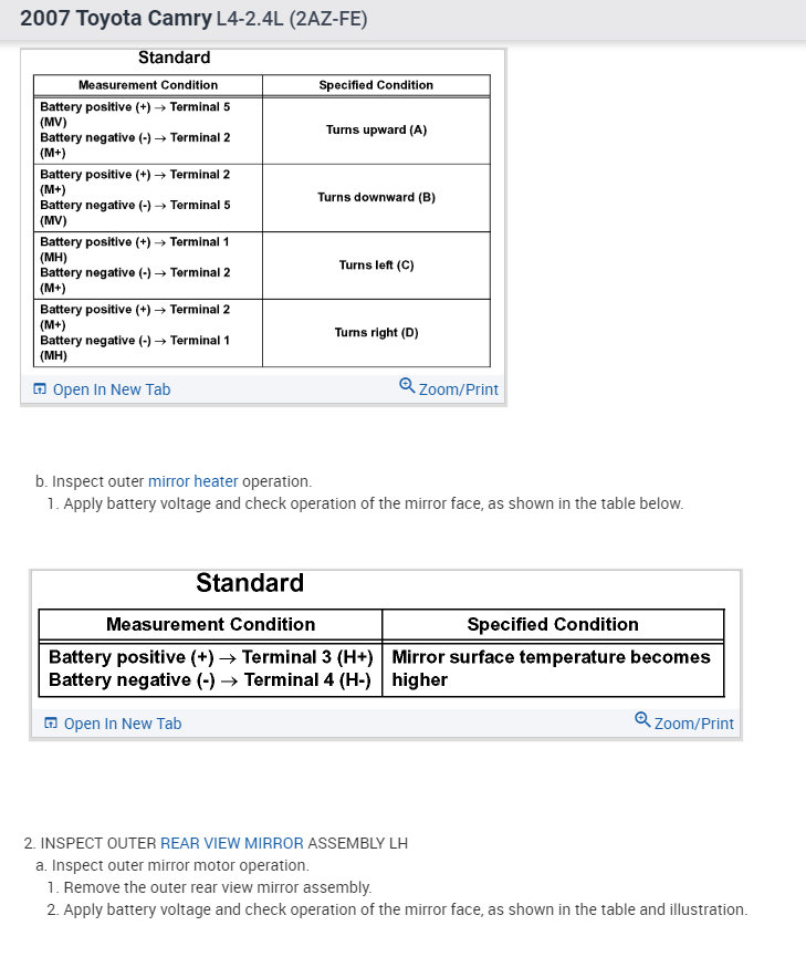

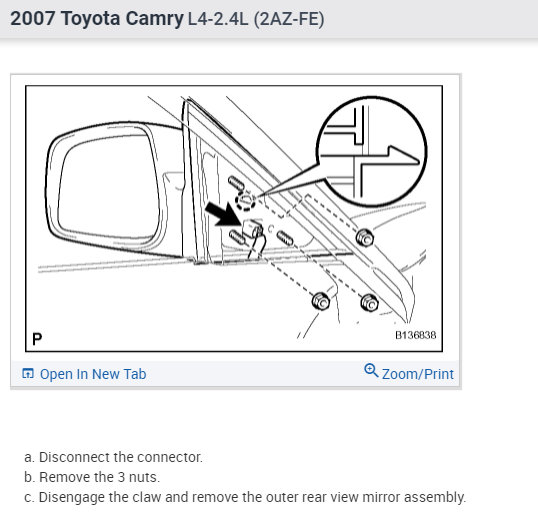

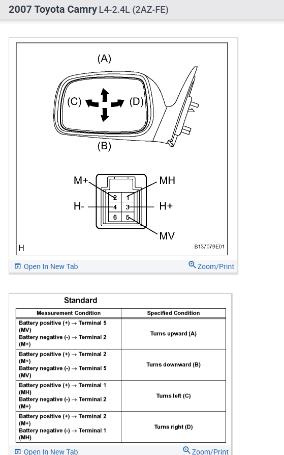

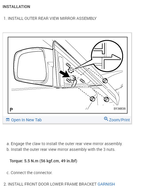

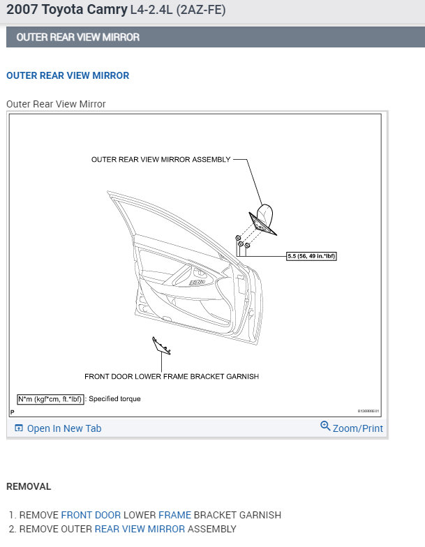

The outside mirror replacement procedure for this vehicle can be done easily.
First you will have to remove the triangular plastic garnish that is located inside the door at the back of the mirror mounting point.
Simply pull outwards for it to release.
Removing that cover will give you access to three mounting nuts.
Simply unplug the wire and take off the nuts.
