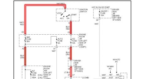

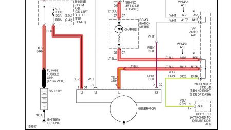

After trying several alternators, and cleaning the air idle valve and changing the battery, I am test driving it. When the car is idling and the air conditioning is turned on, the draw on the battered is quite noticeable , the voltage drops considerably and the alternator light come on.

Have the battery and alternator load tested, also check all fuses involved
https://images.2carpros.com/forum/automotive_pictures/12900_alty1_10.jpg
https://images.2carpros.com/forum/automotive_pictures/12900_alty2_4.jpg
