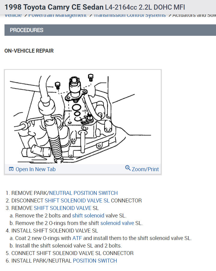

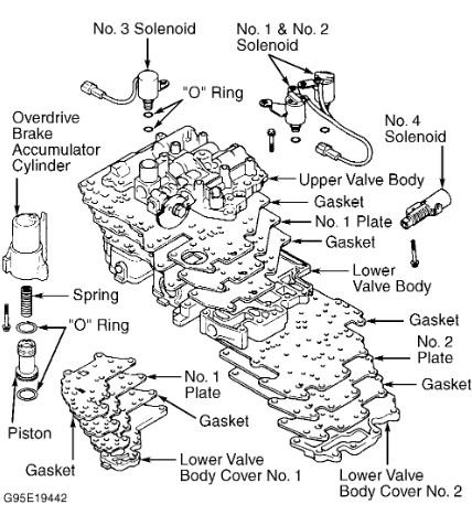

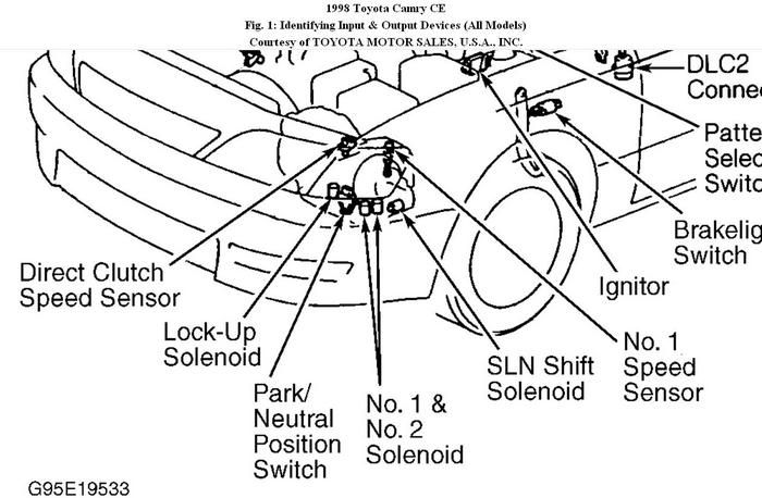

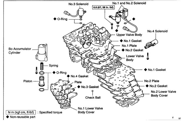

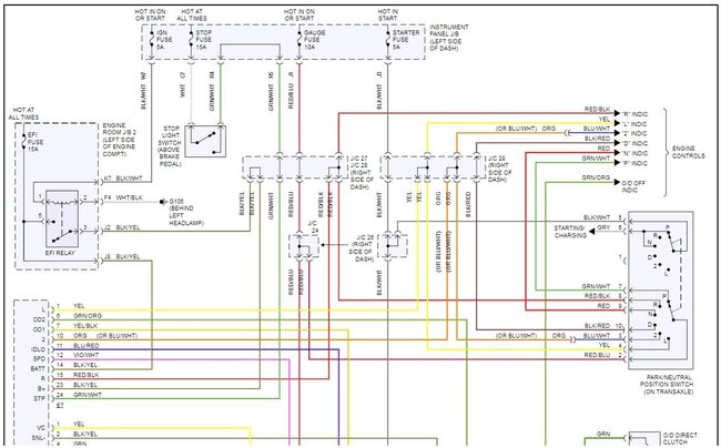

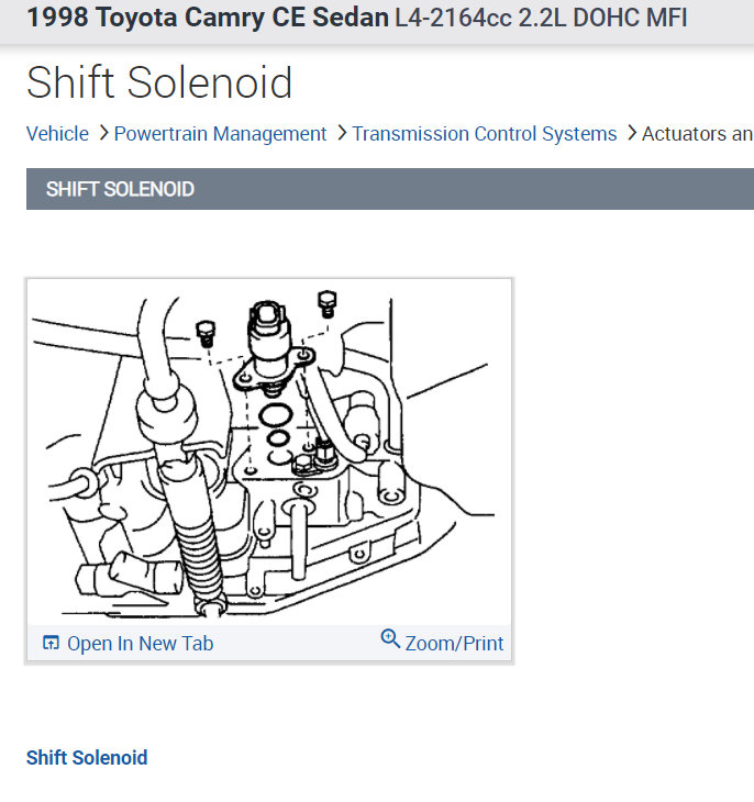

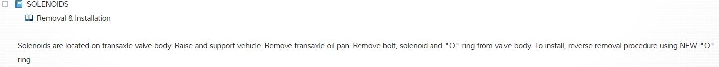

hi i was wondering if anyone knew where the shift solenoid on a 2001 toyota camry le is located in or outside the transmission?
Jul 13, 2008 at 7:41 AM
OBXAUTOMEDIC
  • 3,711 POSTS
The shift solenoid is located inside the tranny, mounted on the valve body. Here is the locations of the solenoids and how to change them in the diagrams below. Check out the diagrams (Below). Please let us know if you need anything else to get the problem fixed.

327IMPALA1
  • 30 POSTS
Where is shift solenoid e located on valve body how to test it.
Sep 27, 2020 at 3:56 AM (Merged)

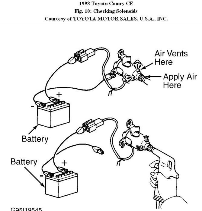

KHLOW2008
  • 41,814 POSTS
It is the lock-up solenoid and not shift solenoid. To check solenoid seals, remove suspect solenoid. Connect battery voltage to solenoid. Apply 71 psi (5 kg/cm2 ) to solenoid with battery voltage connected. With battery voltage applied, air should pass through solenoid. Disconnect voltage to solenoid. Ensure air does not pass through solenoid. Replace solenoid if defective. Check out the diagrams (Below). Please let us know what happens.

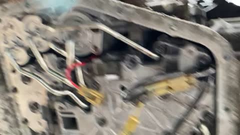

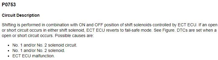

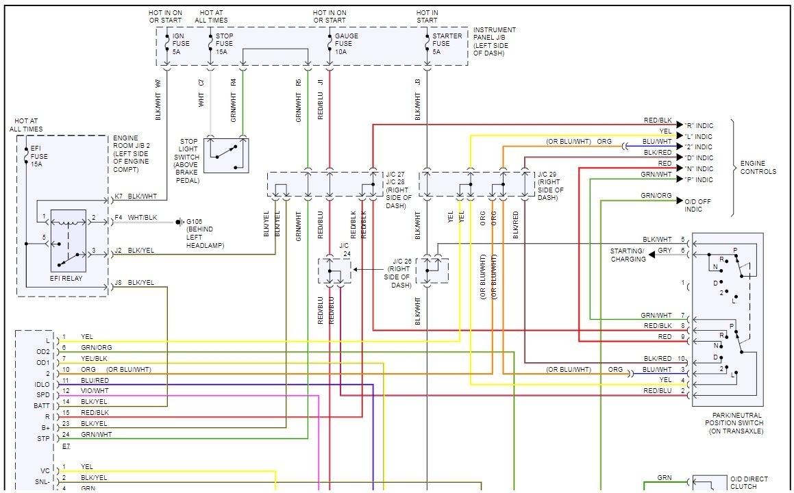

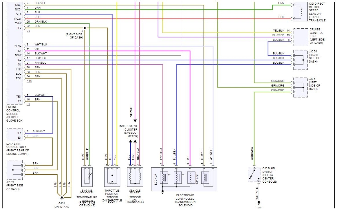

JAY_SANCHEZZ15
  • 45 POSTS

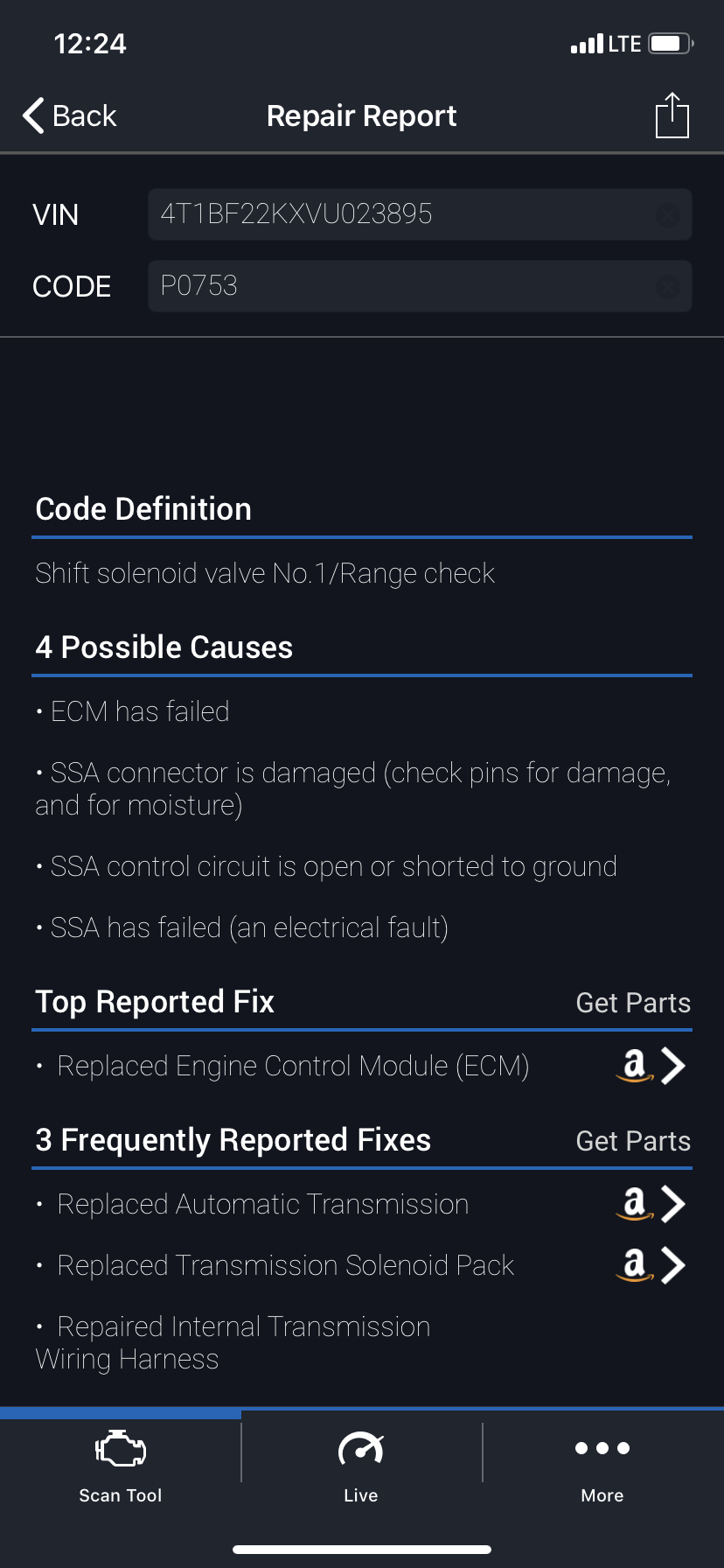

My car listed above has suddenly thrown a shift solenoid code.
This occurred the other day when I was parked at a red light.
When I began to proceed, the vehicle would hardly moved when accelerating, as if the first gear was slipping.
The check engine light illuminated instantly at that time.
However, after pulling to the side of the road, I was actually able to drive normally again for the rest of the day.
It is an intermittent issue I suppose.
The transmission fluid and filter has been changed, not flushed, about 3 months ago.
Light pink color, but with a little dark.
I have looked into it an it seems it’s an electrical issue.
This makes sense because the car shifted great the rest of the day.
Any help would be appreciated as the winter is approaching here in Minnesota.
I have attached my code description from Blue Driver for reference.
Sep 27, 2020 at 3:57 AM (Merged)

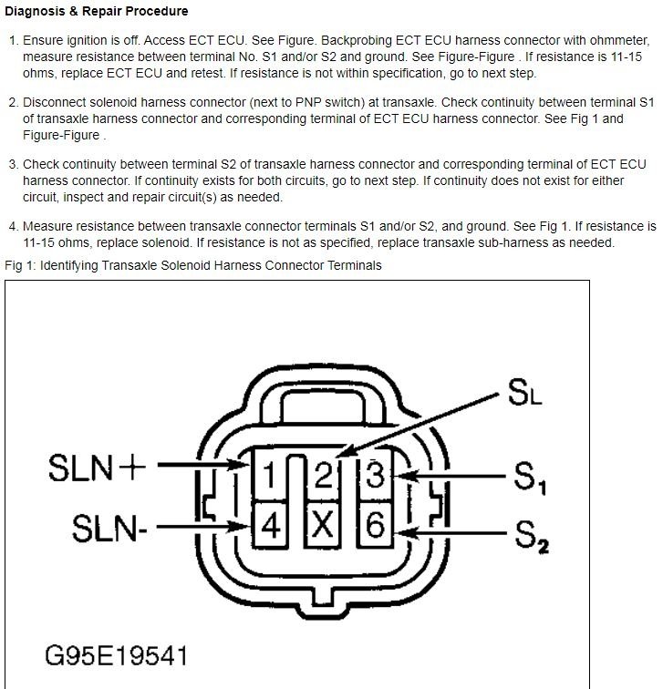

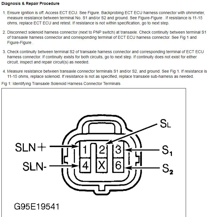

MASTERWRENCH
  • 258 POSTS
I've attached a copy of the diagnostic procedure for this code, wiring diagrams, solenoid replacement procedure and diagram of the valve body components. I suggest going through the complete diagnostic procedure, but in most cases, this code is set by a failed solenoid. From what I can tell, shift solenoids 1 and 2 (A and B) are replaced as a pair. They are located on the bottom side of the valve body and are accessible once the cover pan is removed.

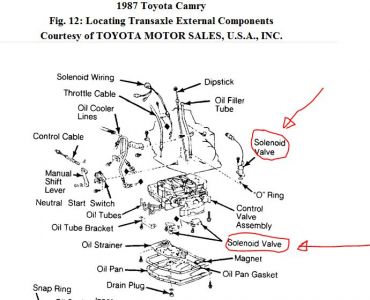

MACORONAS
1987 Toyota Camry
The automatic transmission doesn't shift to forward unless engine is revved at very high RPM after replacing
bad transmission solenoid. The solenoid installed came out of wrecked car, I tested it and it seemed to work fine. Now, if I drive the car back and forth a few times after a while a small amount of white smoke comes out of the transmission fluid insertion tube and I have to rev the car to high RPM.

MACORONAS
I need to find transmission solenoid #3 and would like to know if anyone can tell me where it is located.
MHPAUTOS
  • 31,937 POSTS
there is a special adapter and pressure gauge needed, i would get a trans tech to do this test as they will have a better underestanding of the reading and be able to interpret any faults more accurately, i will look into the N0 3 solenoid for you.
mark (mhpautos)
MACORONAS
Sorry, if I sound a little frustrated. Thanks for the reply.
I checked solenoids 1 and 2 and their wires and they are working fine, called Toyota and they told me that there is a #3 solenoid. Number #3 solenoid, I believe also called lock up solenoid, checked malfunctioning before I started
taking things apart, so my theory is that is possible that #3 is not working.
Thanks again
MHPAUTOS
  • 31,937 POSTS
This is the best pic i can find of the solenoid.
https://images.2carpros.com/forum/automotive_pictures/61395_Capture_80.jpg
Mark (mhpautos)
