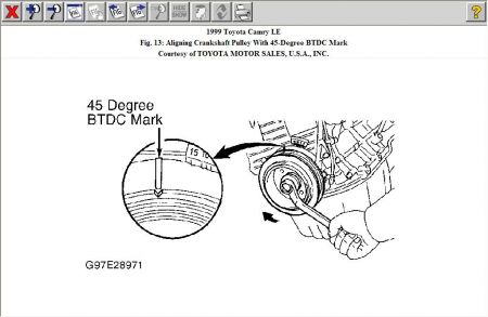

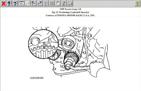

yes we have replaced water pump and are having problems putting on timing belt not sure how to line it up.
Monday, June 16th, 2008 AT 5:00 PM
MECHANIC
75,992 POSTS
See below
