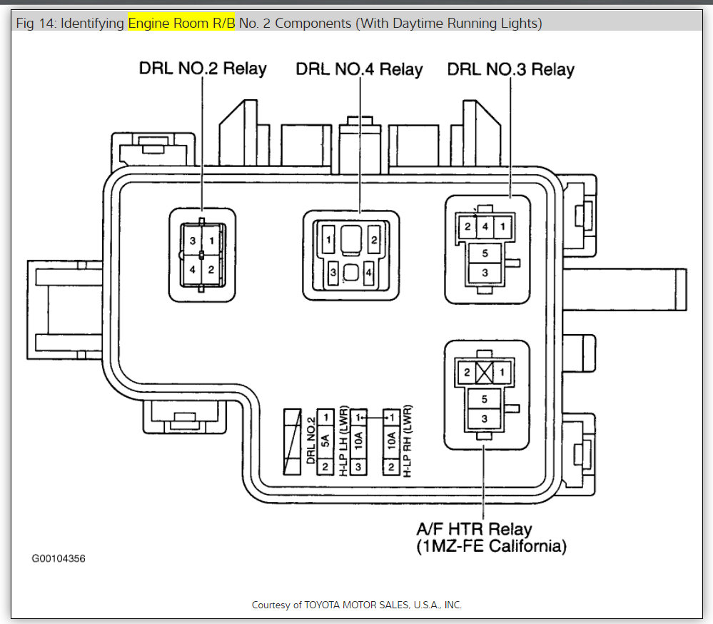

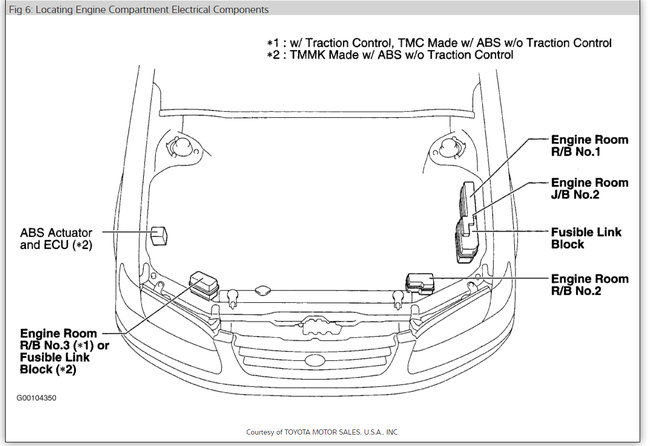

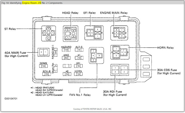

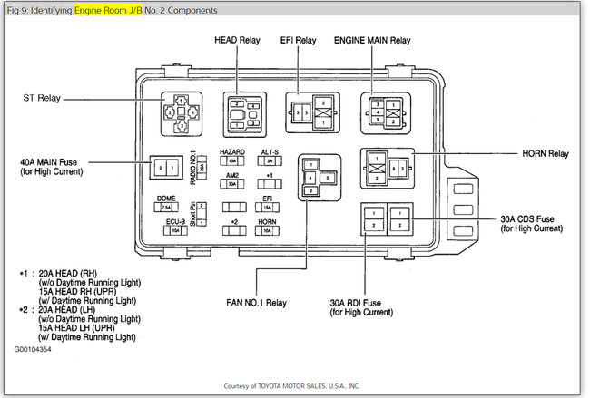

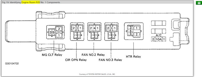

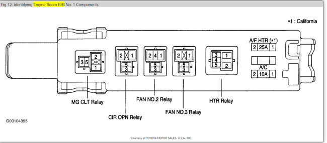

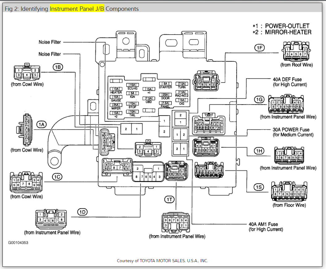

looking for location of fuel pump relay?
Jan 7, 2010 at 7:57 AM
  • 75,992 POSTS

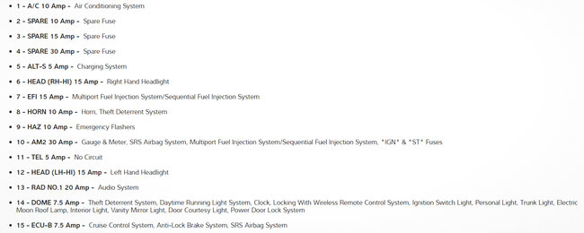

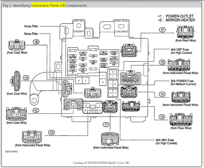

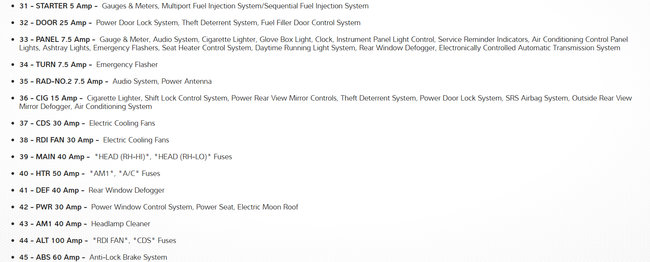

The relay you're looking for is the circuit opening relay which is located in the engine compartment in relay box no.1 Here is a guide to help check it with the diagrams of the location below.
Jan 7, 2010 at 11:32 AM
TEXACA
  • 34 POSTS
where is the fuel pump relay on a 1998 toyota camry located.
Apr 17, 2019 at 4:40 AM (Merged)
HMAC300
  • 48,601 POSTS

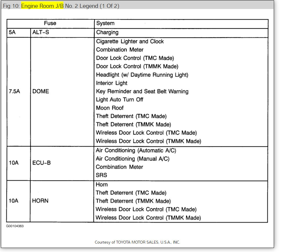

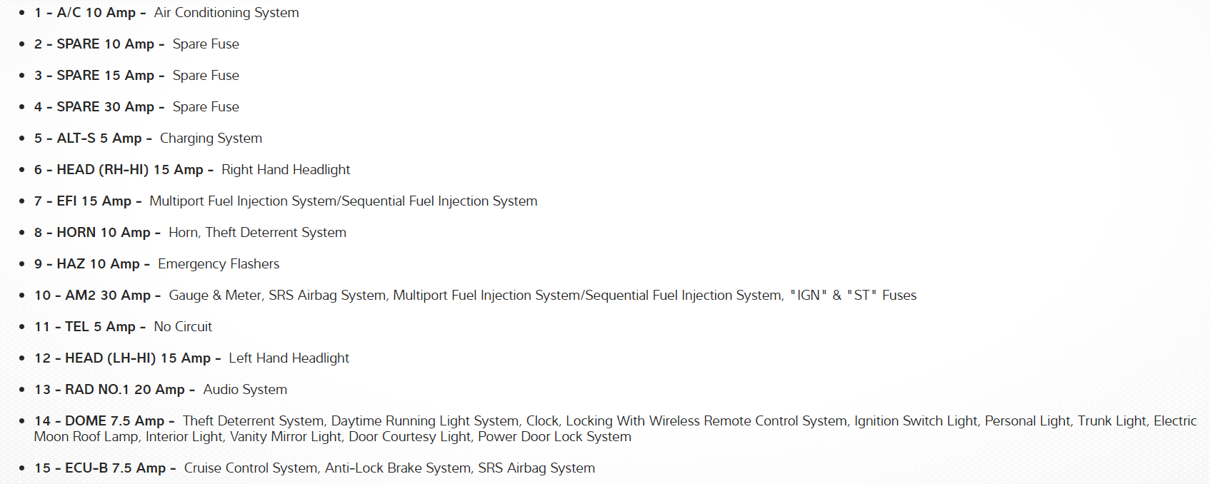

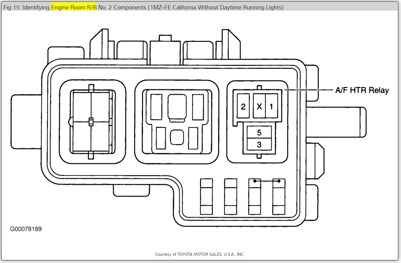

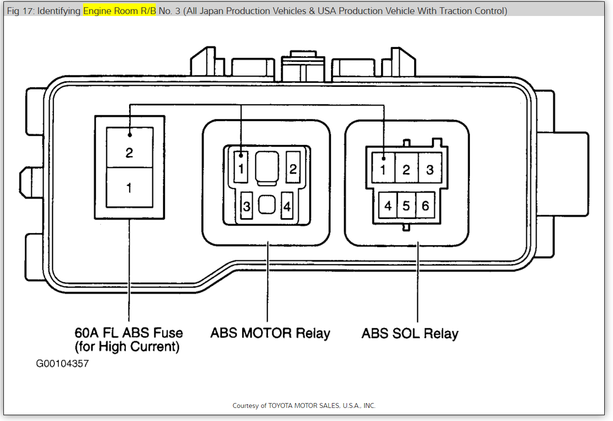

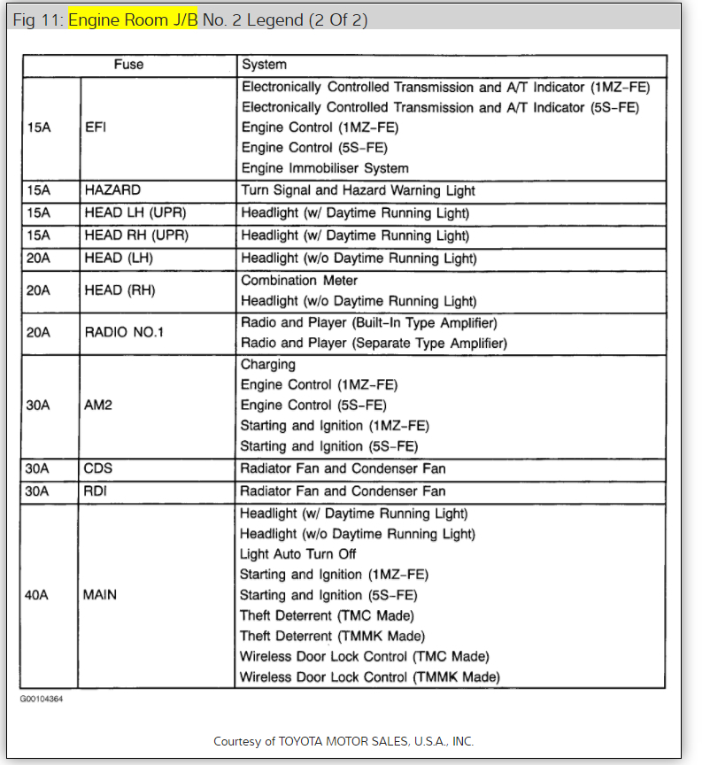

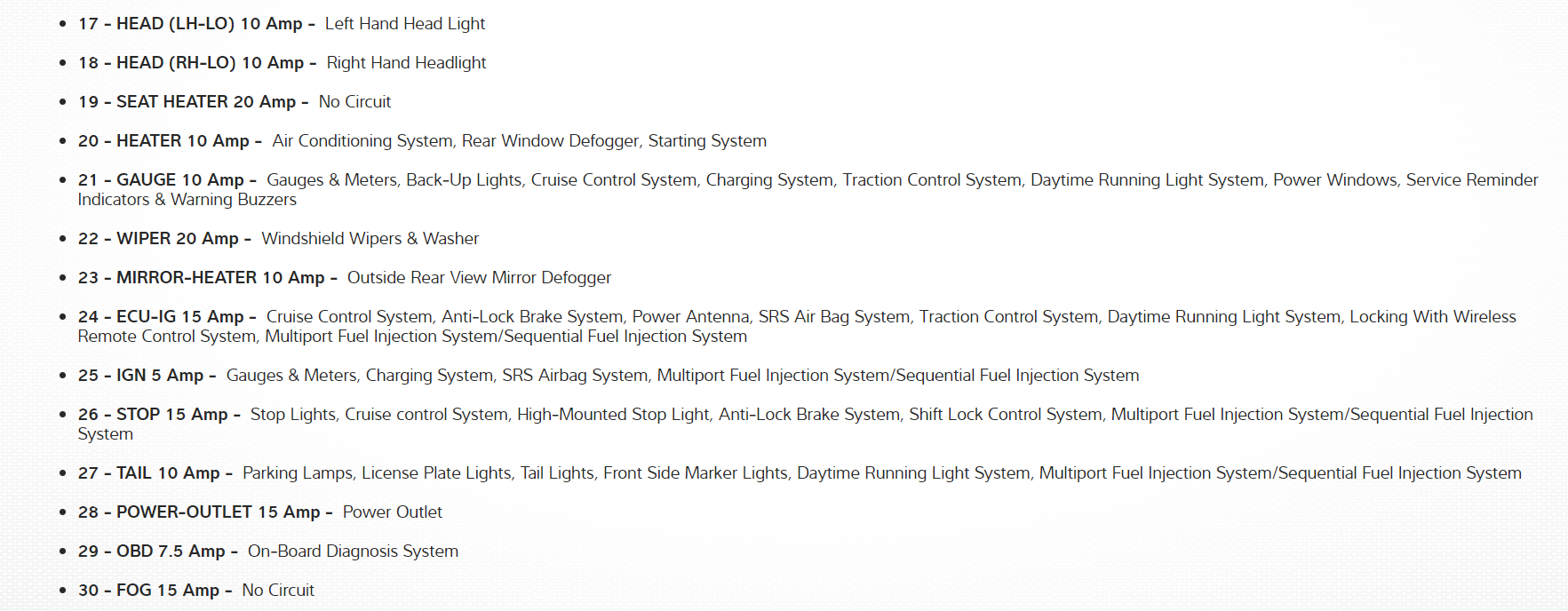

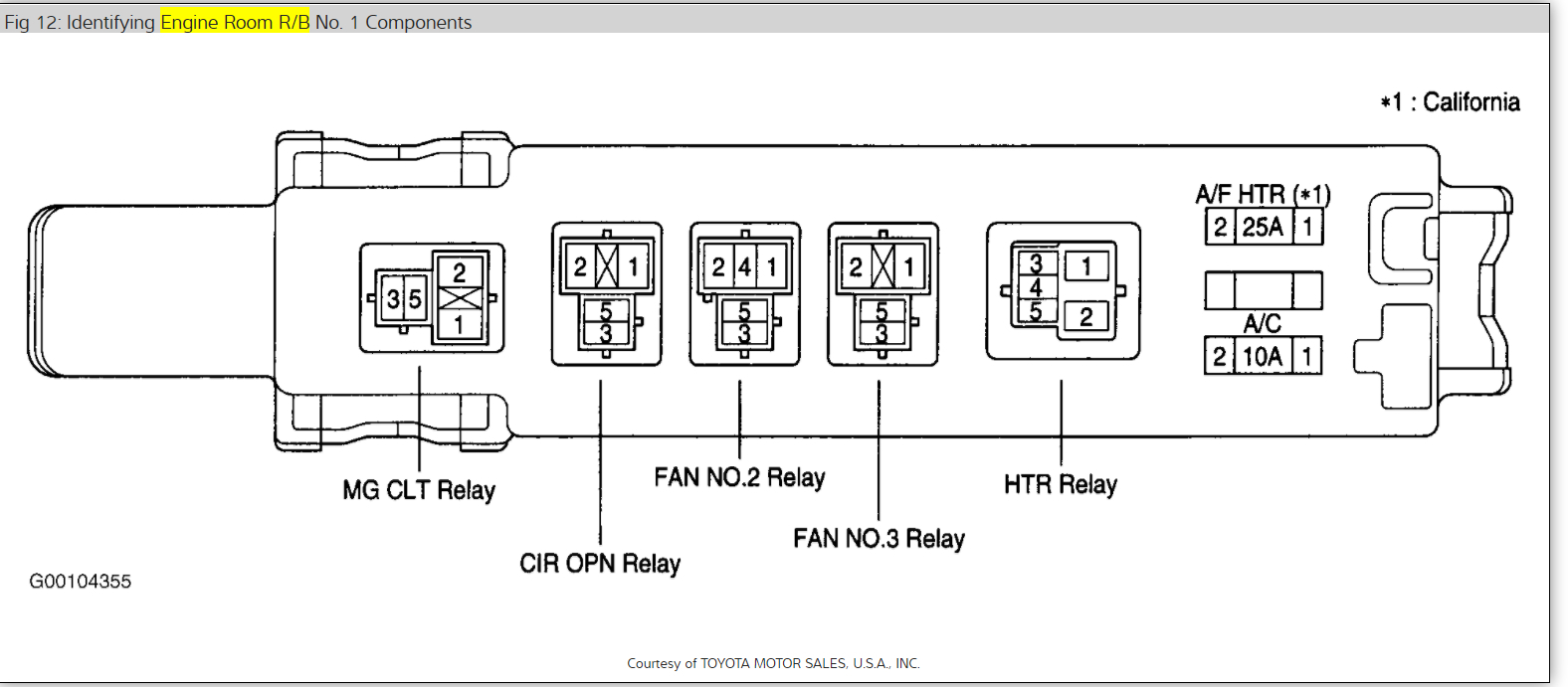

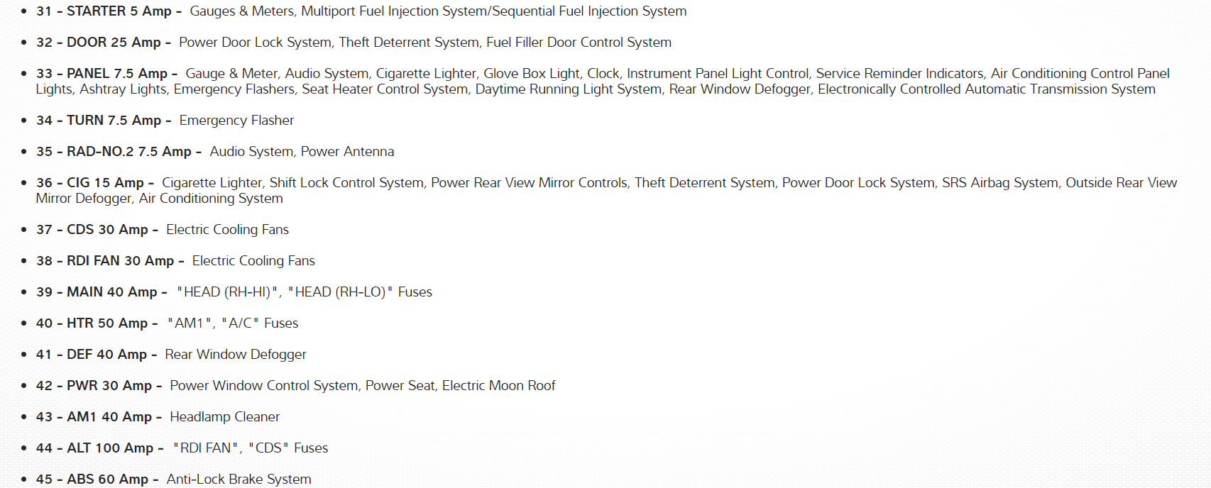

The fuel pump relay is called a EFI relay and its located under the hood.
Here is a guide to help you test the relay
Here are the fuse and relay locations
Cheers
