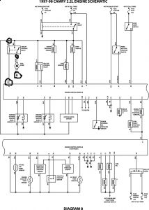

Check out the engine and fuel pump wiring diagrams (below). Please let us know if you need anything else to get the problem fixed.

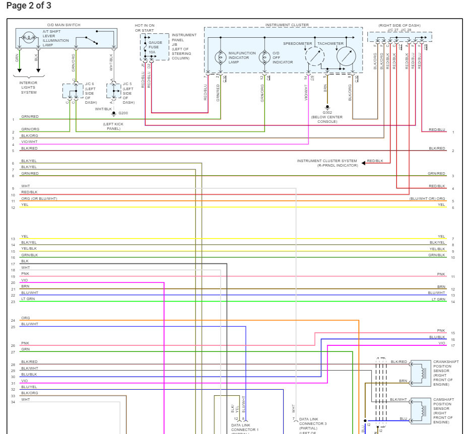

Have checked timing belt, in time. Ohmed the two pickups in the distrubitor and they read in spec. Another site showed two relays in the fuel pump circuit, first the EFI relay is pulling in when the key is in the run position. If I am looking at the correct relay (the other site called it the "circuit interrupting relay") in the passenger kick panel med size black relay just to the right of the ECU. I am getting very frustrated at not being able to find out what things might keep the CIR from pulling in.
-2
Friday, July 20th, 2018 AT 2:15 PM (Merged)
TNBIGFOOT

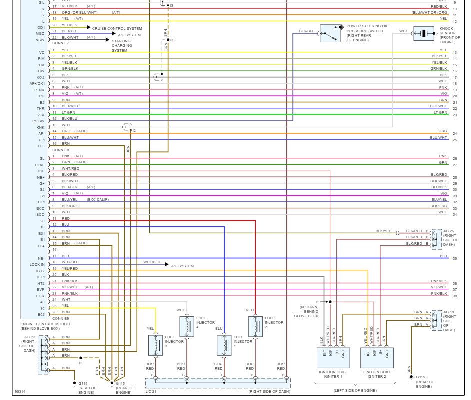

The car was not running and I replaced the fuel pump. It started and ran good. After the second start it shut off from 2,000 rpm's and I have checked and rechecked everything I can think of. There is no power to the pump when you turn the key run for the two seconds. I also checked the distributor pickups with an ohm meter and the ohm okay. Also ohmed the coil and it looks okay. Checked voltage at the primary of the coil and no reading when the key is in run or start. Do you know where I could find a schematic for the car? I am pretty good at wiring and troubleshooting need to know how the circuit works.

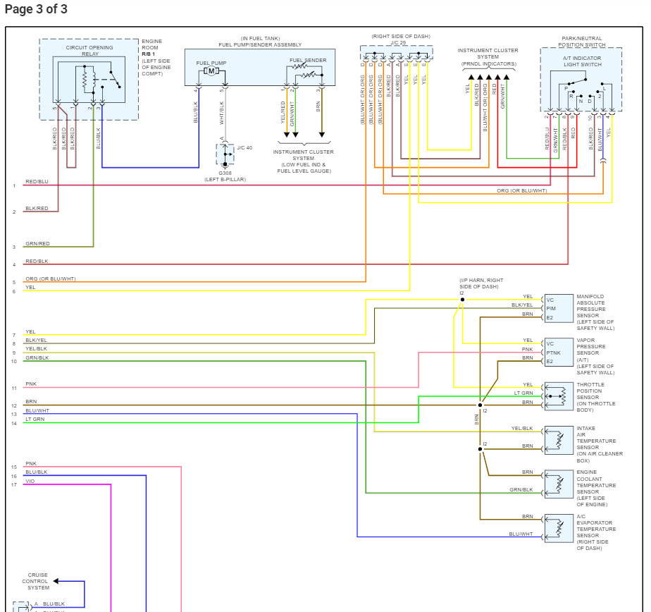

My car quit running the other day at a stop sign. Got it back to the house, checked fuses, all seem good. Removed fuel pump and checked it out of the tank (reattached to wiring still in car), tried to start the car and nothing from the pump. Installed a new pump and still nothing. I believe the C/OPN relay controls power to the fuel pump, checked it, even swapped it with a few others that were the same and still nothing. Car will run if you spray starter fluid so it is getting spark. Also the check engine light never came or anything else. Anything else I need to check? Thanks
+1
MATHIASO
  • 1,209 POSTS
Hello_
It has spark and compression but no fuel based on your diagnosis when spraying a small amount of aerosol starting fluid into the engine and getting it started before it shut off again.
There is no power to the fuel pump/the new fuel pump.
The relay has been replaced.
What you could check is for an open anywhere in fuel pump wiring circuit (power or ground).
https://www.2carpros.com/forum/automotive_pictures/46384_0900c1528009289aq_1.jpg
