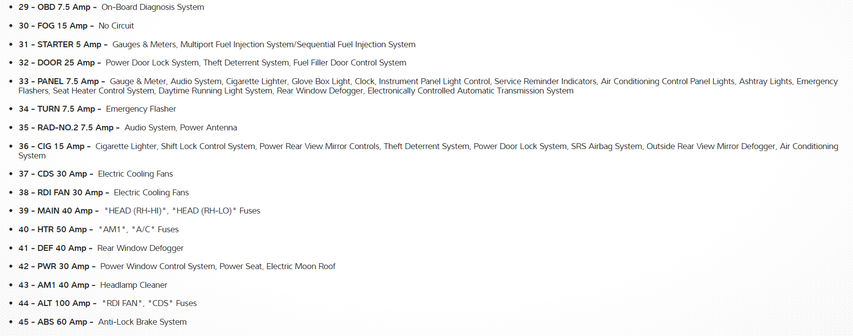

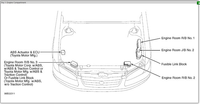

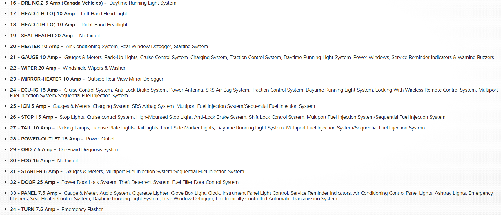

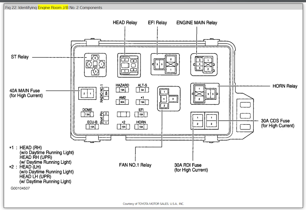

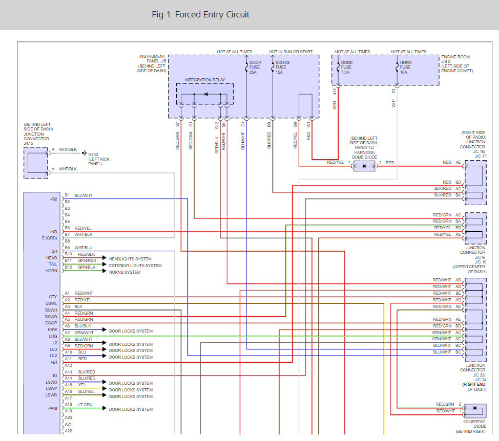

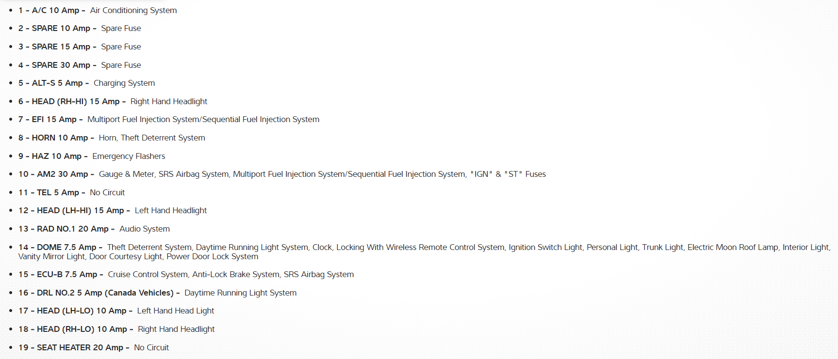

ZACKMAN
  • 4,202 POSTS

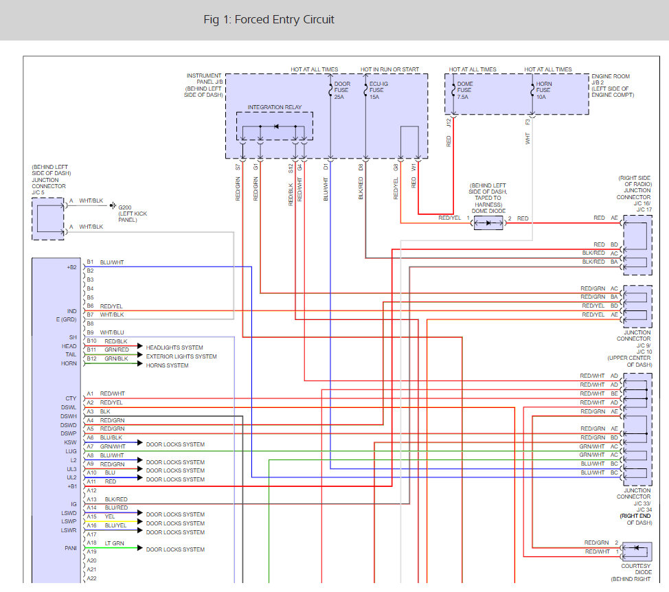

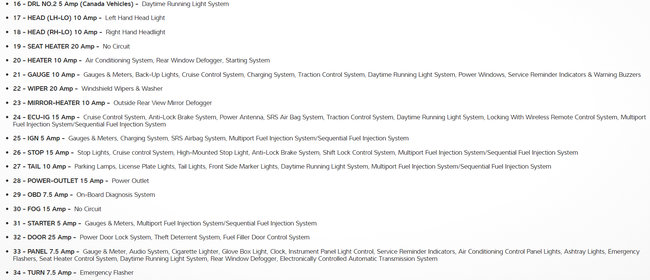

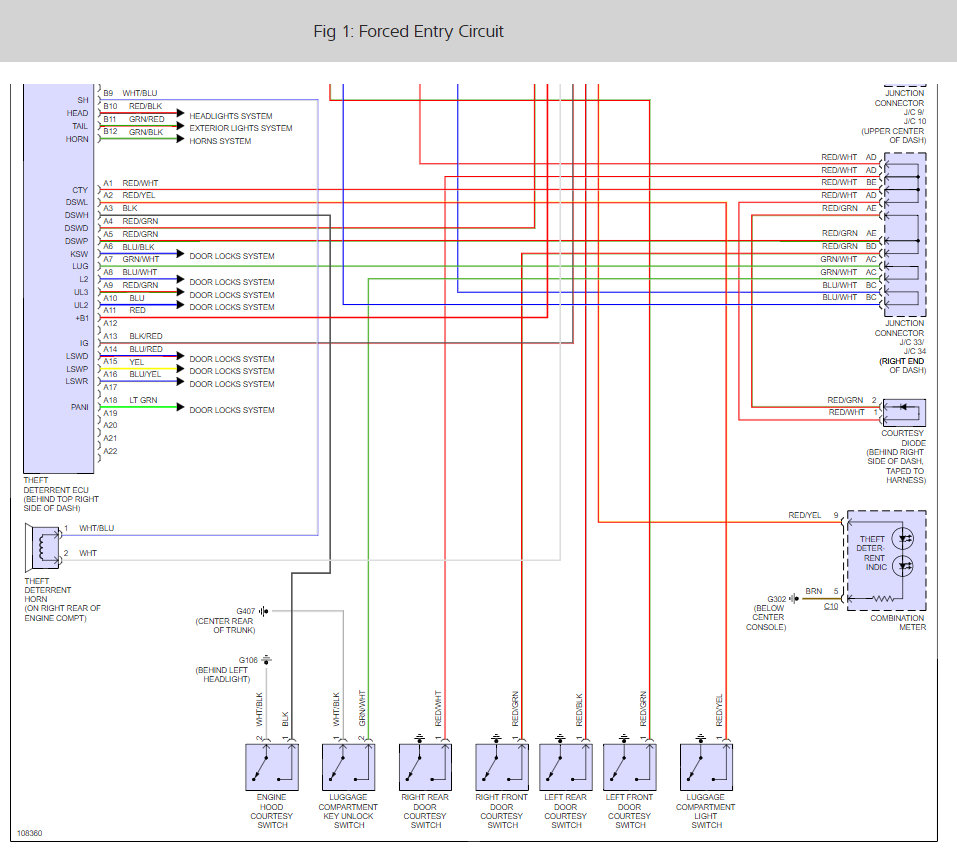

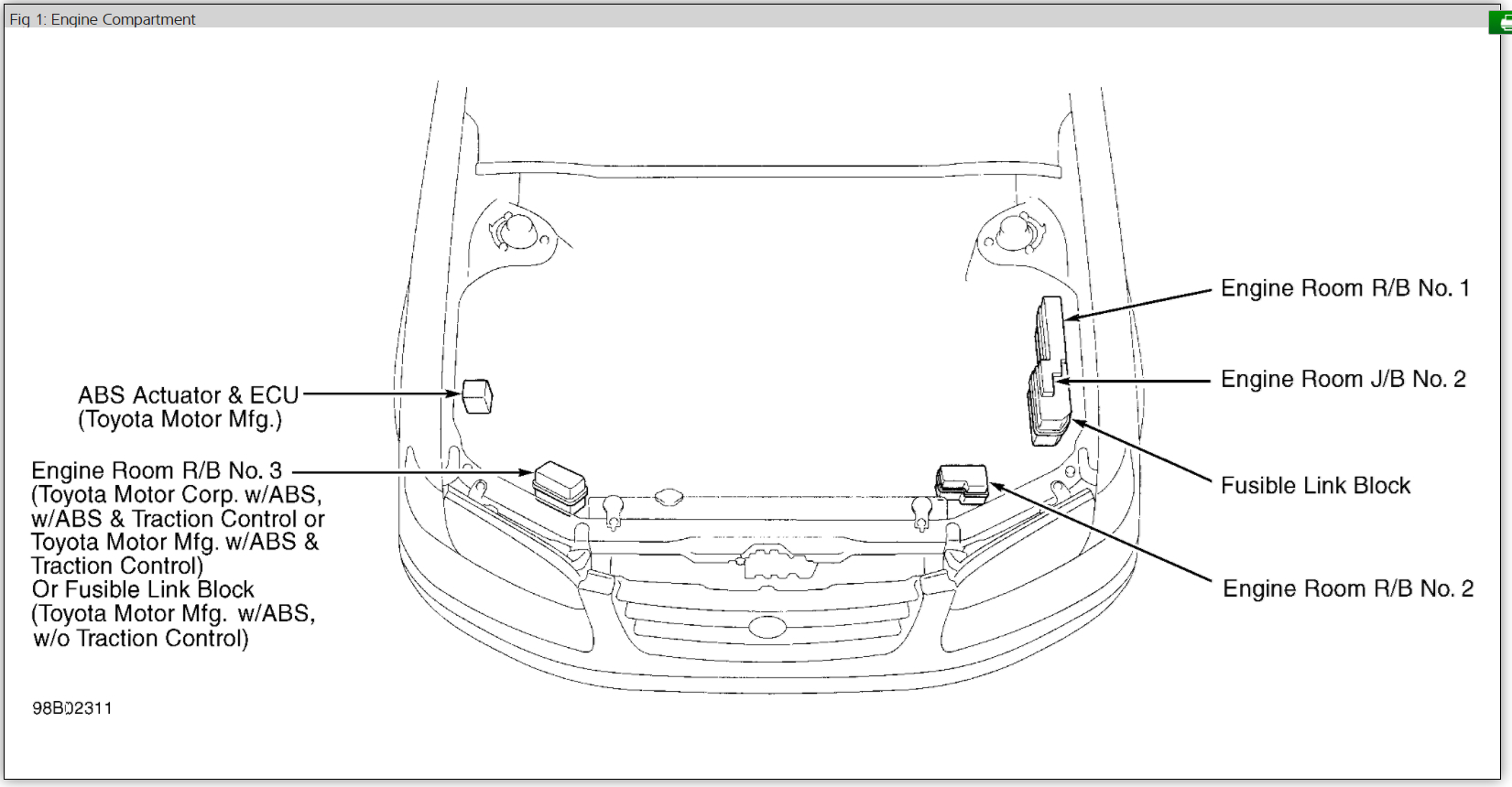

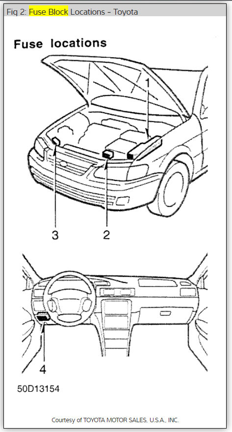

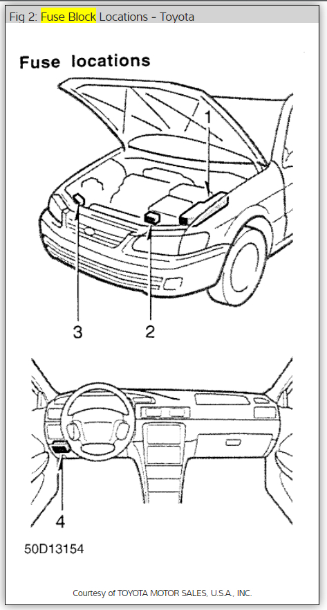

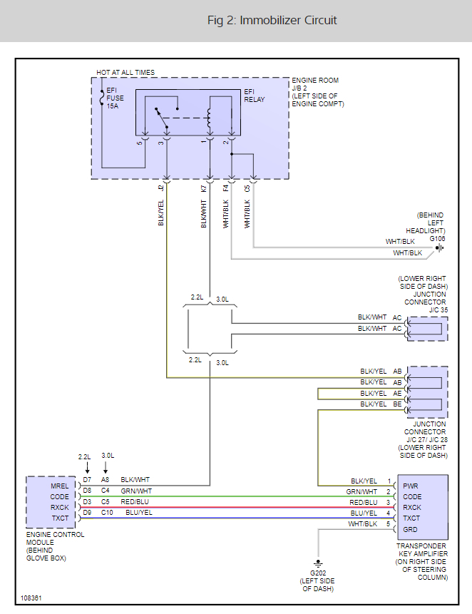

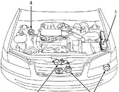

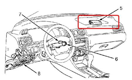

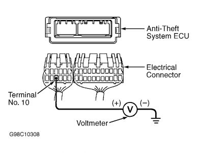

After reading the wiring diagrams for the anti-theft, power door lock, power windows, and keyless entry system, it is inadvisable that you unplug the anti-theft ECU. I believe all operations I have mentioned go through the ECU to work. The diagnostic in the TSB suggests that you check the anti-theft horn (#4l) and its fuse (#1) in the picture. Here is the caveat. You may either pull the fuse or unplug the horn wiring harness. That will be safer than unplugging the ECU.
https://images.2carpros.com/forum/automotive_pictures/55316_99camryalarm1_1.jpg
The alarm ECU and its wiring harnesses.
https://images.2carpros.com/forum/automotive_pictures/55316_99camryalarm_1.jpg
https://images.2carpros.com/forum/automotive_pictures/55316_99camryalarm_2.jpg

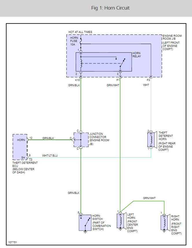

Also, my husband discovered that he could pull the fuse for the horn, and then the alarm connot go off (but then you can't use the horn)
