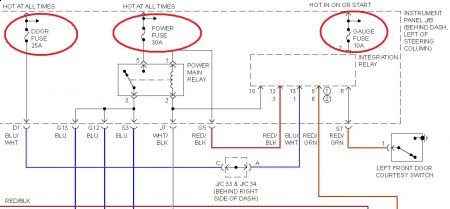

Hello, the power windows, speedometer and tachometer stopped working on my 97 camry during a road trip. Shortly after, my alternator went out. The alternator tested bad and we replaced. However the windows, speedometer and tachometer are still not working. We looked at the fuses and they look fine. What could be the poblem?

Check again. Don't do visual check, use a digital meter and use ohm setting for continuity.
https://images.2carpros.com/forum/automotive_pictures/55316_97camrypw_1.jpg
Gauge fuse is responsible for the tach, speedo, as well as the PW.
