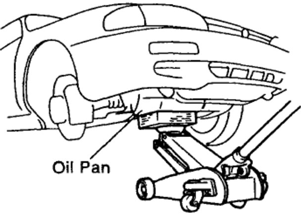

Here is a guide and some diagram (below) That shows the alignment of the crankshaft to the camshaft.
https://www.2carpros.com/diagrams/toyota/camry/1996
You will need to jack the car up
and remove the harmonic balancer
https://www.2carpros.com/articles/how-a-harmonic-balancer-works
The diagrams below will show you how to do the job

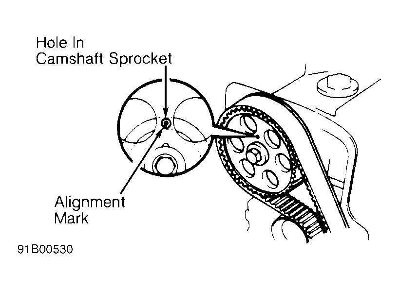

OVERBOOST_CONDITION

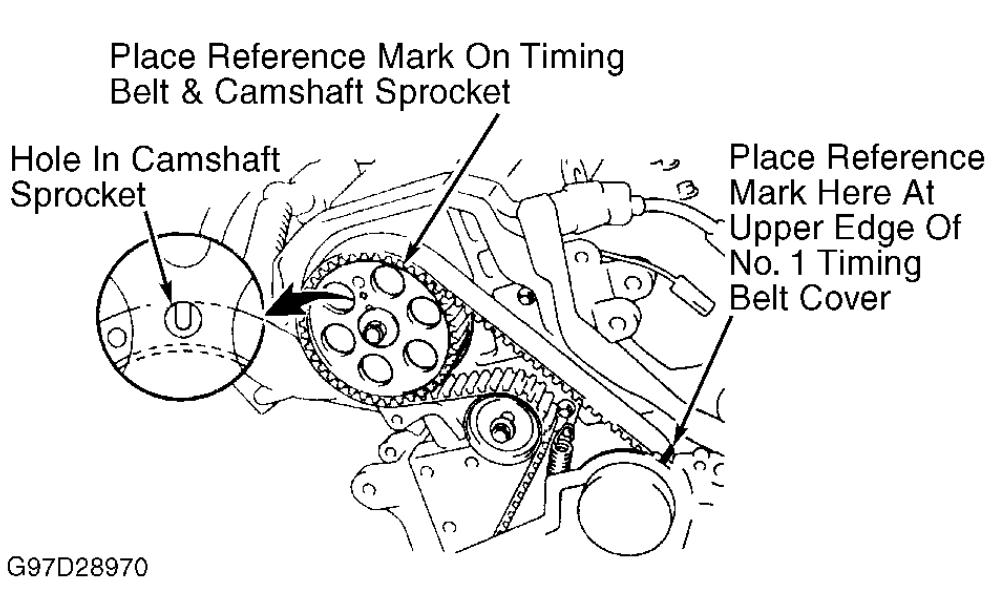

Went to replace timing belt on camry and noticed that there seem to be odd tiiming marks on both the crank and cam. On the Cam gear, there are three marks, two on the teeth which are six teeth apart and then there is a hole in one of the "spokes" on the cam gear. By the camshaft seal there are also two marks; one is a divet and another looks like a drilled hole.
Now on the crank, there is a dot on the pulley and a little mark on the block. I have lined up the gears to what i believe are their respective marks but the engine still will not start. It feels as if there is no compression. I don't believe there are any bent valves, i just believe the crank/cam are not timed correctly......Please help with the timing marks
Jul 27, 2020 at 5:27 AM (Merged)

OVERBOOST_CONDITION
The belt broke, and aligning to TDC will only give me the right mark on the crank, which still leaves finding the correct marks for the cam.

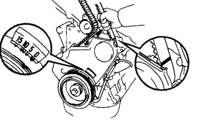

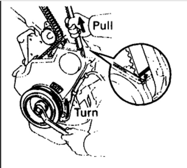

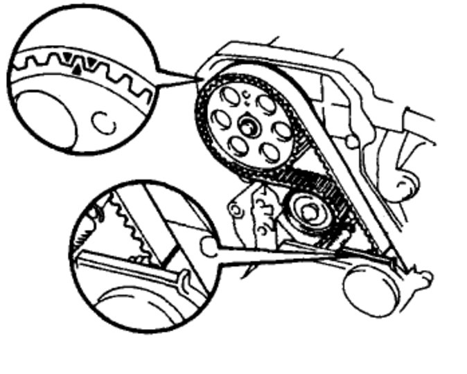

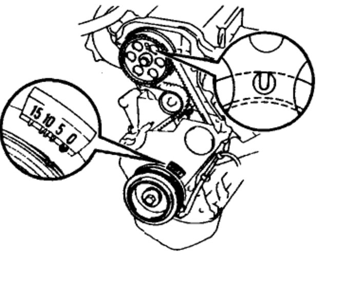

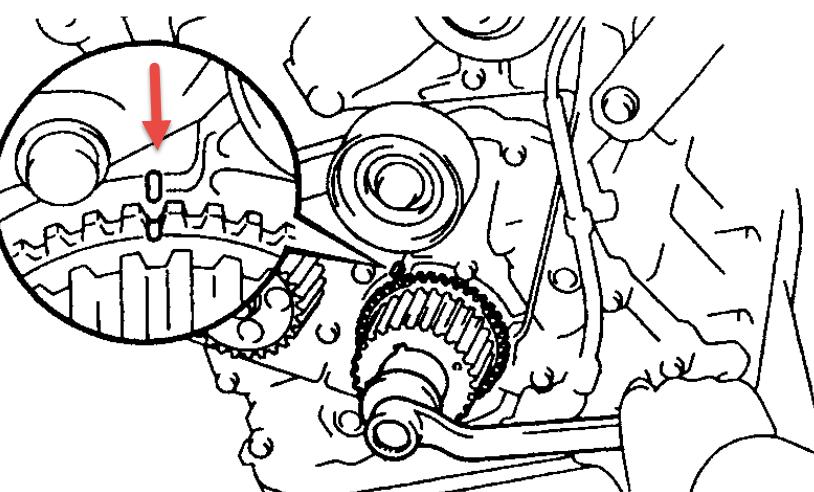

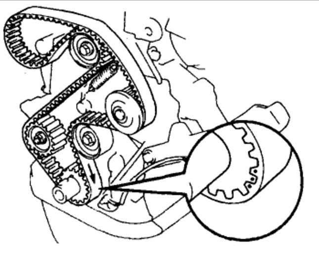

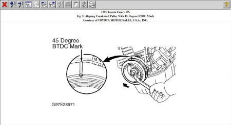

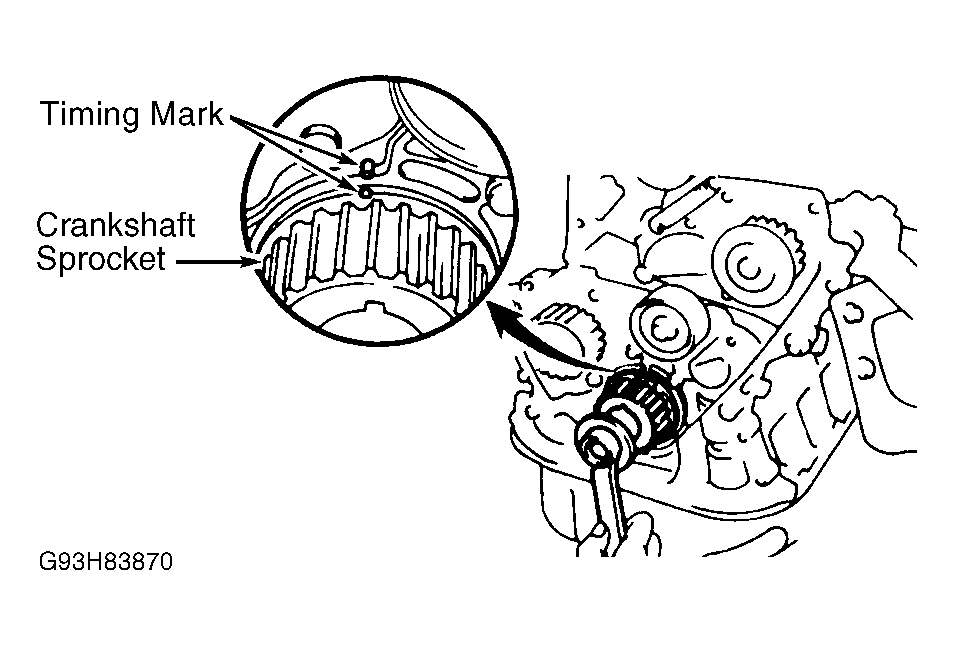

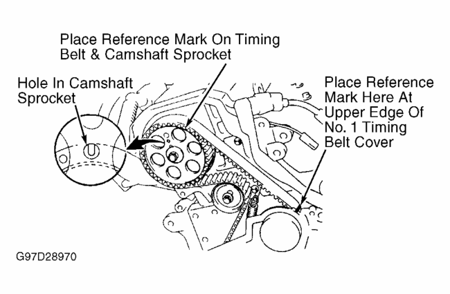

  • 75,988 POSTS
Put engine no.1 piston on its compresssion stroke/TDC-See below
https://images.2carpros.com/forum/automotive_pictures/12900_camry_timing_marks_1.jpg
https://images.2carpros.com/forum/automotive_pictures/12900_camry_crankshaft_alignment_1.jpg
RPONDER
OK, had to put a new head on my 95 Camry LE with a 2.2. The head is set just fine and the car starts but runs very rough and I'm getting a little "pop" and "chug" back through the main air intake while running so the valves have to be slightly off. It's not awful but it's there. I have worn the web and your site out looking for answers. The closest I have come is a thread on Toyota Nation http://www.toyotanation.com/forum/103-3rd-4th-generation-1992-1996-1997-2001/180435-camshft-timing-marks-5sfe.html My cams are lined up exactly as they are in the attached image from that thread. I've been stuck at this point for days and simply have to get the Camry running again. I've looked for pics that would show me cam lobe positions when #1 Cyl is TDC but can't find any. I have of a service manual PDF but it isn't helping. It has to be something simple. I'm not a mechanical moron but this one has me stumped and lack of info isn't helping.

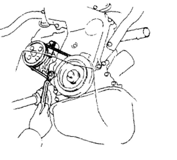

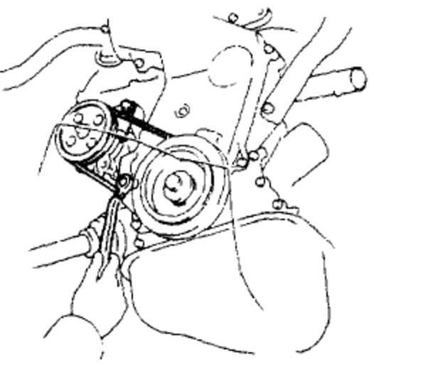

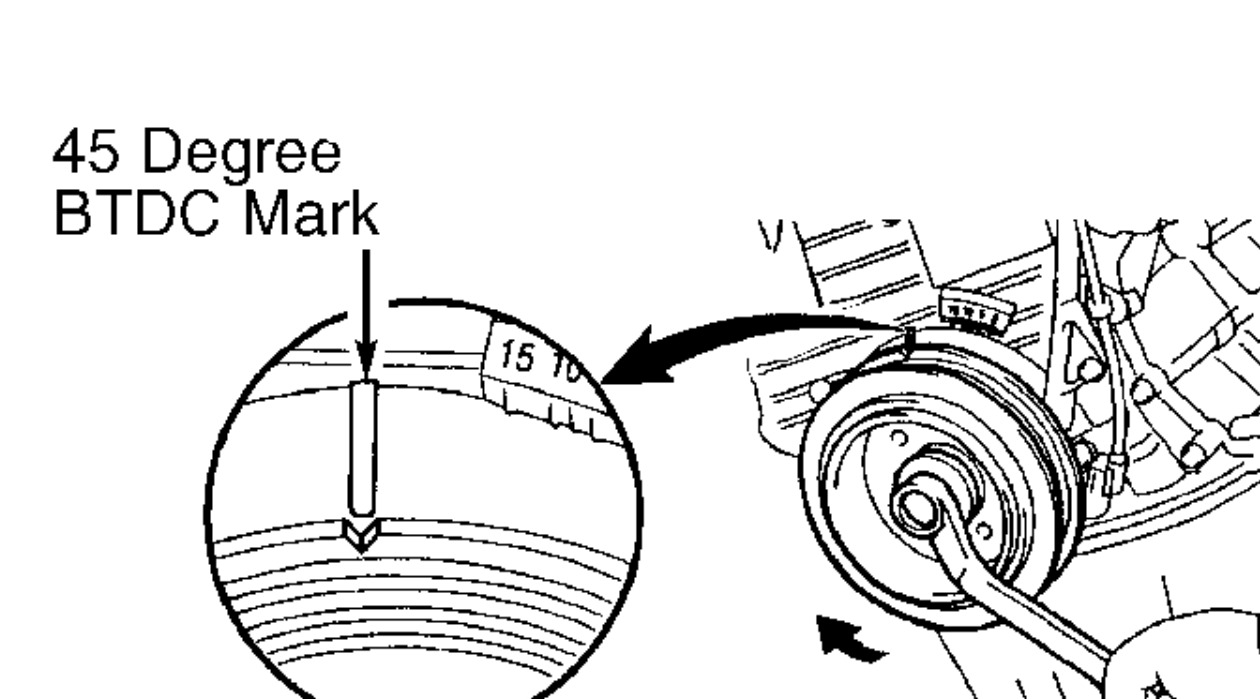

HMAC300
  • 48,601 POSTS
See pictures for locations. Last picture is of timing with crank pulley on valve adjustment is .007-.011 intake and .011-.019 exhaust. That may be your problem as well.

Yes, I have done all of this when lining it up. Those images are easy to find. My concern is with the intake and exhaust cam alignment. The picture I sent is of a 1997 but my 1995 has the same marks. It starts but behaves like the valve timing is slightly off.
RPONDER
The first picture that you sent shows the alignment pip that is on the block and a notch in the gear on the crankshaft. My gear has no notch, only a circular indentation on the face and the key way hole (squarish hole). If there is supposed to be a notch to line with the pip I am not seeing one (just went out and looked again).
HMAC300
  • 48,601 POSTS
Are you replacing the tension spring? It has been revised if not that may be your problem as well as debris in one of the gears. Check for debris the line up mark looks to be even with key way and may not be visible.

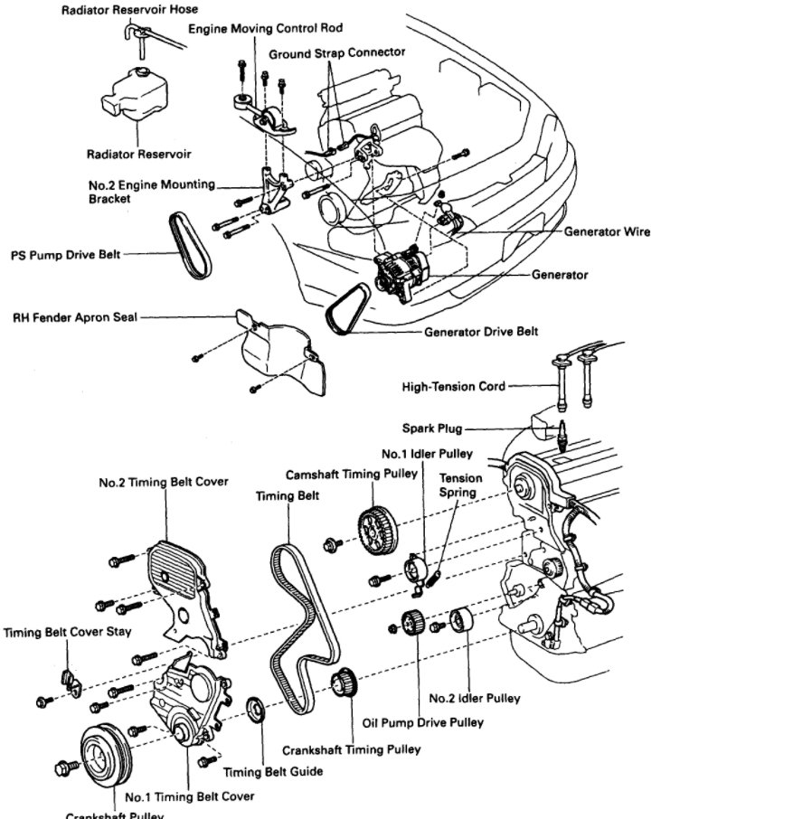

  • 75,988 POSTS
Here is a guide and the diagrams below so you can see how the job is done:
https://www.2carpros.com/diagrams/toyota/camry/1994
Cheers

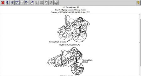

I have three dots on the intake and two on the exhaust. one has two dots and the other is one. which dots do I put together?

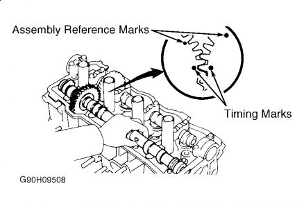

AMIKER
Four cylinder front wheel drive manual 159,000 miles
I am trying to find out which dots to line up on camshafts gears on cam shafts. If someone could point me to a picture would be great. I had the cam shafts out to replace head gasket I never noticed the gears had more than one dot on gears.
I am talking about the two gears on the camshafts under the valve cover this is a 2.2 liter with duel cams there are dots on both gears not sure which dots to line up. This is a 5S-FE engine.

BMRFIXIT
  • 19,053 POSTS
Hello, Check this page: https://www.2carpros.com/diagrams/toyota/camry/1994 And here is the diagram you are looking for:
https://images.2carpros.com/forum/automotive_pictures/99387_Graphic1_449.jpg
Please let us know if you need anything else to get the problem fixed. Cheers,

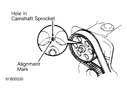

MHPAUTOS
  • 31,937 POSTS
Hi there,
Set crankshaft at TDC (top dead centre) that's the "0" on the timing cover aligned with the notch on the front pulley. Align the cam by placing the small hole towards 12 O' Clock so that with a mirror and light you can view the notch on the front cam pedestal, it is a bit tricky if you have never located it before, but go slowly and you will See it.
Mark (mhpautos)
Jul 27, 2020 at 5:28 AM (Merged)

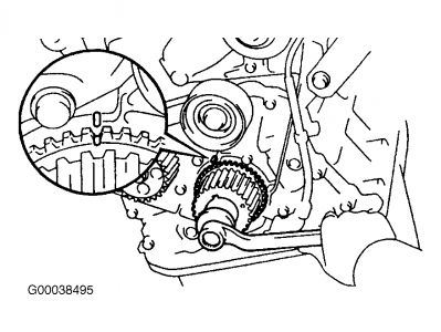

BMRFIXIT
  • 19,053 POSTS
https://images.2carpros.com/forum/automotive_pictures/99387_toyota_1.jpg
https://images.2carpros.com/forum/automotive_pictures/99387_toyo_1.jpg

MHPAUTOS
  • 31,937 POSTS
Hi there, ensure valve timing is correct first.
https://images.2carpros.com/forum/automotive_pictures/61395_celica_1_2.jpg
https://images.2carpros.com/forum/automotive_pictures/61395_celica_2.jpg

2CP-ARCHIVES
  • 4,540 POSTS
what dots do i align when refitting cams to heads 1 dot or doble dot
