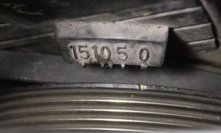

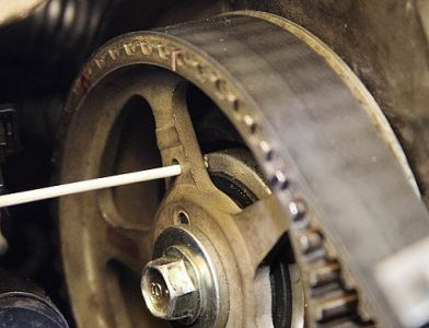

The reference marks that I have are lining up.
Here is the Upper Cam and the lower Zero mark on the Crankshaft Pulley lining up:
https://www.2carpros.com/forum/automotive_pictures/298324_campullypointer_1.jpg
https://www.2carpros.com/forum/automotive_pictures/298324_zeromarker_1.jpg
Do I have to remove the whole bottom assemble to see if the crankshaft Sprocket is lined up? I thought that the zero mark "0" on the lower timing belt cover indicated that the crankshaft was at Bottom Dead Center.
I have tried moving the alignment of the upper camshaft a few teeth before and a few teeth after to see if it would start but it would not.
When I did the spark test and there was an open spark plug hole, it looked like gas vapor was sprayed out of it - if it was then it was getting gas. I am not sure if this information is relevant to the starting problem, but I also noticed on the spark plug that I tested that it was being covered with black - I had sanded them before reinstalling them after the head gasket job, but during this time of trying to start the engine black stuff coated the plug.
-1
Friday, January 9th, 2009 AT 2:04 PM

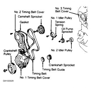

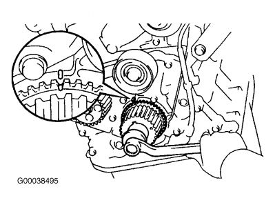

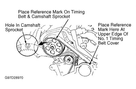

You are getting fuel and spark .. you are quite correct your marks are lined up ... but once they are lined up .. before you totally tighten #1 idler pulley to spec .. crank needs to be set @ 45 degree BTDC mark on #1 timing belt cover .. explained below .. so the timing is slightly out on crank ... changeing it @ cam will be pot luck at getting it right .. but i applaud you for your setting skills ..let me know if you need any of the other diagrams !!
https://www.2carpros.com/forum/automotive_pictures/266999_45_1.jpg
Installation
Install No. 2 idler pulley (if removed). Install and tighten bolt to specification. See TORQUE SPECIFICATIONS . Ensure idler pulley is clean and rotates smoothly.
Install No. 1 idler pulley and tension spring (if removed). Pry No. 1 idler pulley away from timing belt area as far as possible. Temporarily tighten No. 1 idler pulley bolt. Ensure idler pulley is clean and rotates smoothly.
Using crankshaft pulley bolt, rotate crankshaft so timing mark on crankshaft sprocket aligns with timing mark on oil pump housing. See Fig. 4 . This will position keyway in crankshaft sprocket at 12 o'clock position.
CAUTION:If reusing timing belt, ensure reference marks on timing belt align with reference marks placed on crankshaft and camshaft sprockets. Ensure timing belt is installed in original direction of rotation.
Ensure all sprockets and idler pulleys are clean. Install timing belt on crankshaft sprocket, oil pump sprocket, No. 1 idler pulley, and then No. 2 idler pulley in sequence.
Install timing belt guide with cupped side away from crankshaft sprocket and flat side toward timing belt. Install No. 1 timing belt cover and new gasket.
Align crankshaft pulley key groove with key in crankshaft. Install crankshaft pulley. Install and tighten crankshaft pulley bolt to specification.
Rotate crankshaft clockwise so cylinder No. 1 is at TDC on compression stroke. Ensure timing mark on crankshaft pulley aligns with "0" mark on No. 1 timing belt cover. If reusing timing belt, ensure reference mark on timing belt aligns with upper edge of No. 1 timing belt cover.
Rotate camshaft, and align hole in camshaft sprocket with alignment mark on camshaft bearing cap. See Fig. 2 . Install timing belt on camshaft sprocket. If reusing timing belt, ensure reference mark on timing belt aligns with the reference mark on camshaft sprocket. Ensure tension exists on timing belt between the crankshaft and camshaft sprockets.
CAUTION:DO NOT rotate crankshaft counterclockwise, as viewed from timing belt end of engine.
Loosen No. 1 idler pulley bolt 1/2 turn. Rotate crankshaft pulley 2 full revolutions clockwise from TDC to TDC.
Ensure timing mark on crankshaft pulley aligns with "0" mark on No. 1 timing belt cover, and hole in camshaft sprocket aligns with alignment mark on camshaft bearing cap. See Fig. 2 . If timing marks are not aligned, remove timing belt and reinstall.
Rotate crankshaft clockwise 1 and 7/8 revolutions and align crankshaft pulley "0" mark with 45-degree Before Top Dead Center (BTDC) mark on No. 1 timing belt cover. See Fig. 5 .
Tighten No. 1 idler pulley bolt to specification. See TORQUE SPECIFICATIONS . Install No. 2 timing belt cover and gaskets. Install and tighten spark plugs to specification.
To install remaining components, reverse removal procedure. Install all bolts/nuts on right (timing belt side) engine mount before tightening to specification.
On Camry, when installing control rod and bracket on strut tower and right (timing belt side engine mount, tighten bolts to specification in sequence. See Fig. 6 . On MR2, tighten engine mount bolts in correct locations. See Fig. 7 . Adjust drive belts to proper tension.
Friday, January 9th, 2009 AT 2:53 PM

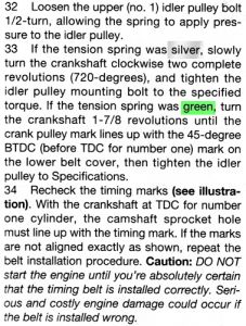

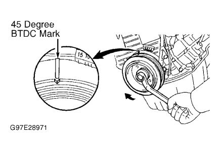

I followed the procedure and it sounded like it wanted to start for the first second but then it cranked as if there was no spark (sound wise).
I also found this in my manual:
https://www.2carpros.com/forum/automotive_pictures/298324_SilverGreen_1.jpg
My spring was silver, but I basically did that procedure before and no start.
So, what do we do next?

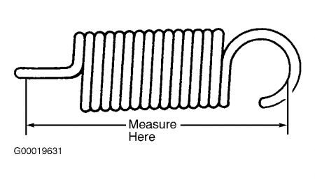

Can you manually line up the cam timing marks and let me know where the crank timing mark is now ?? is it @45 degree ..@ "0" or is it way out ... does the belt feel tight .. ?? also do you have access to a compression tester ?? and you mentioned the plug you pulled was black covered .. was this an oil wet black or like a coal dusty blackness ?? let me know

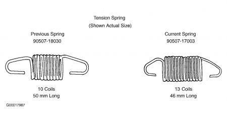

NOTE:For 1992-96 Camry, the timing belt tension spring procedure has been revised. See REVISED TIMING BELT TENSION SPRING PROCEDURE (1992-96 CAMRY) .
Revised Timing Belt Tension Spring Procedure (1992-96 Camry)
From Toyota technical service bulletin EG001-99; January 29, 1999: For 1992-96 Camry, the timing belt tension spring procedure was revised. When replacing the timing belt on 1992-96 Camry with 2.2L, tension spring MUST be replaced. The revised tension spring 0 (Part No. 905-7-17003) is a 13-coil design which replaces the original 10-coil design.
spring Free Length
Except 1999-00 Camry......1.811" (46.00 mm)
https://www.2carpros.com/forum/automotive_pictures/266999_spring_1.jpg

The spring was a ten coil - do I need to get a 13 coil one?
What should we do next.
+1
Saturday, January 10th, 2009 AT 1:12 PM
DAVE H
  • 13,384 POSTS
Yes we need to replace the spring for the 13 coil type .. the newer type is shorter so I don't think we are getting the correct adjustment when setting @45 degree BTDC
5S-FE - REVISED TIMING BELT TENSION SPRING
TECHNICAL SERVICE BULLETIN
Reference Number(s): EG001-99, Date of Issue: January 29, 1999
Related Ref Number(s): EG001-99
ARTICLE BEGINNING
Model(s): 1992-1996 Toyota Camry 5S-FE
Section: Engine
Bulletin No.: EG001-99
Date: January 29, 1999
INTRODUCTION
The service replacement Timing Belt for the 5S-FE Engine has been revised. To insure that this belt fits properly, the Timing Belt and Timing Belt Tensioner Spring must be replaced as a set.
AFFECTED VEHICLES
1992-1996 Camry with 5S-FE Engines
PARTS INFORMATION
Refer to Fig. 1 .
PARTS INFORMATION
Previous Part NumberCurrent Part NumberPart Name
90507-1803090507-17003Tension Spring
13568-0904013568-09041Timing Belt
REPAIR PROCEDURE
Replace Tension Spring with revised part when replacing Timing Belt.
https://www.2carpros.com/forum/automotive_pictures/266999_springs_1.jpg
+2
Saturday, January 10th, 2009 AT 1:34 PM
DIY-DUD
  • 12 POSTS
I installed the new 13 coil spring, took it back to 45 degrees BTDC (to the left of zero) and tried to start it. It sounded like it wanted to start the first second but after that it just turned.

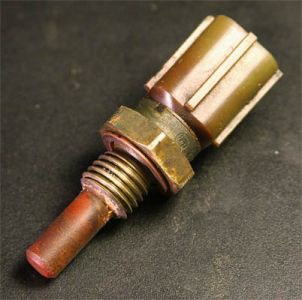

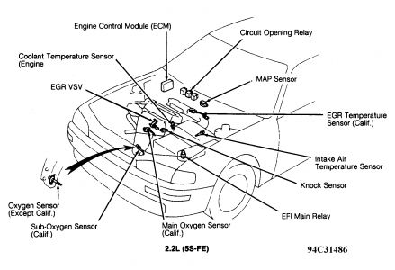

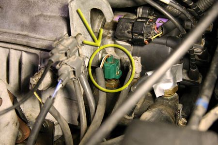

In doing some research I came across this component called a Cold Start Injector Time Switch that might be causing the problem, what do you think?
I am not sure where this is located on my car, but I think that I have located it correctly. Please see the following images to see if this is correct.
https://www.2carpros.com/forum/automotive_pictures/298324_CSITWLocation_1.jpg
https://www.2carpros.com/forum/automotive_pictures/298324_ColdStartInjectorTimeSwitch_1.jpg
Is this the Cold Start Injector Time Switch or is this the water/coolant temp sensor or are they one in the same?
During disassembly, to get to the head gasket, the instructions that I was following, on step 15, said:
"Disconnect the water temperature sender gauge connector, water temperature sensor connector, cold start injector time switch connector, upper radiator hose, water hoses, and the emission control vacuum hoses. Unbolt and remove the water outlet and gaskets."
At the time, I was unable to identify the cold start injector time switch.
If you think this could be the problem how do I test to see if this is the problem. From what I was reading this is supposed to be a very expensive item. I can not afford to replace something may not be the problem. Is there a way to cross the wires to trick the car's computer into thinking that the car is cold etc...
What should we try next?

Your compression is almost half what it should be .. even with a well used engine your almost 50 psi out on the minimum required ... why was you changeing the headgasket ? did the car car have a major cut out ?? the sensor in your pic is of the ECT engine coolant temp sensor see diagram below ... let me know

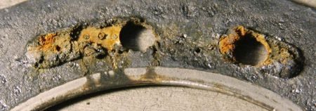

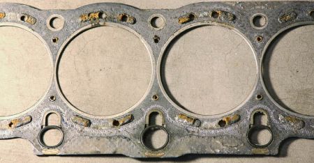

As to the reason for the original head gasket job:
For a long time there was excessive pressure in the cooling system, to the point that it blew a few radiators. Eventually, over a short period of time, there began to be coolant in the oil and burnt oily built up in the coolant that was coating the walls of the cooling system with brown clumpy/slimy build up.
The gasket looked pretty worn. The car is a wagon and the previous owner said that he drove it across many states. It also had a hitch for a trailer, so it may have been pulling a load.
Here is the old gasket:
https://www.2carpros.com/forum/automotive_pictures/298324_HeadGasket_1.jpg
https://www.2carpros.com/forum/automotive_pictures/298324_HeadGasketCloseUp_1.jpg
Well, whats next.

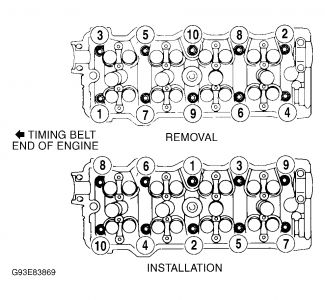

When you had the head milled & cleaned..did they pressure test at the same time .. i would expect them too, but i have never had one done here in the USA, in england they do it as standard ? also you seem have done a fantastic job this being your first headgasket, so please do not take offence when i ask this ... you did torque the head down correctly ..? ..the reason i'm askin is we seem to have compression loss of the same amount on all 4 cylinders .. if the head was cracked or warped, i would expect at least one/two of them to be showing close to normal psi .. and the others showing low .. this engine has a leak somewhere on all 4 .. do you see where i'm coming from ?? you said you could at least get it running before .. was it a real sruggle to start it, then it ran real rough ?? let me know !!
Cylinder Head Bolt
Step 1..............................Ft.Lbs 36 (49)Nm
Step 2..............................Additional 90 Degrees
https://www.2carpros.com/forum/automotive_pictures/266999_head_4.jpg

I wasn't sure if the shop that milled the head checked the pressure, so I called and asked but they said that if I did no pay for it they did not do it. He advised me to put some oil in the cylinders just in case the piston rings were "fuel washed." I did this and pressure tested one of the cylinders and it shot up to 160 psi. I put the plugs back in and tried to start it, but no start. I then pressure tested all the cylinders and there were at about 112 psi but #3 was at about 102 psi.
When I did the head gasket job, I did get a torque wrench and tightened them to specification in the order given and I did do that last 90 deg. Turn on each bolt.
As far as starting the car before, It wasn't a struggle to start but it did start rough if it was cold, but after it warmed up it ran much smoother. One of its behaviors though was that at a stop light it would begin to shake a little, so I would put it in park and give it a little gas which would reduce the shake and then when the light turned green I would put it in gear and go.
I did notice that during the winter, the car would have trouble shifting up to the last gear no mater how fast I would go. Only when it got warmed up, would it shift correctly, but this would be an automatic transmission issue right?
Friday, January 16th, 2009 AT 2:47 PM
DAVE H
  • 13,384 POSTS
Thanks for the welcome. It could be the head is cracked/warped, as I said previously it should be checked when milled/cleaned? But it could also be, and I'm not happy saying this too you because of all the good work you put in ! But I'm now thinking after you first installed the gasket and set the timing. It was out. And when you cranked it over it has bent the valves. The only way we can check this is to remove the head again? It would have to be valves in every cylinder. Because the compression loss is across the 4 cylinders. If there are no valves bent then we have to be looking at the head being bad. And we need to have it pressure tested off the vehicle. Again this would have to be a major crack or warp to be across all 4 cylinders. I know this is a major step to take. But I don't see what else we can check without taking the head off? Let me know?
Ohh and the late shifting is trans issue and we can get to that later?
Friday, January 16th, 2009 AT 8:50 PM
DIY-DUD
  • 12 POSTS
It is my understanding that this engine is non-interference, meaning that the pistons would never hit the valves even if the timing were out.
What happens if you turn the crank counter clockwise for about 20 degrees - I did do that and then read you should not do that.
I will look into the pressure test. Please let me know of any other ideas you may have.
