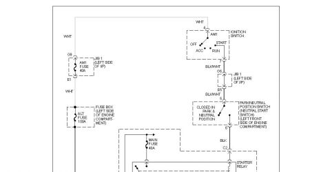

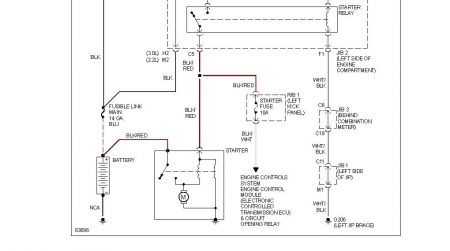

1994 Toyota Camry 4 cyl 178564 miles
My car starts sometimes, but sometimes it just doesn't do anything. The lights come on, as well as the radio and the power windows still go up and down. Of course, when I take it somewhere to have it looked at, it cranks everytime. Can you help?
Wednesday, October 22nd, 2008 AT 3:16 PM
  • 75,992 POSTS
Hi kingdomofcults and welcome to 2carpros
Get the battery, alternator, and voltage drop test on the battery cables checked out-If okay the problem could be the ignition switch, park and neutral switch or the clutch switch if its a manual transmission, starter relay and starter itself
See below EWD of the start circuit
https://www.2carpros.com/forum/automotive_pictures/12900_toy1_1.jpg
https://www.2carpros.com/forum/automotive_pictures/12900_toy2_1.jpg
