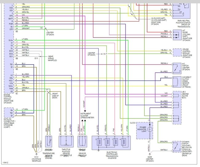

I have a 1997 Toyota Avalon XLS, Miles are 155,239.
I had the engine check light come on and had it checked by a friend who had a meter who works at a Toyota dealership- it showed that I had a faulty transmission shift solenoid.
How do I go about replacing this?

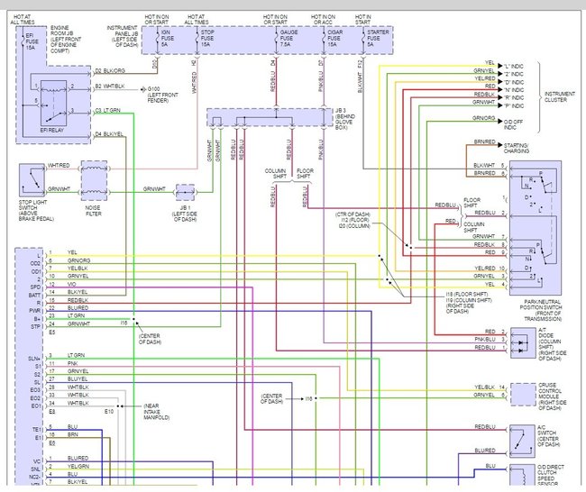

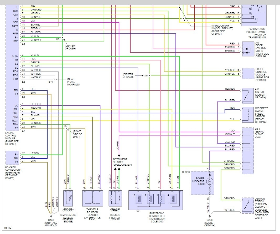

Here is a guide and a diagram on how to fix the problem. You must remove the transmission pan
The shift solenoid is internal to the transmission. You have to know which one. Here is a wiring diagram that shows which one to replace.

Suggested Repair
Remove the transmission pan to access the internal shift solenoid. Identify the specific faulty solenoid from the wiring diagram, then replace that solenoid.
Conversation Summary
The owner of a 1997 Toyota Avalon XLS with 155,239 miles had a check engine light. A dealership employee checked it and reported a faulty transmission shift solenoid. The expert said the solenoid is inside the transmission, so the pan must be removed and the correct solenoid identified from the wiring diagram before replacement.
