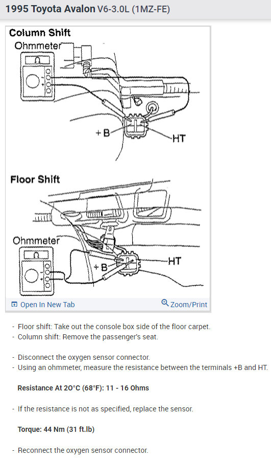

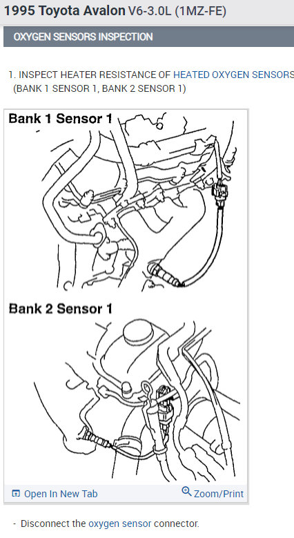

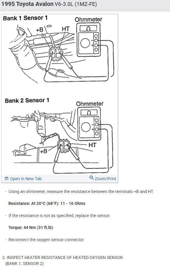

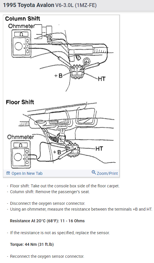

What are the torque specs for the upstream and downstream oxygen sensors?
Aug 21, 2021 at 6:10 AM
SQM
  • CAR REPAIR CONTRIBUTOR
  • 6,383 POSTS
The torque specs on the oxygen sensors:
Sensor torque : 44 Nm (31 ft.lb)
https://www.2carpros.com/articles/how-to-replace-an-oxygen-sensor
Let me know of any questions.

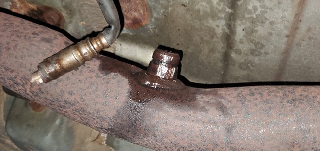

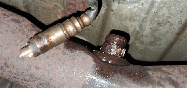

Thank you very much for all the info you supplied. I'm having a major dilemma removing the downstream oxygen sensor. After repeated attempts to remove it with an oxygen sensor tool/wrench, it became totally rounded off and is extremely seized as well. Attached are pictures of its current condition. Can you recommend any strategy or method to successfully remove the O2 sensor?
Thank you!

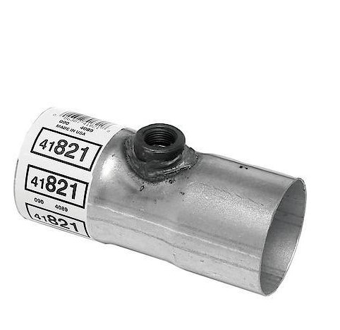

Have you tried to heat up the pipe and use a vice grip to loosen it?
That might be the last option besides cutting the pipe off on both side of the oxygen sensor port and install a new adapter (see picture for reference).

I have tried a vice grip and a pipe wrench, but it didn't work out. Applying heat is going to be my next attempt. Would applying heat make a major impact in removing the O2 sensor?

Applying heat is about the last option if you were to remove. Just be careful when you attempt that. And you want to heat up the pipe and the thread on the pipe, not the O2 sensor that is left in there.

Not very long. It will depend on how you are applying. If you are using a torch it will require much less time than a lighter. Idea is that you want to heat up the surface enough to remove the plug. First try applying for several seconds then try to remove it. Often taping the surrounding area with a hammer can loosen the thread do to vibration.
Here is a helpful video:
