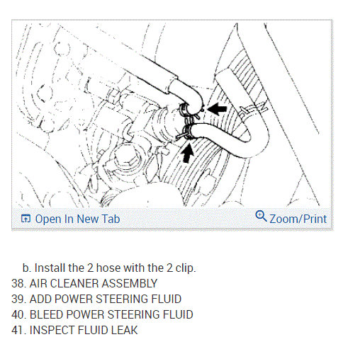

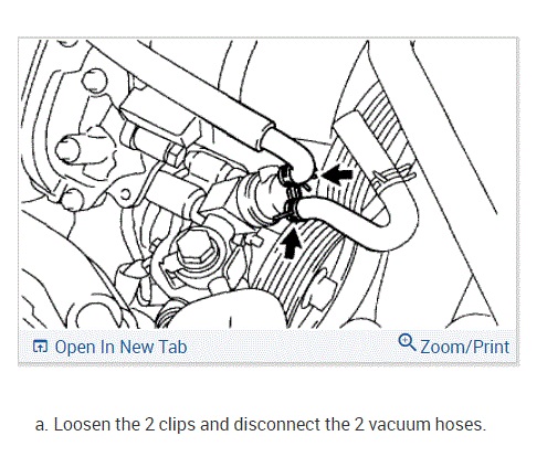

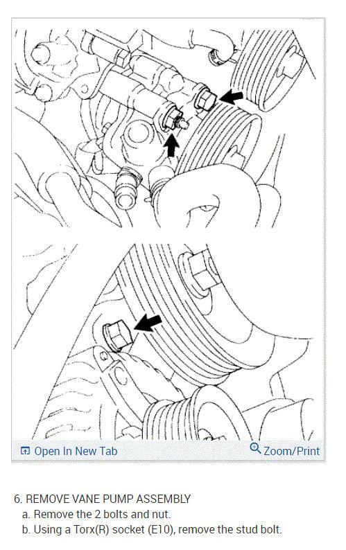

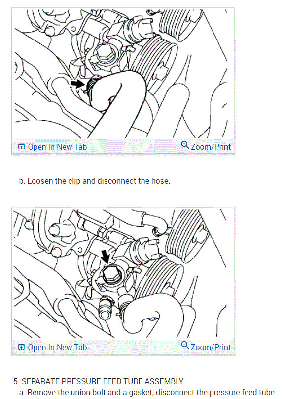

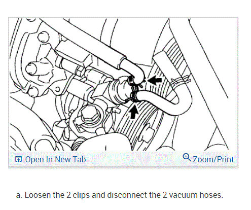

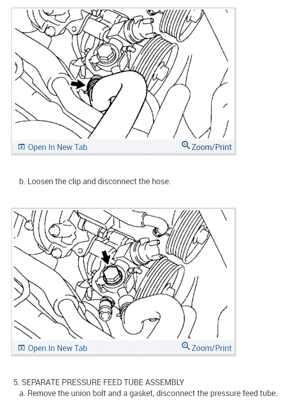

I recently had a service performed at a Toyota dealership near my home. They recommended that I also should have the following done: power steering pump replacement
Jul 15, 2008 at 6:39 AM
  • 110,240 POSTS

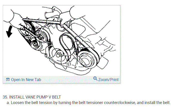

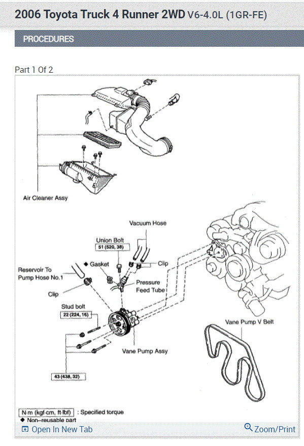

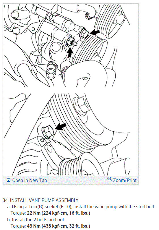

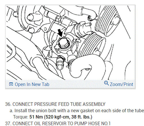

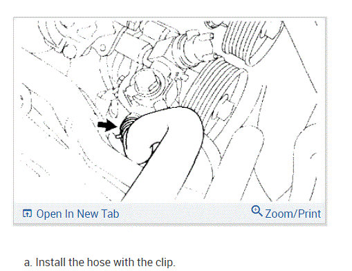

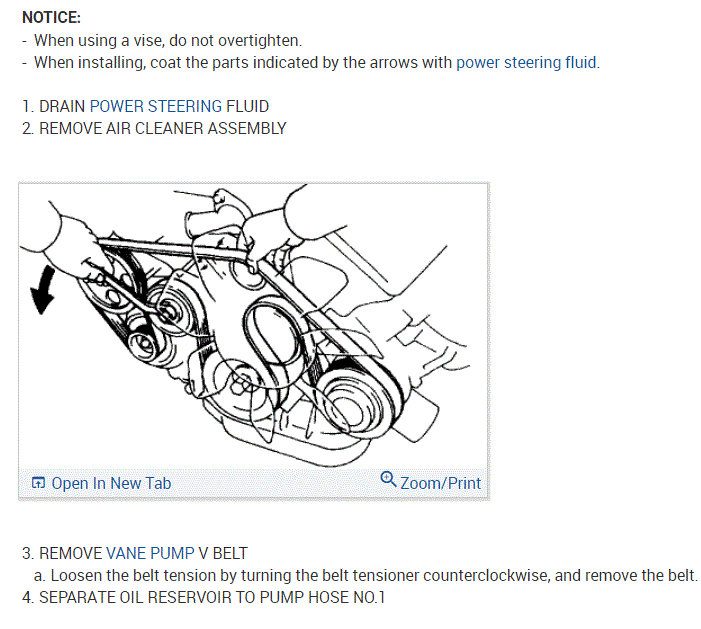

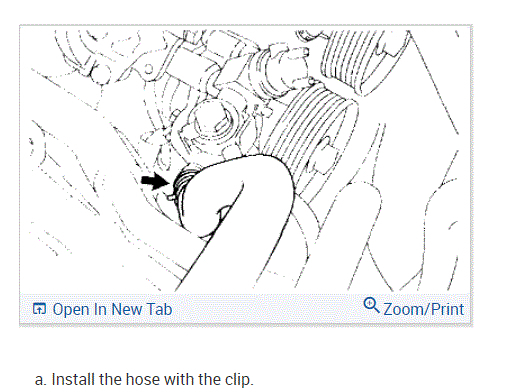

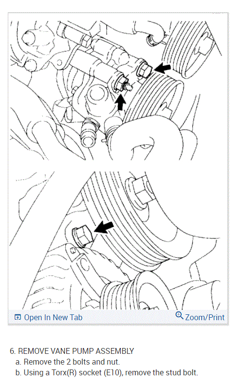

replacing the power steering pump isn't too hard of a job, but it will take a little time.
To get you started, here is a link that shows in general how it is done. You can use this to help guide you when doing the repair.
https://www.2carpros.com/articles/how-to-replace-a-power-steering-pump
If you look at the attachments below, they include the directions and pictures specific to your vehicle for the pump replacement.
