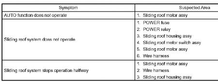

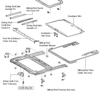

You need to dissemsemble to find out what is happening. The good news is that the parts are available individually.
https://images.2carpros.com/forum/automotive_pictures/30961_slide_1.jpg
https://images.2carpros.com/forum/automotive_pictures/30961_slide1_1.jpg
Maybe it is just a matter of resetting it into the tracks...

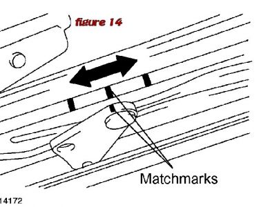

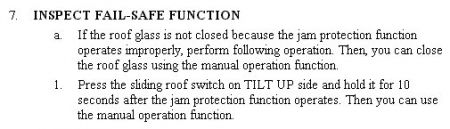

I think it is a mechanical binding on the driver's side. Maybe the cable is disconnected or the track is no longer connected to the roof.. IF this procedure doesn't work, it may confirm that:
https://images.2carpros.com/forum/automotive_pictures/30961_slide2_1.jpg
IT looks like one motor.

Thanks. I got the manual close operation to function. It closed the roof to within an inch of being completely shut before it couldnt move it any further. It seems to not have enough power to get it all the way closed. I re-opened it and it did the same thing as before, opening all the way and then clicking. To close, I had to activate manual again since the auto function still just inched it forward and then reversed.
Sounds to me like the track is either broken or off track. I guess I'll have to pull it apart. Have you ever done that? Is it relatively easy?

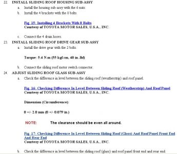

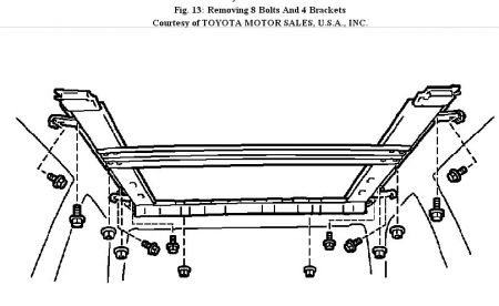

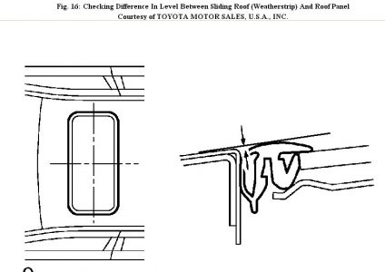

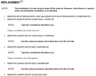

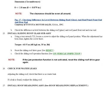

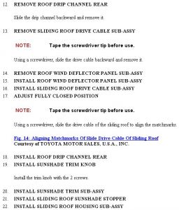

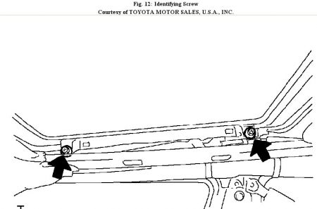

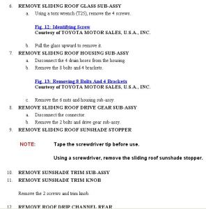

I haven't had the pleasure...but this should help:
https://images.2carpros.com/forum/automotive_pictures/30961_toyrep1_1.jpg
https://images.2carpros.com/forum/automotive_pictures/30961_toyrep2_1.jpg
https://images.2carpros.com/forum/automotive_pictures/30961_toyrep3_1.jpg
https://images.2carpros.com/forum/automotive_pictures/30961_toyrep4_1.jpg
https://images.2carpros.com/forum/automotive_pictures/30961_toyrep5_1.jpg
https://images.2carpros.com/forum/automotive_pictures/30961_toyfig12_1.jpg
https://images.2carpros.com/forum/automotive_pictures/30961_toyfig13_1.jpg
https://images.2carpros.com/forum/automotive_pictures/30961_toyfig14_1.jpg
https://images.2carpros.com/forum/automotive_pictures/30961_toyfig16_1.jpg
Sep 8, 2008 at 1:36 PM
