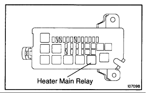

my fan blower for my fan and air conditioner wont go off. i can turn it from low up to high speed but when I turn it off it stays on both on fan and when I push in the air conditioner. How do I get it to go off? first time this has ever happened. Just purchased the car about a month ago. Any help would be appreciated - thank you

Check the blower motor relay could be sticking

is that somehting that I can check ( A GIRL WITH NO CAR KNOWLEDGE or do I need to take it to a repair shop - would it be costly?

Find the relay in the relay box, remove it and see what happens and also there's another one on the blower unit high speed relay
https://images.2carpros.com/forum/automotive_pictures/12900_ht1_1.gif

I opened up the hood of the car and took the lid off of the panel you had displayed for me. i take it the one i am suppose to take off is the marked heater. I tried to pull it out but it wouldn't come. I was afraid to try and force it to because i didn't know it that would break something? and also where is the blower unit high speed relay located that i need to check - thanks pam

The high speed relay is behind the right side of dash sorry no pic for location
