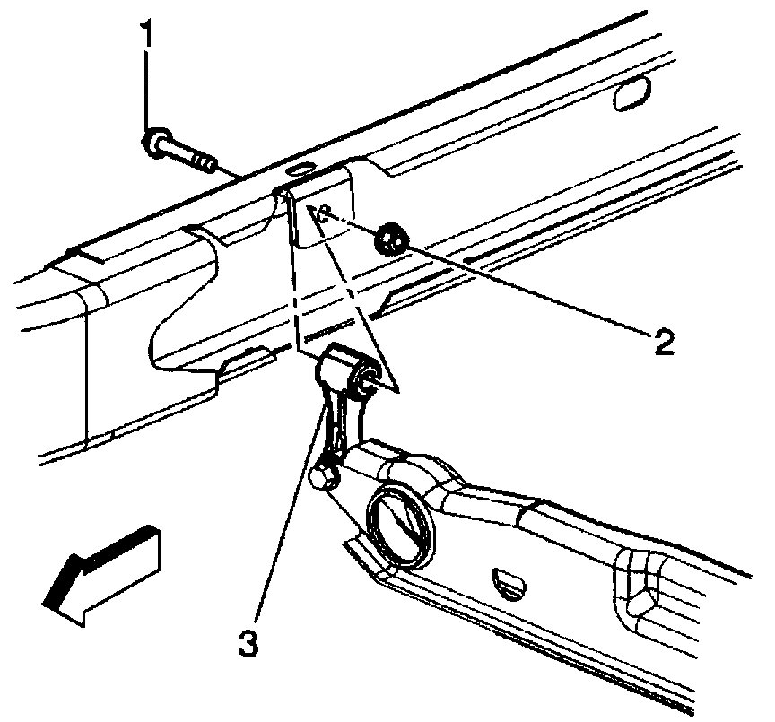

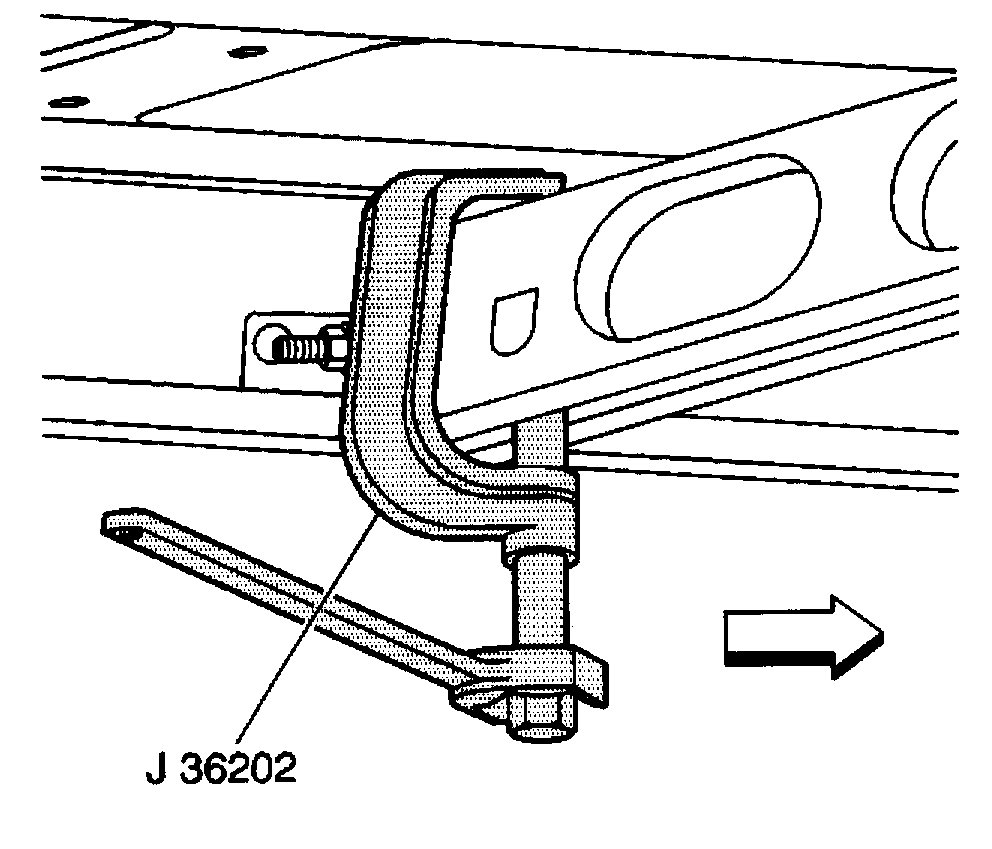

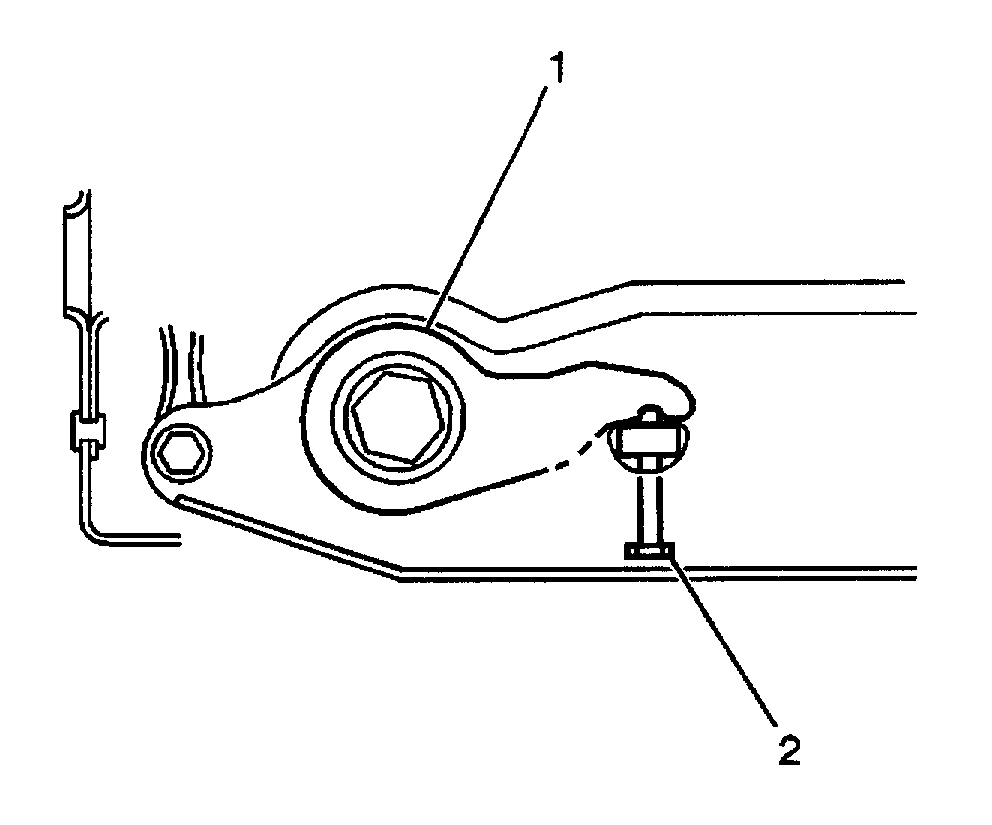

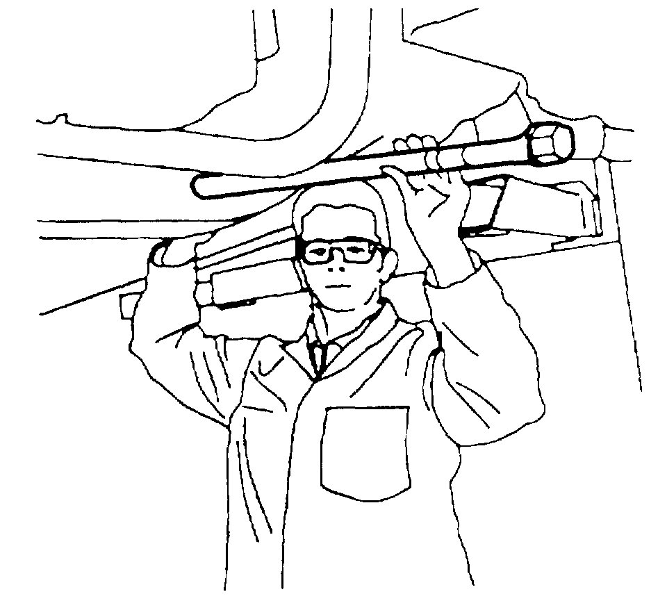

I've recently replaced the lower and upper control arms on the driver side on my truck and it is leaning bad. how do I adjust the torsion bar to where it's level?

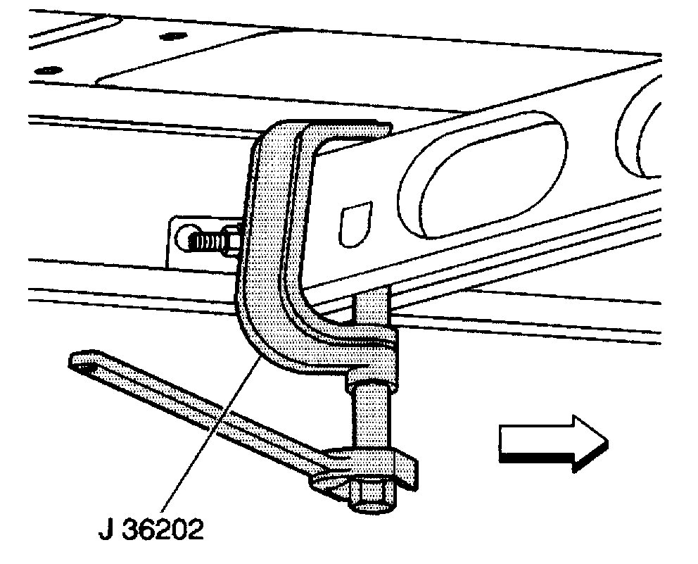

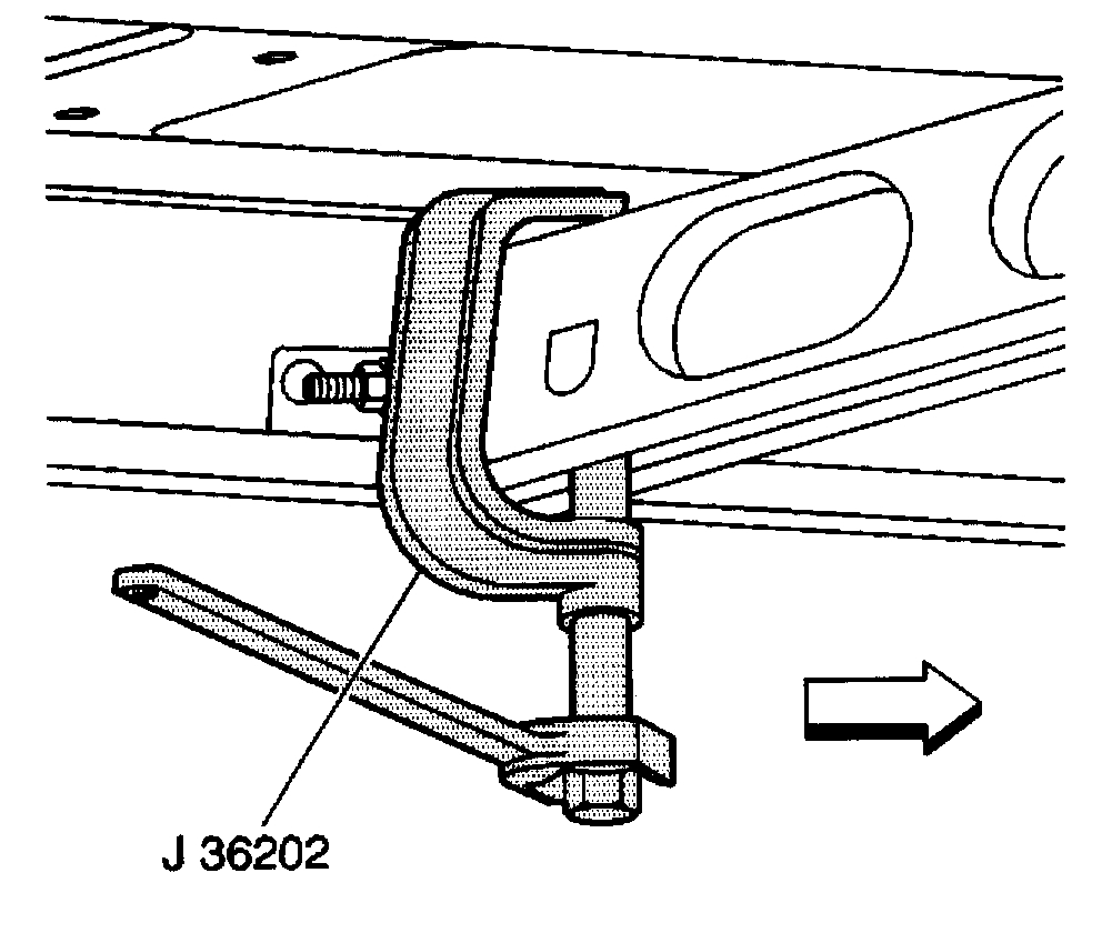

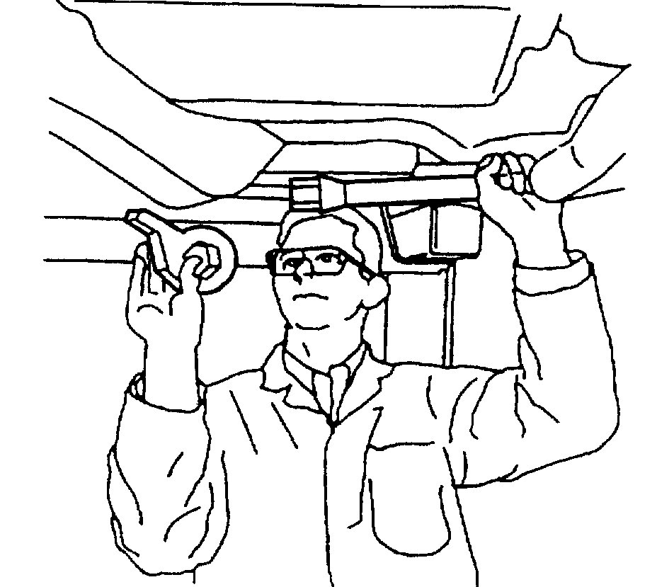

I am going to provide the directions for replacement. Read through everything and in the install portion, it explains how to adjust height. The attached pics correlate with the directions.

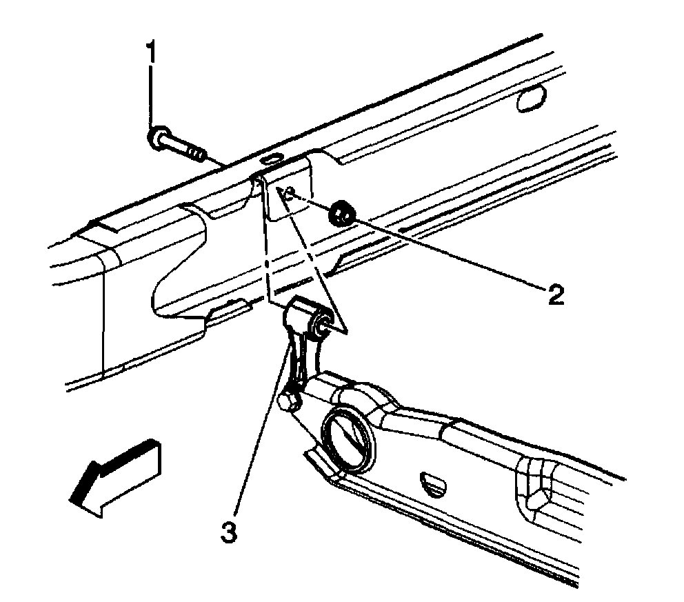

pic 1
1. Raise and support the vehicle. Refer to Vehicle Lifting.
2. Install the J 36202 to the adjustment arm and the crossmember.
3. Increase the tension on the adjustment arm until the load is removed from the adjustment bolt and the adjuster nut.
Important: Mark the adjustment bolt and count the number of times that is required to remove the adjustment bolt.

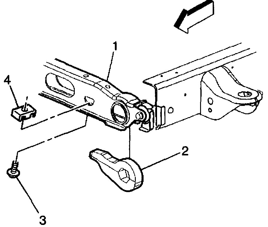

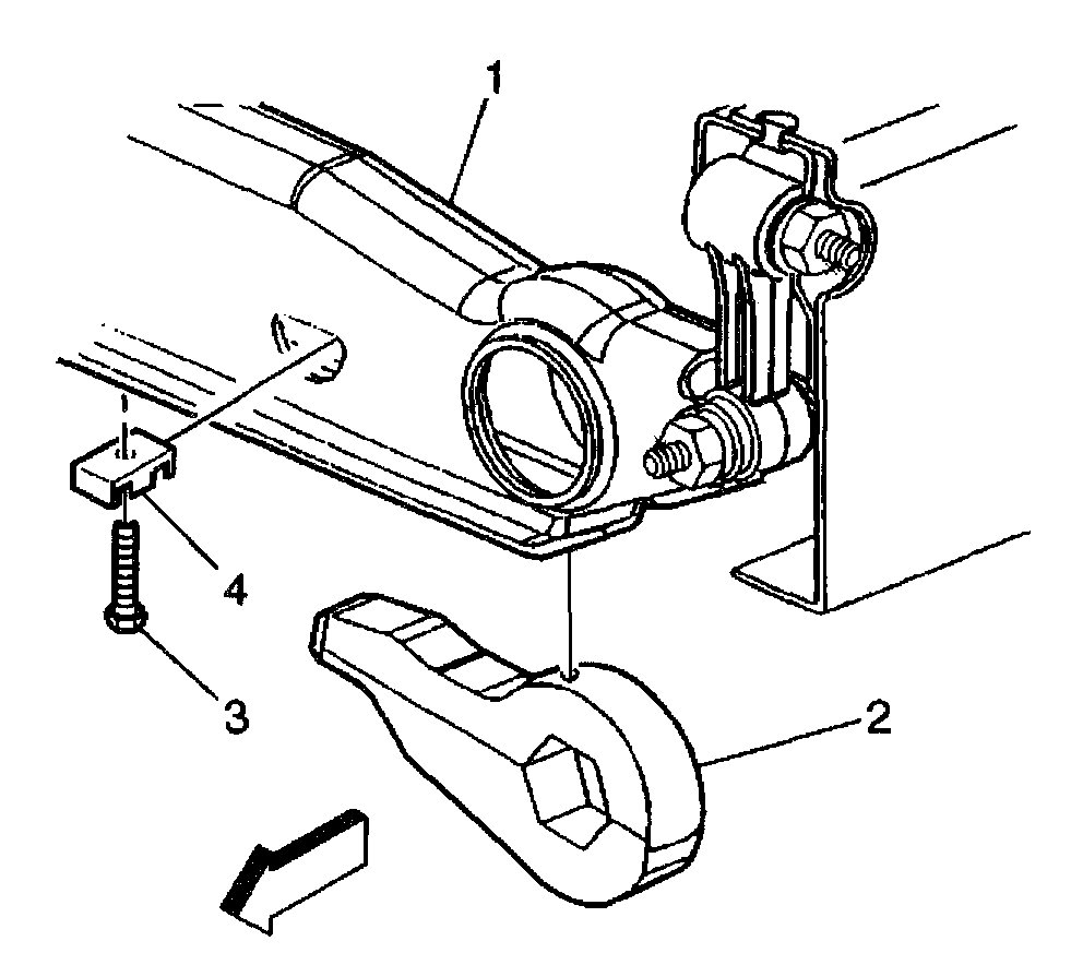

pic 2
4. Remove the adjustment bolt (3) and the adjuster nut (4).

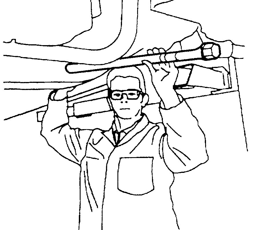

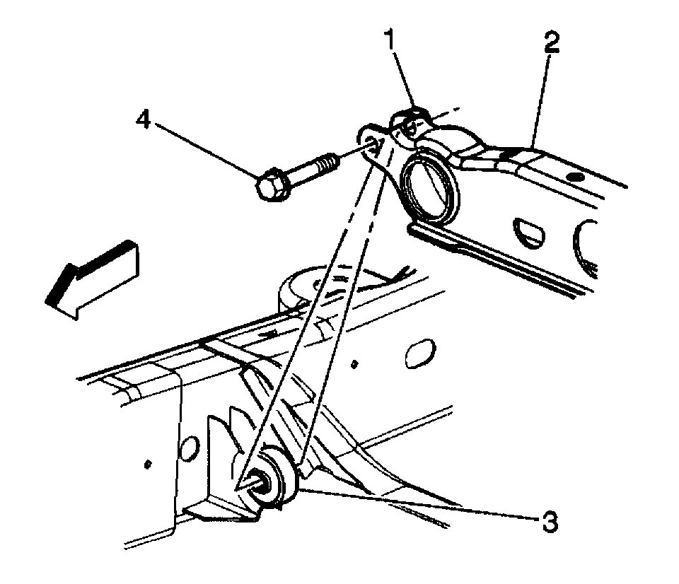

pic 3
5. Remove the adjustment bolt (3) and the adjuster nut (4), for vehicles with MN8, MT1 AND MW3.

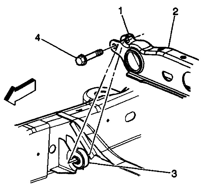

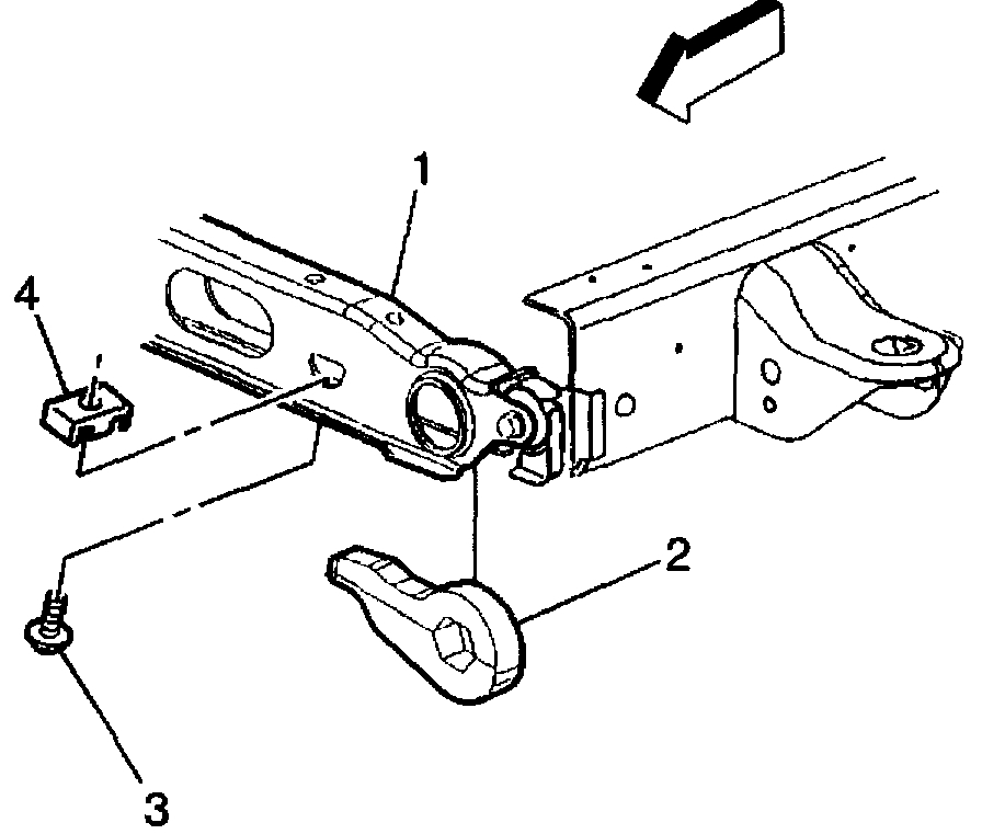

pic 4
6. Remove the J 36202, allowing the torsion bar to unload.
7. Remove the adjustment arm by sliding the torsion bar forward until the torsion bar clears the adjustment arm. Use your hand to support the adjustment arm as the adjustment arm releases from the torsion bar.

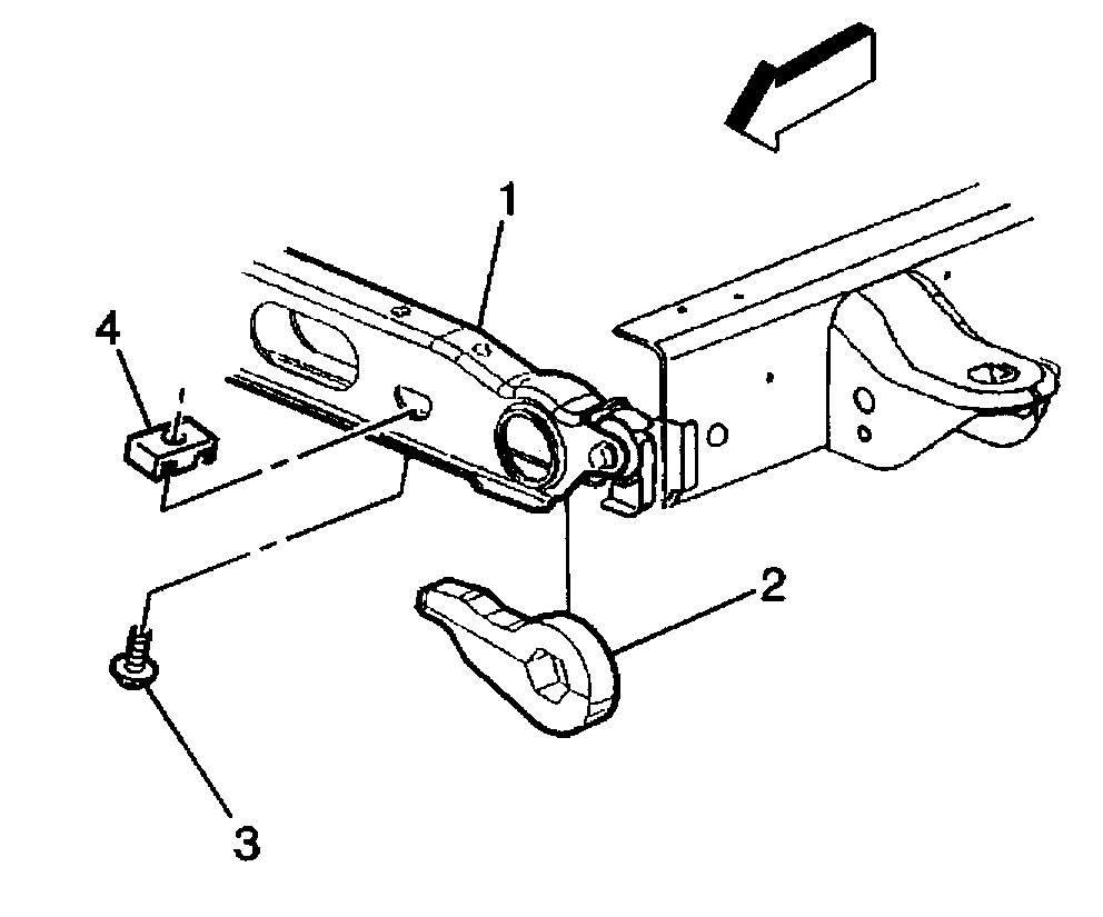

pic 5
8. Remove the torsion bar crossmember bolts (4) from the weld nuts (1).

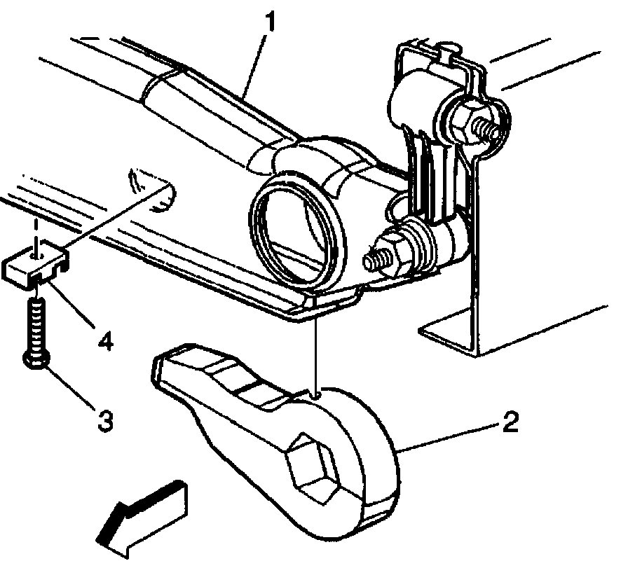

pic 6
9. Remove the upper link mounting nuts (1) and the bolts (2).
10. Remove the torsion bar crossmember.

4. Install the upper link mounting nuts and the bolts (3).
^ Tighten the nut to 95 Nm (70 ft. lbs.).

10. Remove the J 36202 releasing the tension on the torsion bar until the load is taken up by the adjustment bolt.
11. Remove the safety stands.
12. Lower the vehicle.
13. Measure the Z height.
pic 14
14. Turn the adjustment bolt (2) clockwise to increase the Z height and counterclockwise to decrease the Z height.
