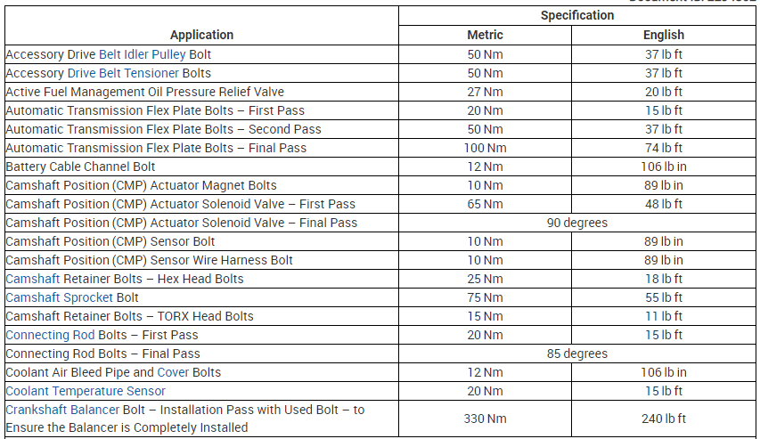

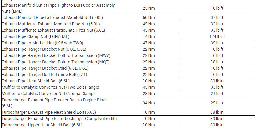

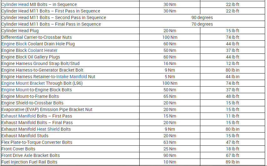

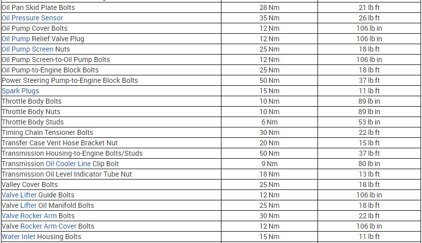

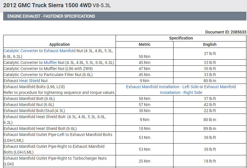

Torque specs for header bolts, rockers, and exhaust manifolds needed
160,000 MILES • 5.3L • V8 • 4WD • AUTOMATIC
MATASKA
Truck listed above is an SLE model. torque specs after I changed lifters so header bolts, exhaust, rockets.
Jun 3, 2021 at 3:56 AM
DANNY L
  • 5,648 POSTS
Hello, I'm Danny.
Here is the information you requested. I've attached pictures below showing the torque specifications for your truck. Let us know if you have any further questions on this question. Hope this helps and thanks for using 2CarPros.
