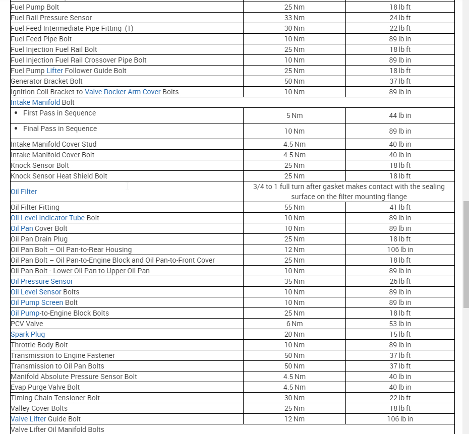

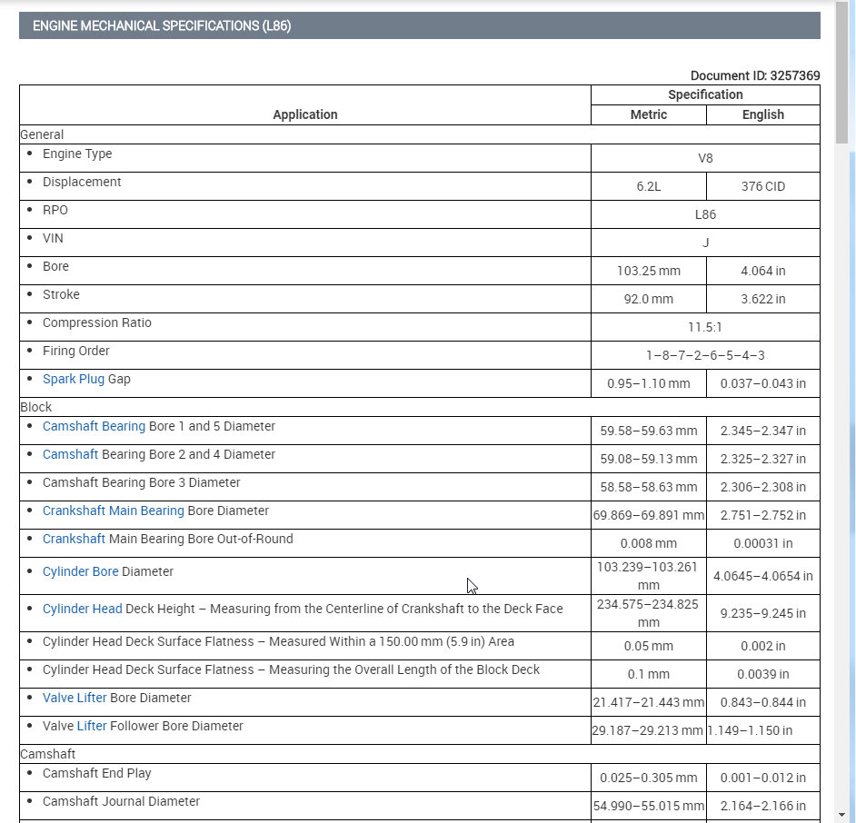

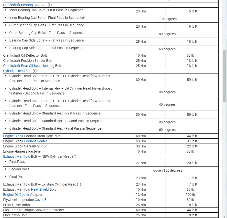

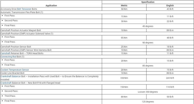

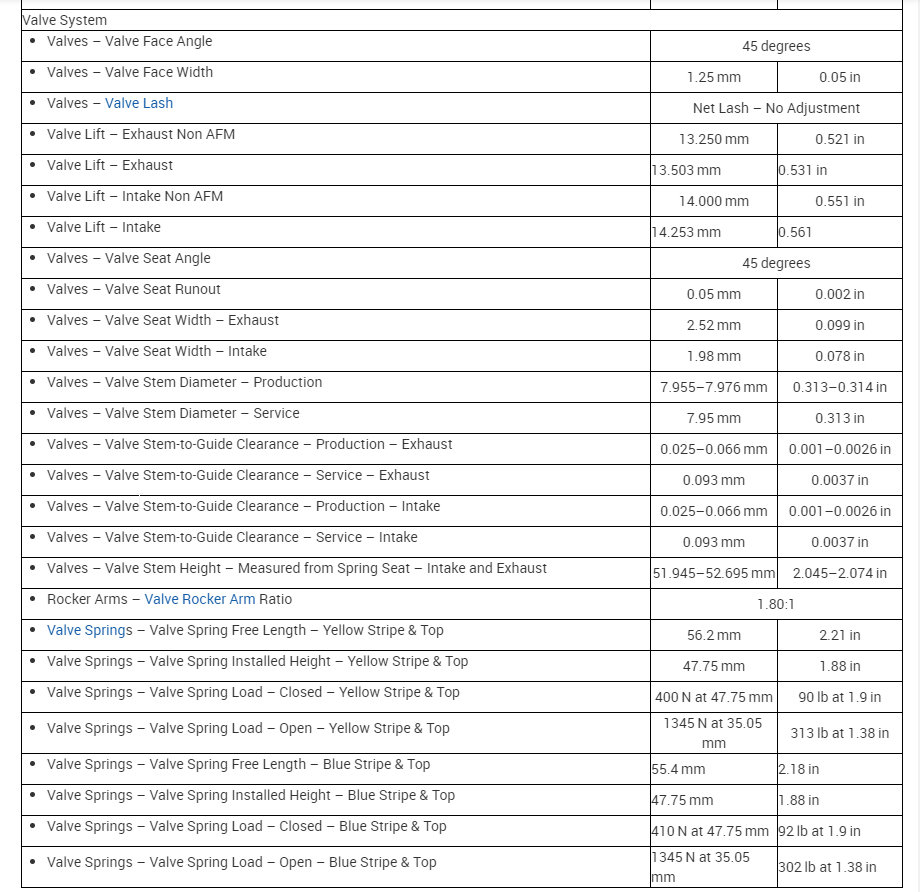

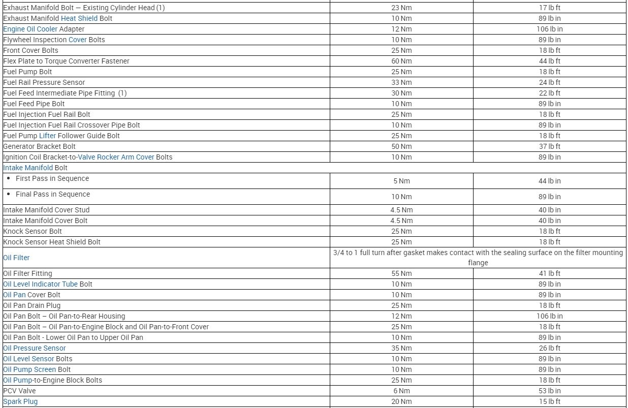

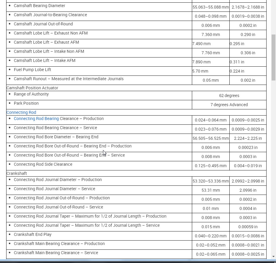

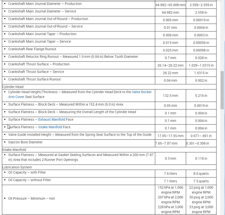

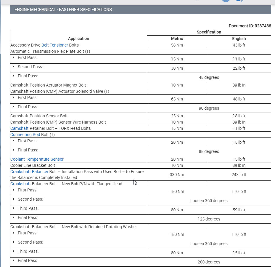

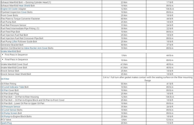

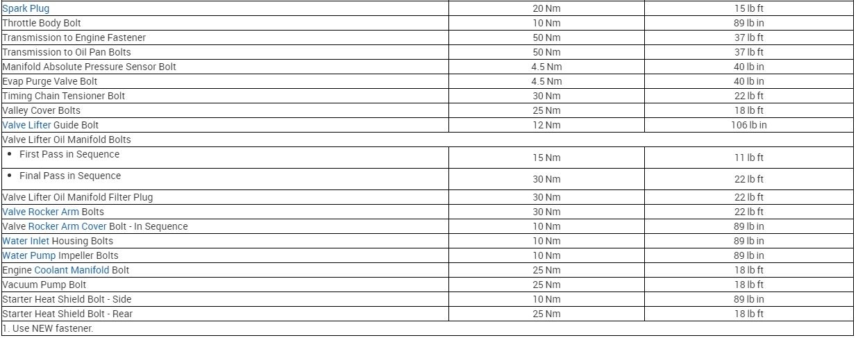

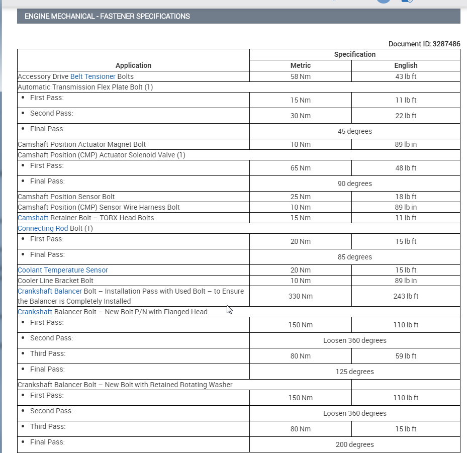

Hello, I have the truck listed above with a collapsed lifter. I have all the parts however, i do not have any torque specs for the L86 engine. I saw on your website torque specs however it didn't specify if it is the L86 engine. Can you please help?
Dec 4, 2019 at 7:00 AM

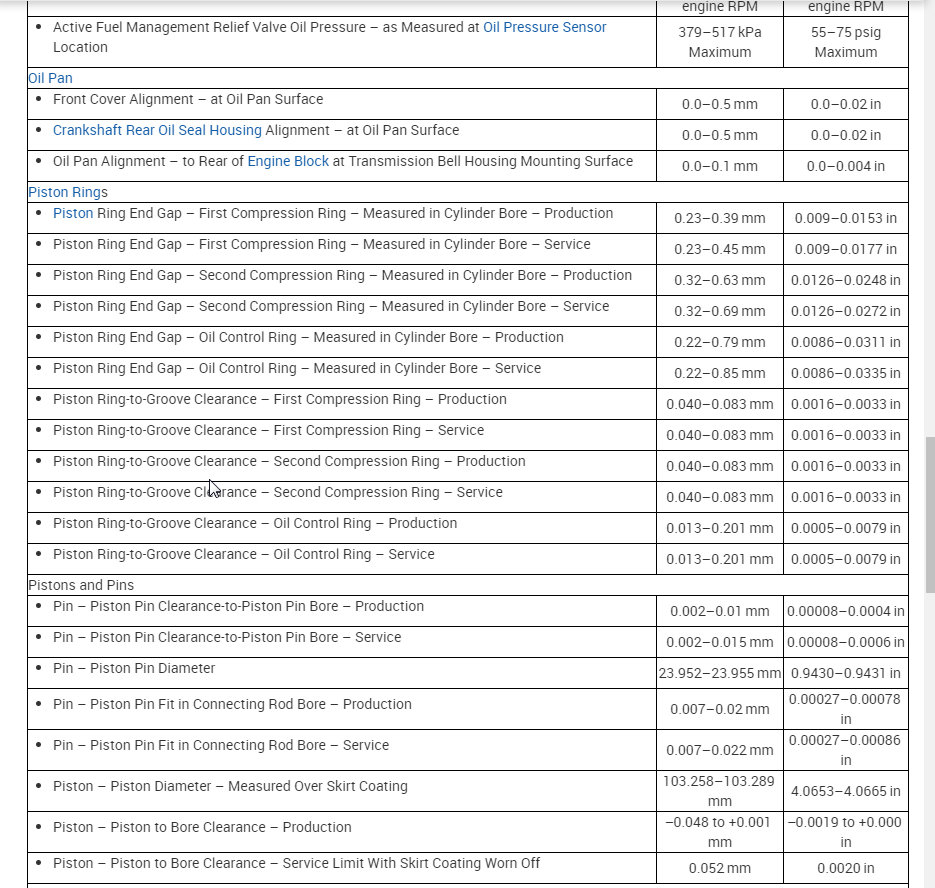

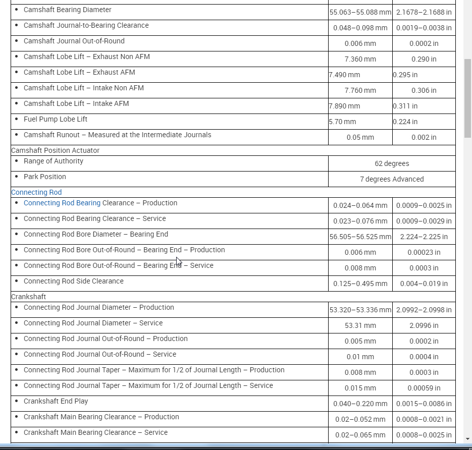

I attached all the engine specs for the L86. Let me know if you don't see something that you are looking for. Thanks (head torque specs are in the lower post)
Dec 4, 2019 at 9:02 AM
CMACDONALD0407

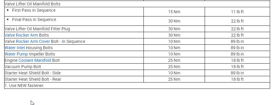

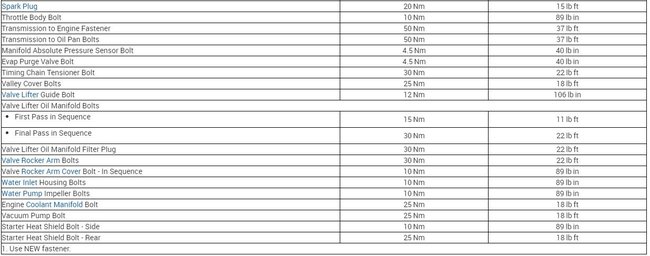

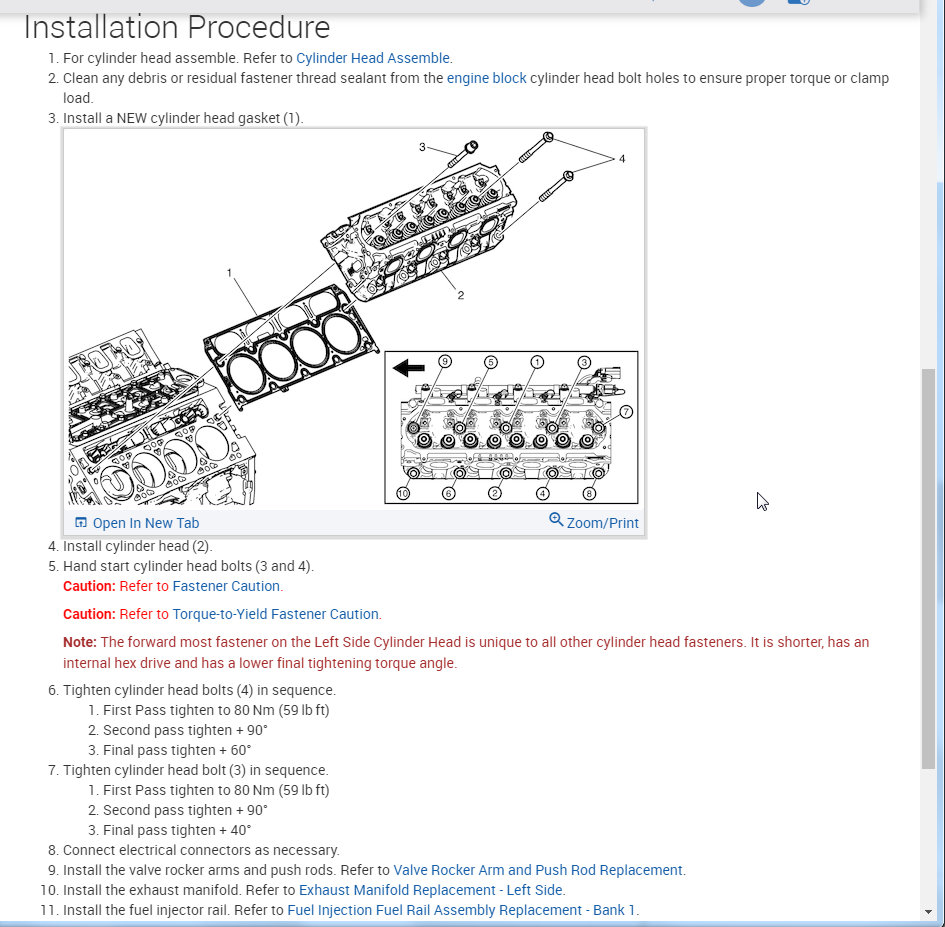

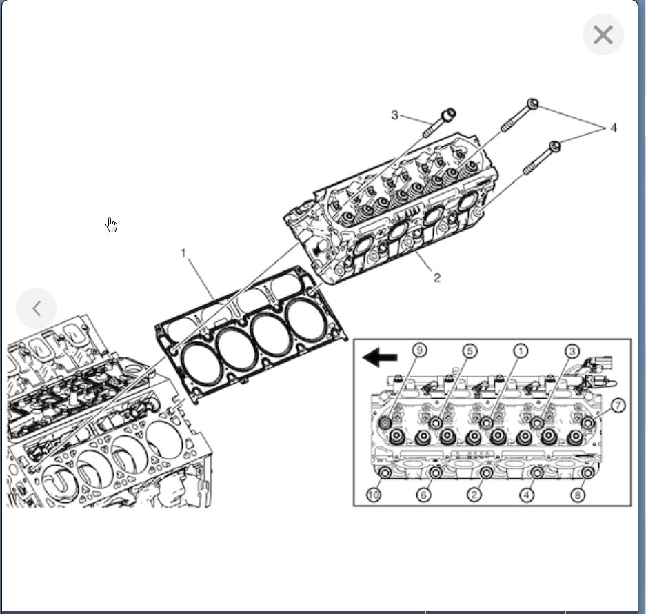

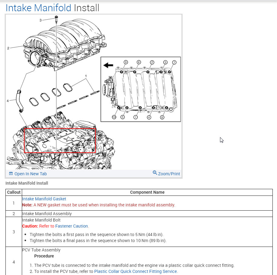

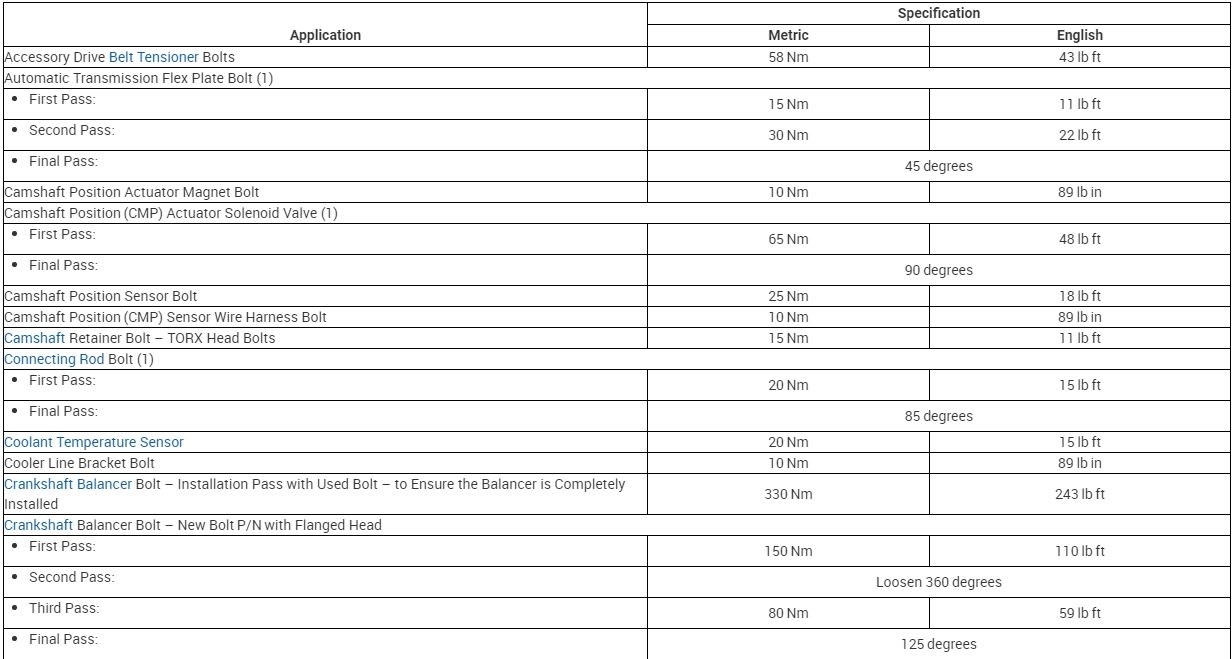

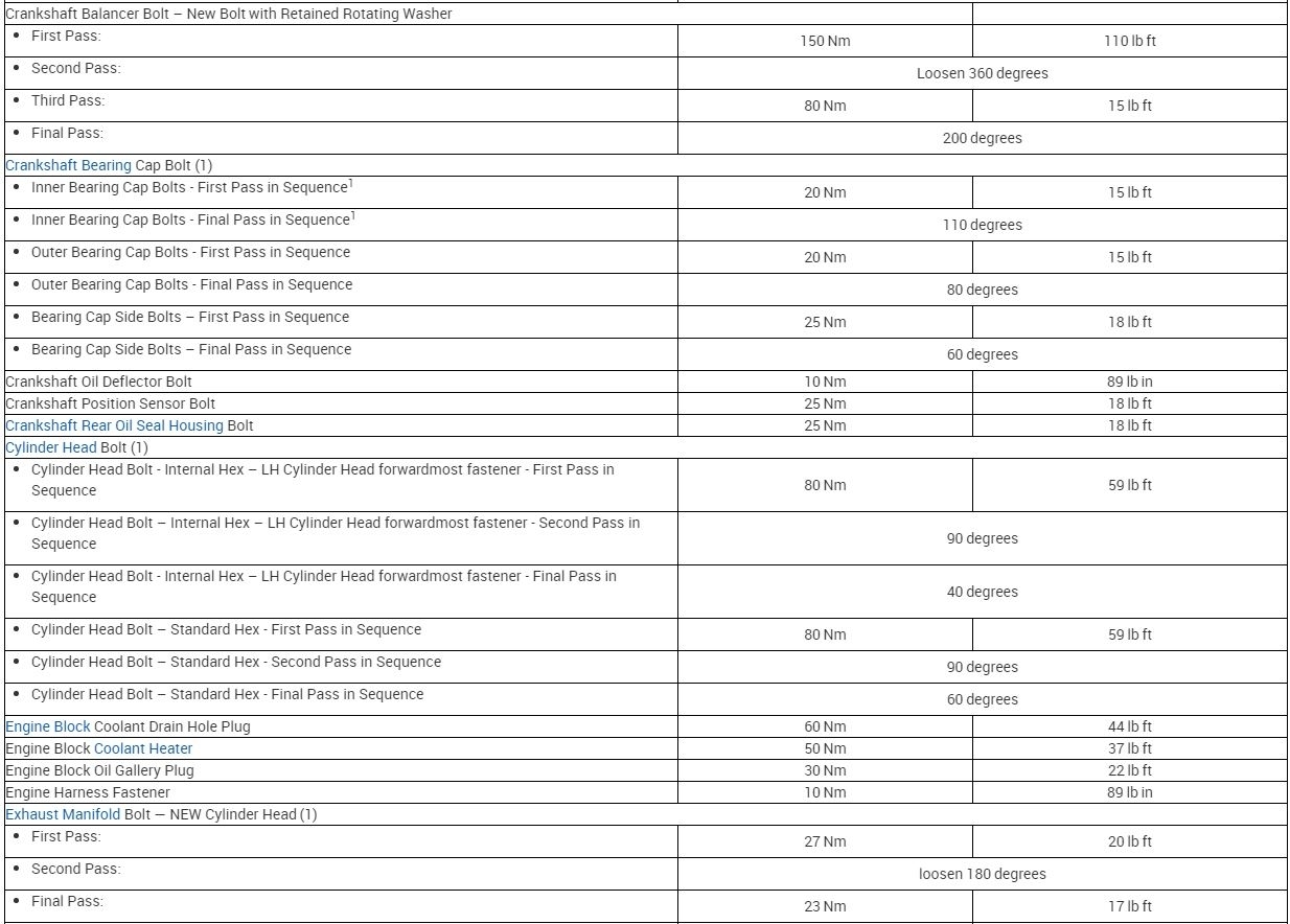

Thank you for the quick response. I am looking on how to torque the head bolts and valley oil manifold. I found the torque sequence just missing the torque specs.
Thank you so much!
Dec 4, 2019 at 10:48 AM

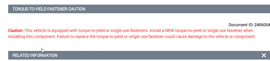

I figured that was in there. Sorry. It was not included. Here is the process with the torque specs for the head. Also, there is a warning but just make sure you use new head bolts. These are torque to yield and cannot be reused.
When you say valley oil manifold are you talking about the valley pan under the intake?

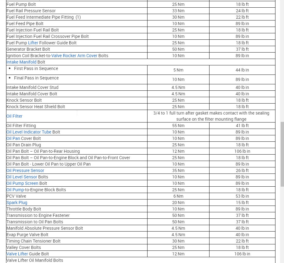

Try these.
Dec 4, 2019 at 11:21 AM
CMACDONALD0407
Thank you very much! This is exactly what I was looking for.

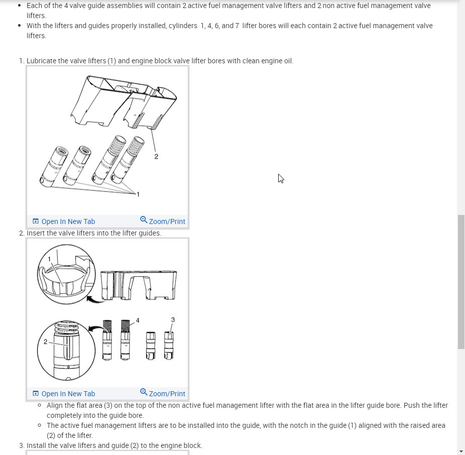

On another note; Do I need to soak the AFM or DOD lifters before i install them?
Dec 4, 2019 at 11:31 AM
CMACDONALD0407
Is there any way you can send in a PDF so I can print?
Dec 4, 2019 at 11:32 AM
You do not have to but it won't hurt. The only reason to is to ensure the needle bearing is protected at first start up. They tell you that the active fuel management lifters only need to be lubricated with oil so if you want to soak them, that would be fine but it does not need to be a long period of time.
