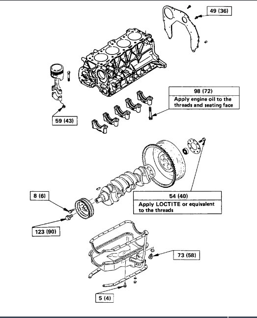

main bearing cap torque, rod torque.
May 31, 2019 at 10:17 AM
DANNY L
Experienced Mechanic
5,648 POSTS
Hello, I'm Danny.
I've attached a picture below of the specifications you're asking for.The first number is Newton Meters and the number in parentheses is Lb Ft. Hope this helps and thanks for using 2CarPros.
