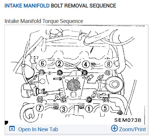

What is the torque spec for the intake manifold on a vg30i engine.
Mar 28, 2025 at 1:45 AM
  • 55,711 POSTS
The torque specs for the intake manifold are 12-14 foot pounds, here is the sequence as well. Check out the images (below). Let us know if you need anything else.
