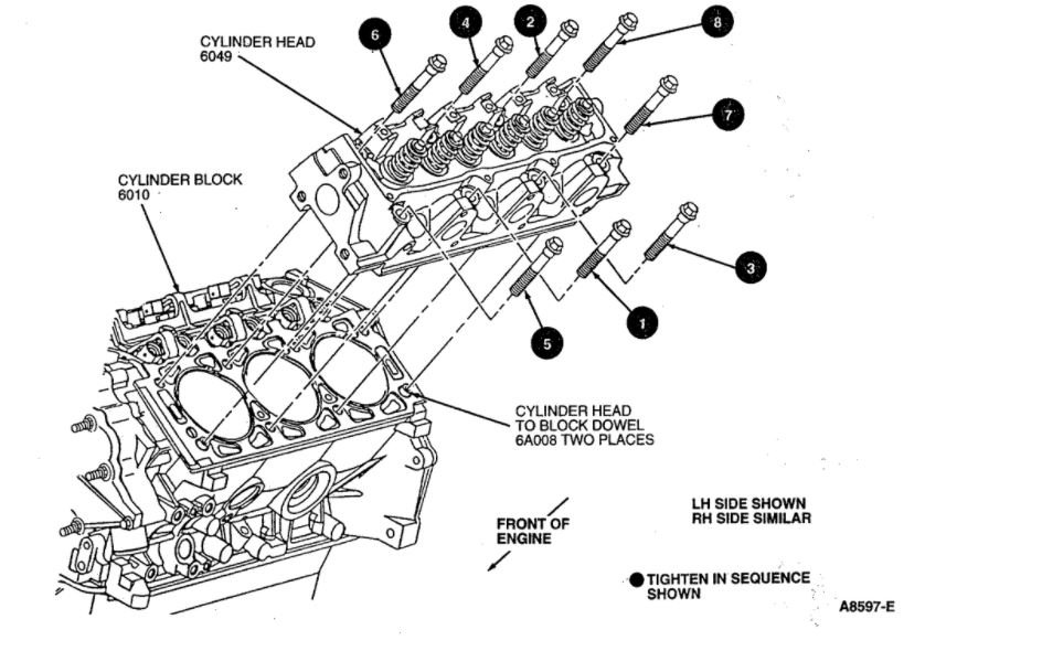

I am in desperate need of the car listed above ohv torque sequence for head bolts and intake.
Thursday, March 22nd, 2018 AT 12:48 PM
17 Replies
  • 52,797 POSTS
Good afternoon. The torque is below and the torque sequence is attached.
. Install new cylinder head retaining bolts:
- Tighten retaining bolts in sequence shown to 80 Nm (59 ft. Lbs.).
- Then back off bolts 360°.
Caution: Always use new cylinder head bolts when installing cylinder head or damage to engine may occur.
5. Tighten the cylinder head retaining bolts in two final tightening steps in sequence shown in the following illustration:
- 50 Nm (37 ft. Lbs.)
- 92 Nm (68 ft. Lbs.)
Note: When cylinder head retaining bolts have been tightened, it is not necessary to re-tighten the bolts after extended engine operation.

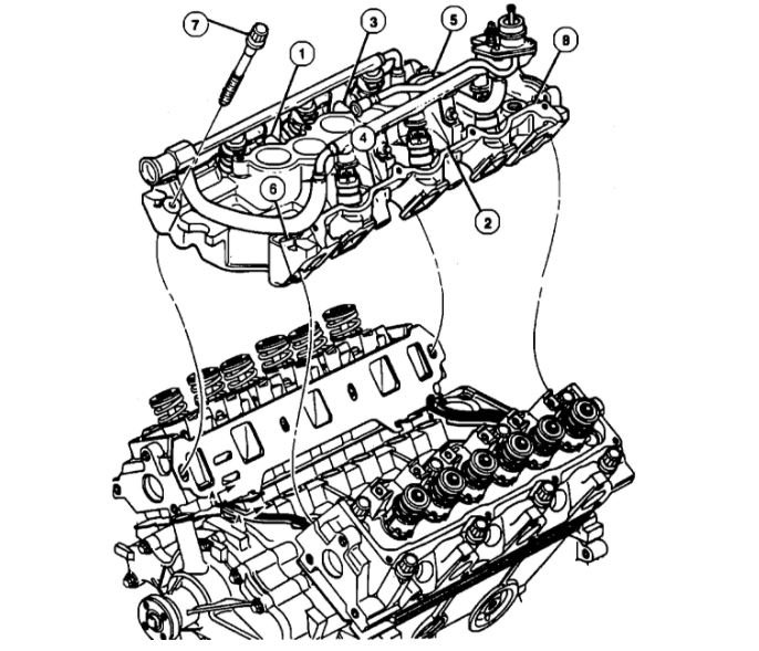

Intake manifold.
Torque intake manifold bolts in sequence shown in two steps: first to 15-22 ft lb, then to 20-24 ft lb.

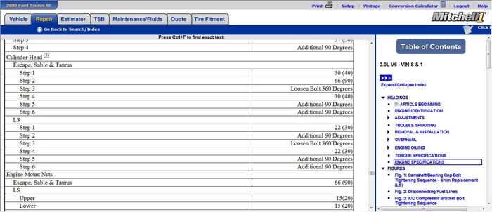

I need torque specs for 2000 taurus 3.0 liter v6 on head bolts. Thanks
+3
Wednesday, April 17th, 2019 AT 6:42 PM (Merged)
  • 75,992 POSTS
3)Tighten bolts to specification, in reverse order of removal sequence.
-2
PHOLLI
Could not read chart was blurry

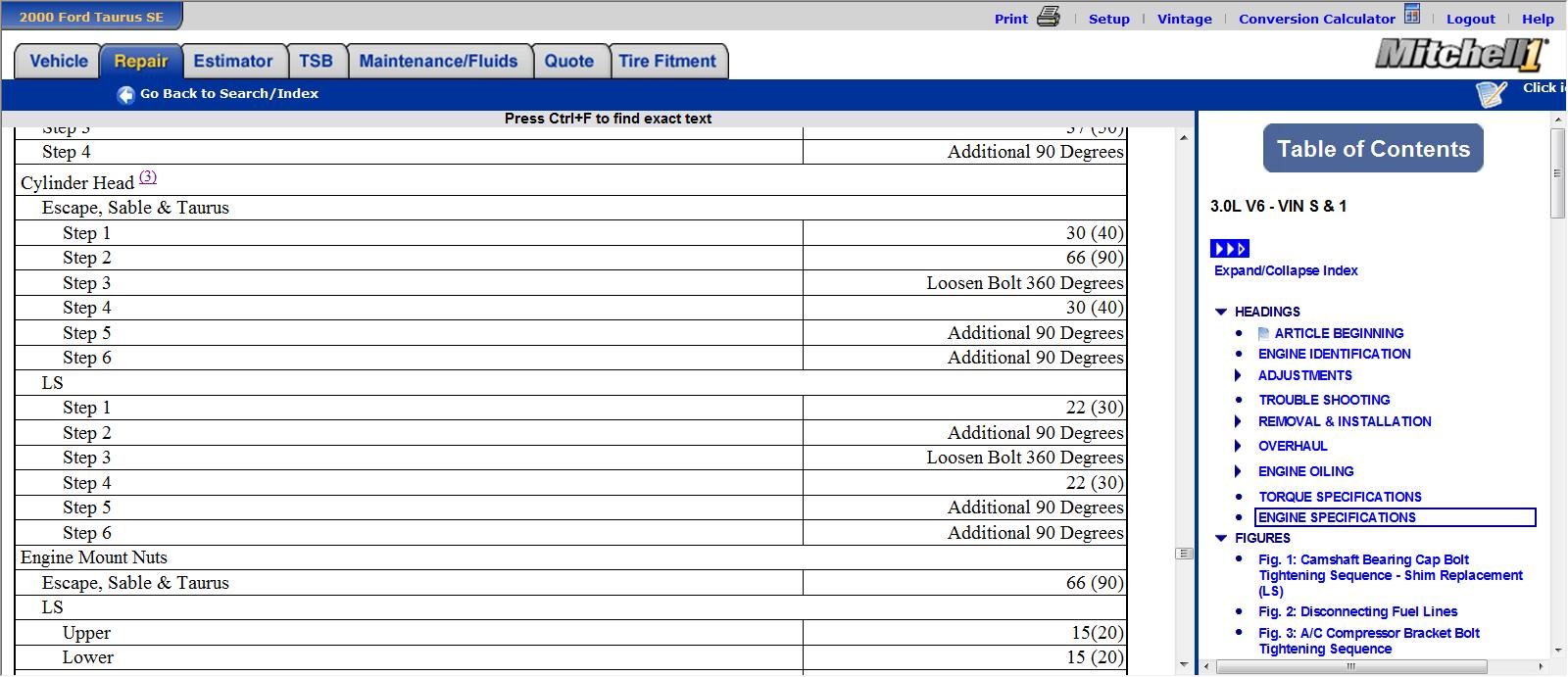

2004 ford tarus 3.0 v6 2 valve engine head bolts torque
+1
DOCFIXIT
  • 18,828 POSTS
Step1 tighten 37 ft. Lb.
Step 2 loosen 1 turn
Step 3 tighten 22 ft. Lbs.
Step 4 tighten 90 Degs
Step 5 tighten 90 Degs
+1

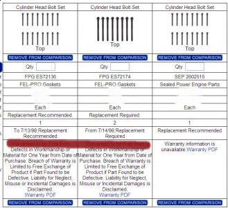

129K miles on 1998 Ford Taurus 3.0L OHV. I am replacing one piston and the connector rod. One cylinder head bolt hole is stripped out. I want to retap the hole without pulling the motor. I can use the Heli-coil kits or their equivalent for this if I knew which size to get. I don't want to guess, and can't find much info about the bolt. It is a new Ford Genuine Part from the dealer, part number F2DZ-6065-A. A local machine shop measured the diameter and pitch of the old bolt and came up with 10.5 x 1.50.
A place that sells bolts and fasteners measured the same bolt and said it was 12.0 x 1.75.
Can you help?
Also, what about the new bolts I have put in already - have executed the first torque, but not the reverse and retorque step. Can I still use them?
I cannot proceed without more information. Thank you so much.
Wednesday, April 17th, 2019 AT 6:43 PM (Merged)
SERVICE WRITER
  • 9,123 POSTS
The bolt size depends on the manufacturing date. This was a mid-year split. So it doesn't matter who measured what. I'd go with the machine shop frankly if I had to choose.. Can always buy a pitch gauge which comes in handy.
To 7-13-98 is one number, the other is obviously from 7-13-98
https://www.2carpros.com/forum/automotive_pictures/30961_ytau_1.jpg
I would get the bolt set you need fresh. This is fel-pro, but call your supplier and ask them to find out what the size is based on your build date.
