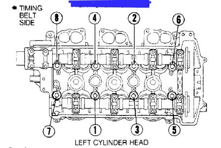

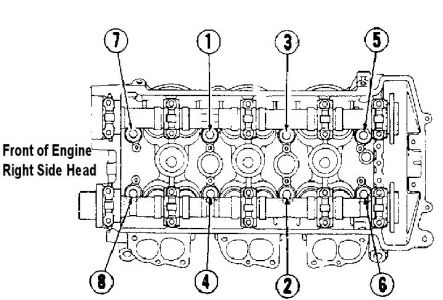

What are the torque specs for the head bots on the 3.0 SHO engine.
Jul 27, 2008 at 10:06 PM
OBXAUTOMEDIC
  • 3,711 POSTS
1st Step is 36 - 51 foot pounds 2nd Step is 61 - 69 foot pounds Torque Sequence....
