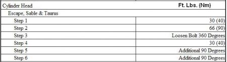

I need torque specs for head

https://images.2carpros.com/forum/automotive_pictures/261618_Noname_1362.jpg
