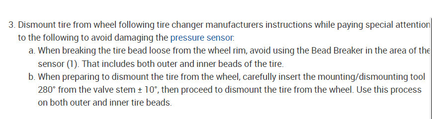

The tire pressure valve registers on my cluster "-" lbs of pressure, while going through a certain stretch of road. A yellow light goes on the cluster. After forty minutes or so the yellow light goes out and the tire pressure valve registers 38 lbs again. This has happened twice, once on my right front and once on my right rear. Is this due to some type of interference in that area of the road or due to some faulty valve sensor? I had 5 new tires installed before this started happening, and this happened on the first long trip after they were installed.

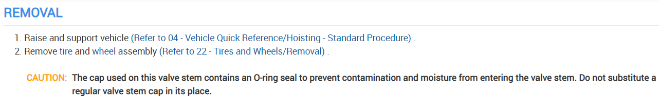

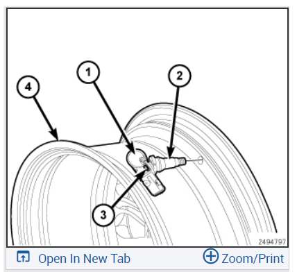

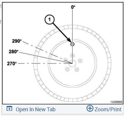

Did the problem happen on the same road before the tires? Electromagnetic Interference (EMI): Certain areas with high electromagnetic interference, such as near large power lines, radio towers, or specific industrial equipment. If not, then the sensors could have got damaged when the tires were installed which is common. The problem is for just one tire, correct? If so, chances are the sensor is bad. Here is information on the tires pressure sensors. Check out the images (below). Please let us know what happens.
