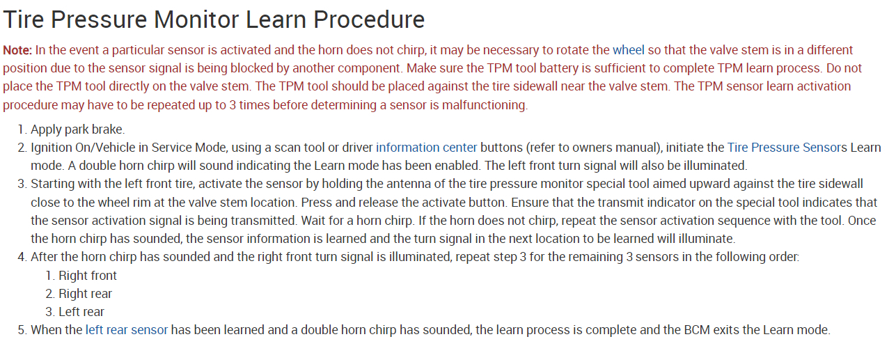

I just had my tires rotated and my tire sensor readings are all blank. Did the dealership forget to reset something? Can I do this myself? If so, what tool can I buy that will absolutely work? I bought a cheaper tool for this awhile back and it didn't work.

Yes, it does, I got the information for the car you registered with. I found more info on the reset. Check out the images (below). Please let us know what happens.

You can reset the tire monitor by using the driver's information center.
"Ignition On/Vehicle in Service Mode, using a scan tool or driver information center buttons (refer to owner's manual), initiate the Tire Pressure Sensors Learn mode."'
Please check out the information in the above post.

Here is the manual TPMS relearn:
Manual Relearn Procedure:
Turn the ignition to the "On" position without starting the engine. Press and hold the TPMS reset button, until the TPMS light blinks twice. Release the button and drive for about 10 minutes, this should recalibrate.
If this doesn't work you will need the scanner or you can try a hard system reboot.
https://www.2carpros.com/articles/step-by-step-guide-performing-a-hard-system-reboot-for-your-vehicles-electronics-systems
I have seen this work.
