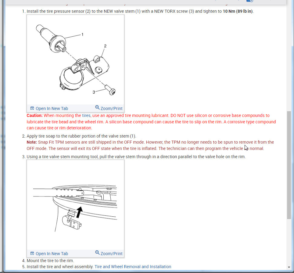

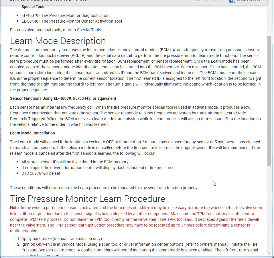

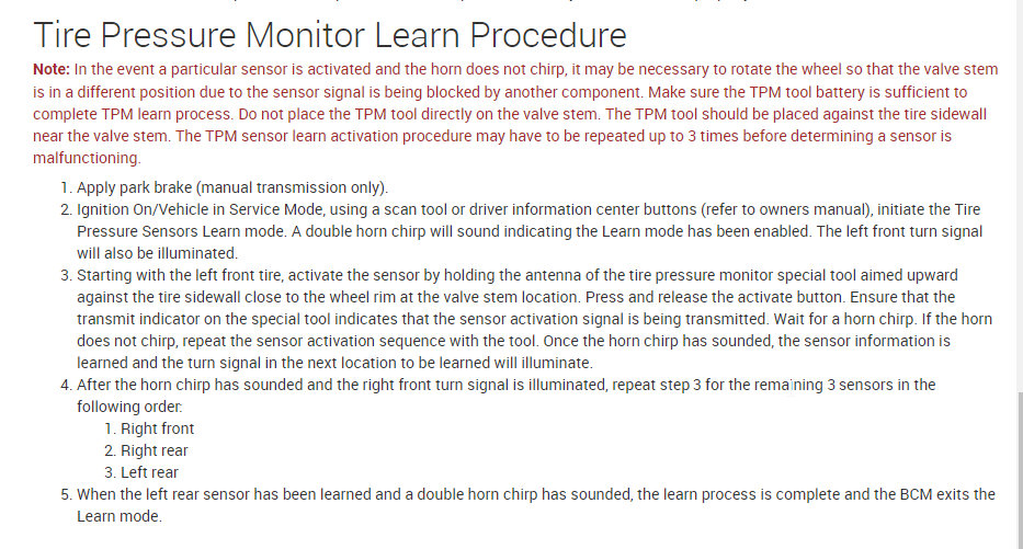

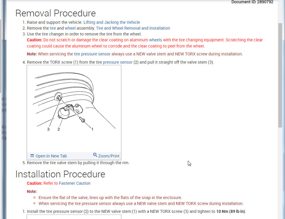

These sensors will not be picked up on this system. The different hertz readings are different for a reason and it simply operates on different wave lengths. Literally.
As for installing the other sensors on these wheels, that should work. The only issue you would have is if the style of these new wheels will not accept the sensor and the only way we are going to find this out is to install them. Unfortunately there is no cross reference on these to find out if they are compatible.
Below is the process for this if you need it but it doesn't sound like it. Let us know what questions you have.
