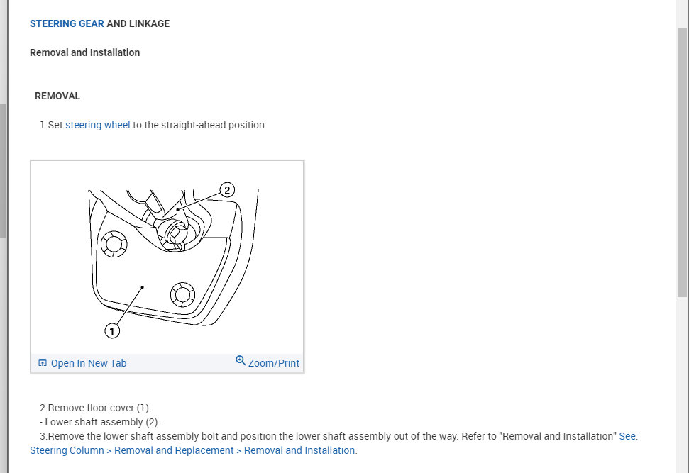

More than likely this is a tie rod issue or other control arm issue, but I would not drive this vehicle until this is repaired.
https://www.2carpros.com/articles/tie-rod-end-replacement
If this is a tie rod, then that can break and cause you to lose the ability to steer the vehicle.
Are you able to get a couple pictures of the steering system and the wheel area under the car and we can try and identify the parts that need to be replaced?

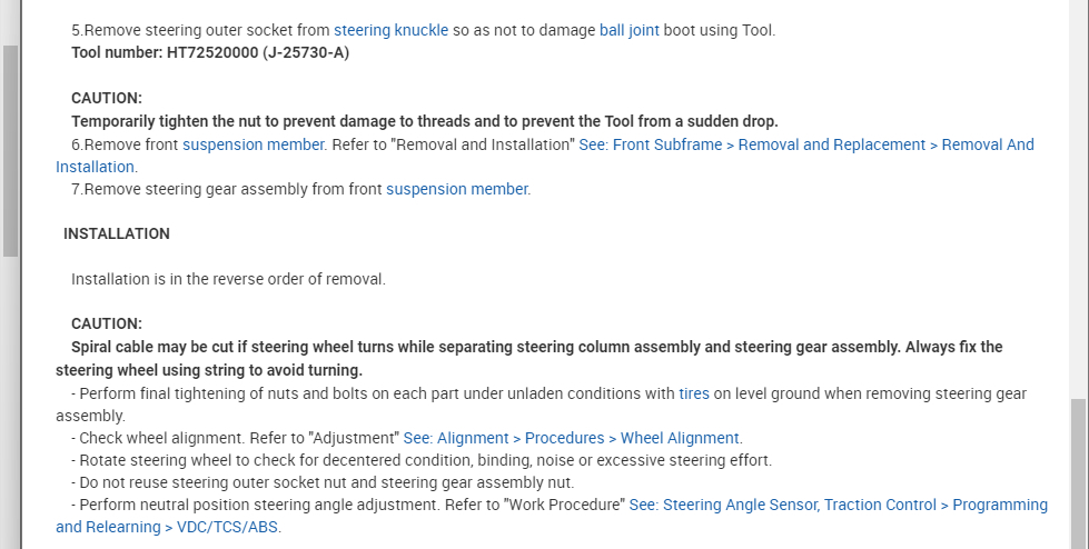

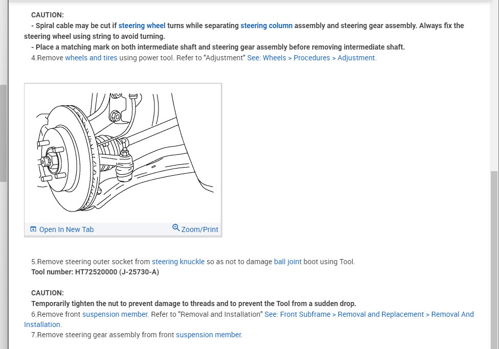

I am attaching the process below if the steering rack is damaged as this is possible as well. However, let's get a picture and we can go from there. Thanks
