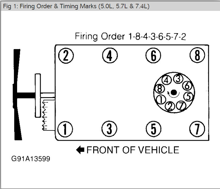

Bad distributor so went to install new part removed cap on old part after unplugging advance and set to TDC seen the rotor is pointed at #6 cylinder put new distributor in the same when set to 0 TDC for timing and connect advance engine does not run right. Unplug advance turn distributor until it ran smooth and the line is way off to the left. When I do get it running smooth it is for a short time and it goes back to running bad or cold start I below 0 weather it misses bad slight pop no fast idle.

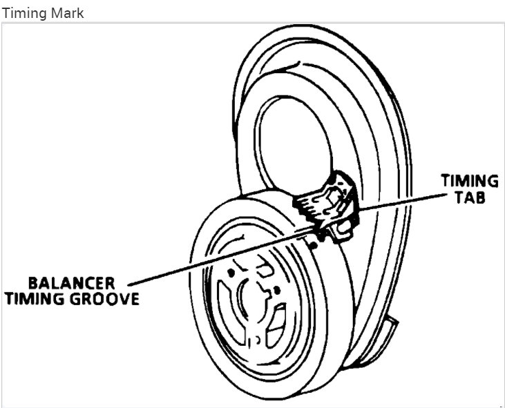

With the timing mark being off to the left, it sounds like the distributor is off a tooth or so. It can be difficult to line them up perfectly sometimes. What you can do is get the #1 Cylinder up to Top Dead Center (TDC) and pull the distributor cap off and make sure it's at the #1 exactly. I will post the cylinder layout below and the firing order. Another possibility is that the crankshaft harmonic balancer has broken free and shifted where the TDC mark is. This would throw the timing off because the crankshaft is not actually lined up correctly, especially on an older vehicle like this.

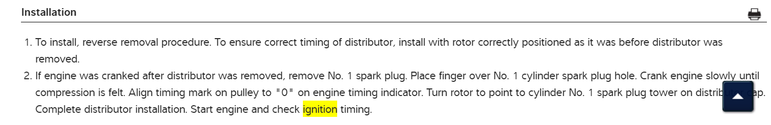

But take out the #1 spark plug and turn the engine over by hand until you feel compression coming from the #1 sparkplug hole and the harmonic balancer should be getting close to the TDC mark, so line that up. Then recheck where the distributor rotor is pointing. It should be exactly at the #1 spark plus wire position. If it is not, then the distributor is off by a tooth or 2, or the harmonic balancer has spun.

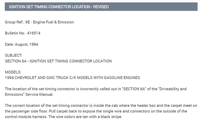

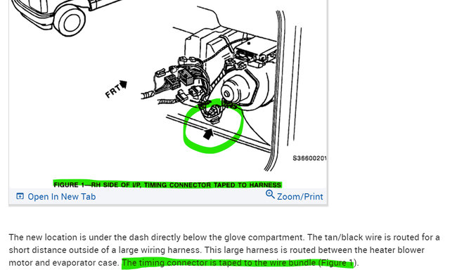

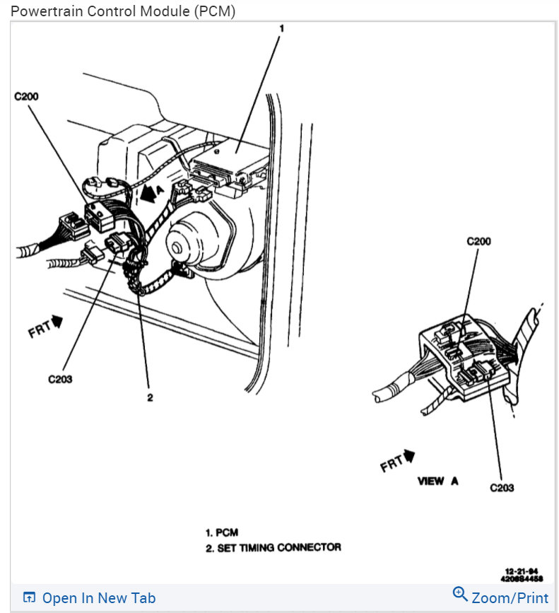

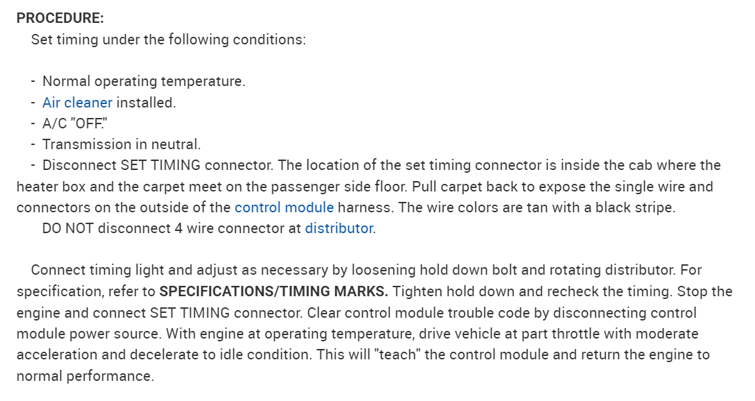

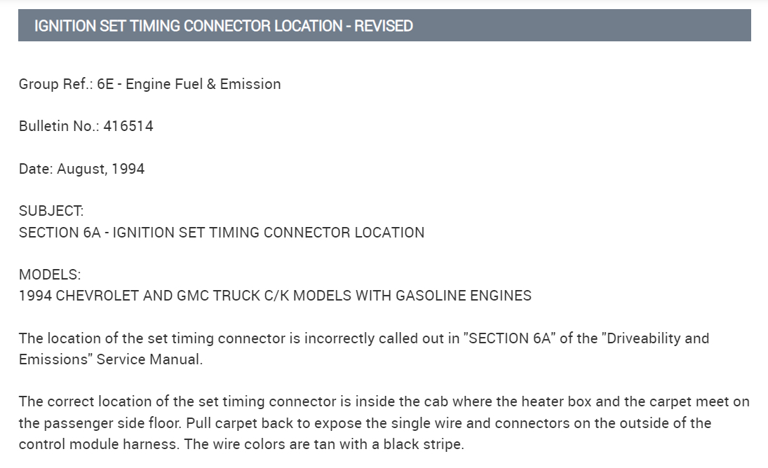

One other thing, how did you disable the ESP? I'm looking up the timing on this vehicle, data sheet is telling me the ESP connector is under the passenger side carpet, single wire connector, it says do not disconnect the distributor 4 wire connector.
Also, you have to turn the engine off and then connect to the ESP wire, this will reset the timing and give the ECM control.
