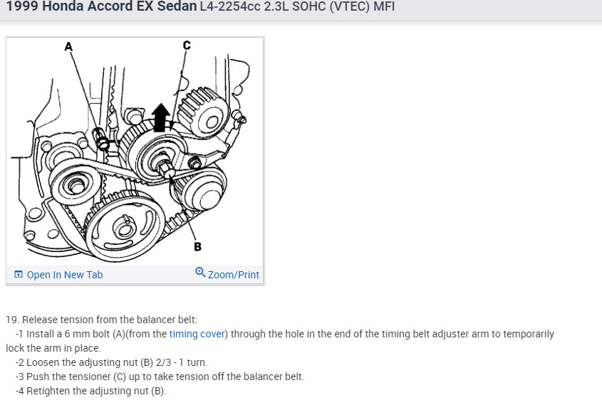

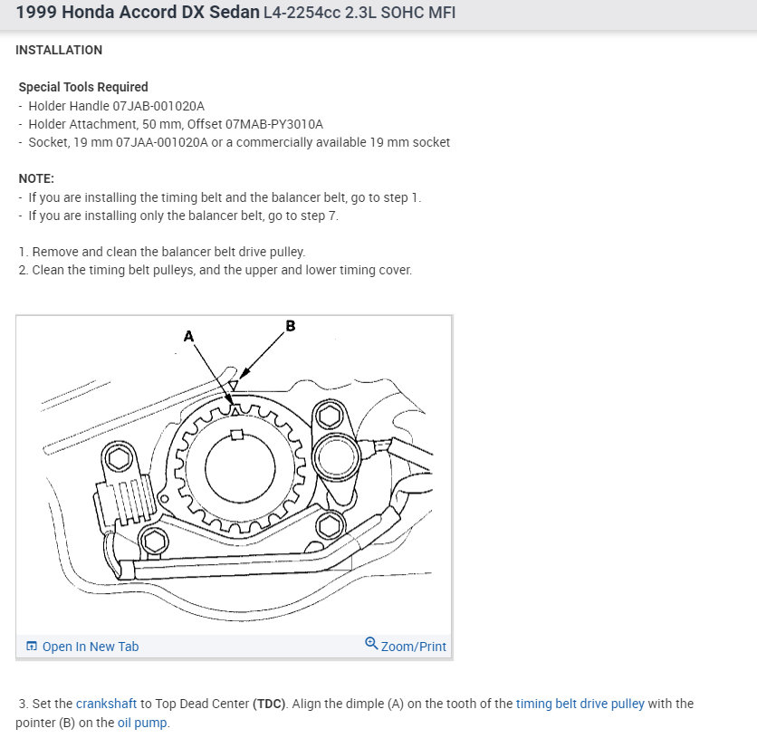

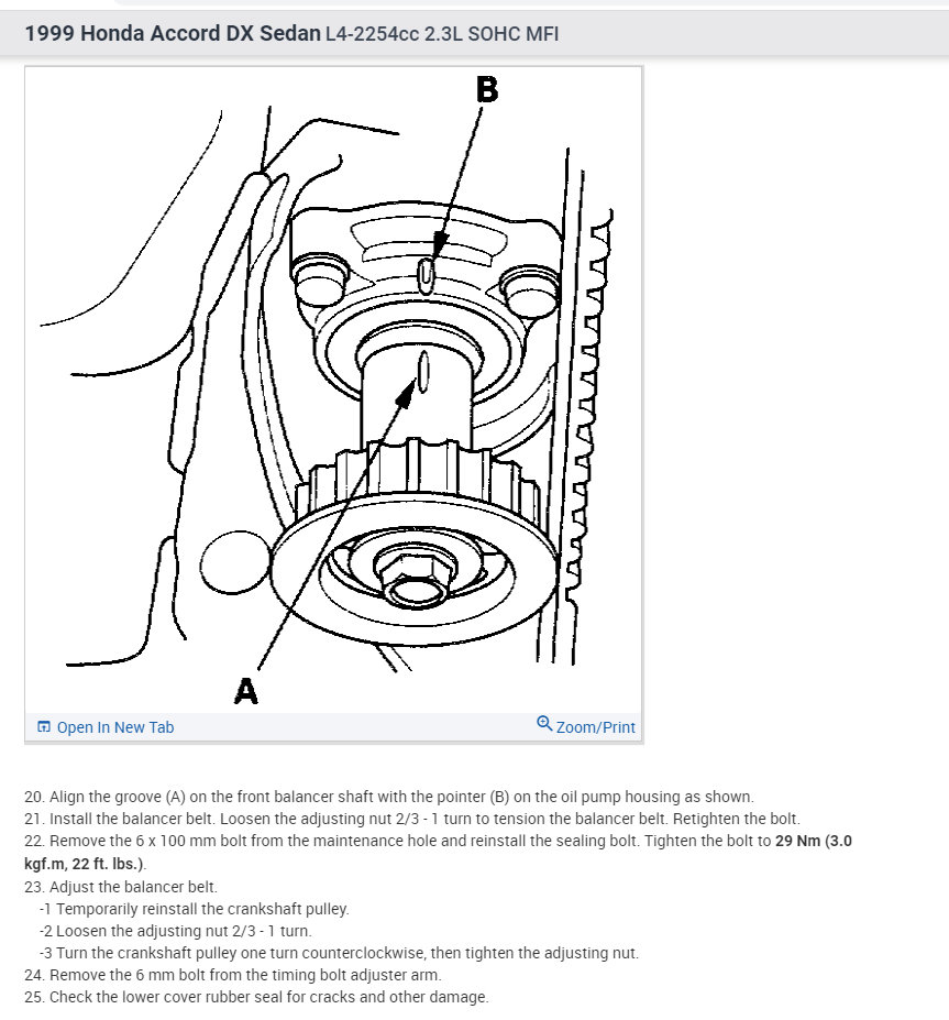

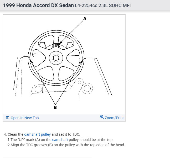

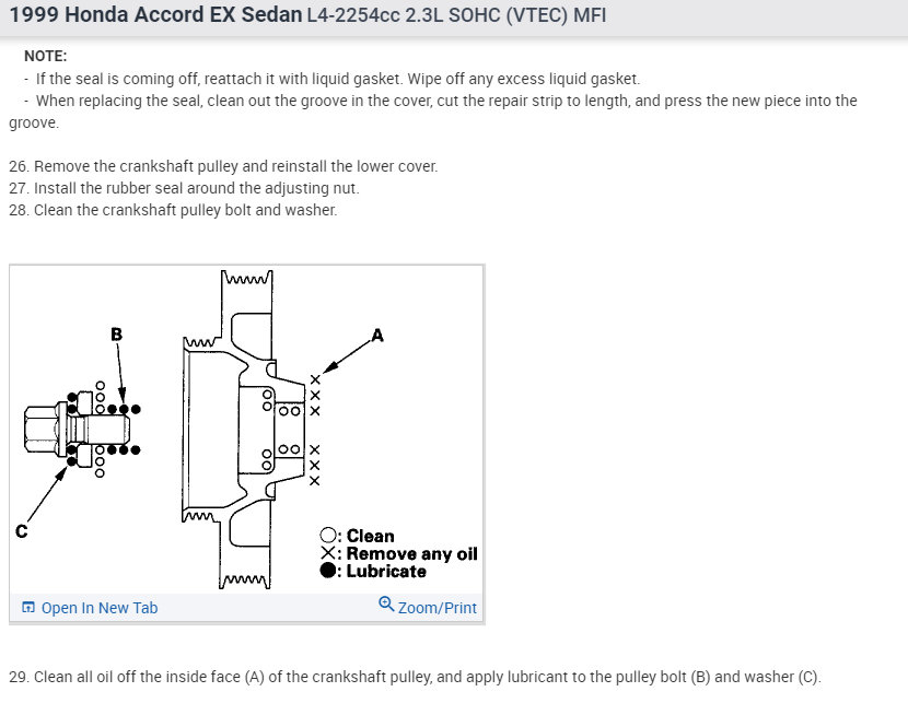

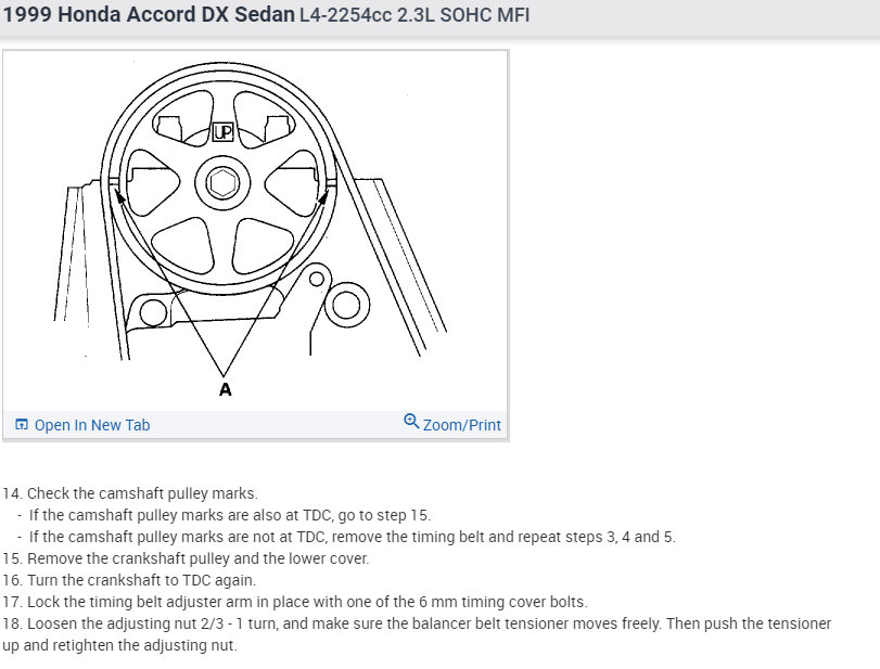

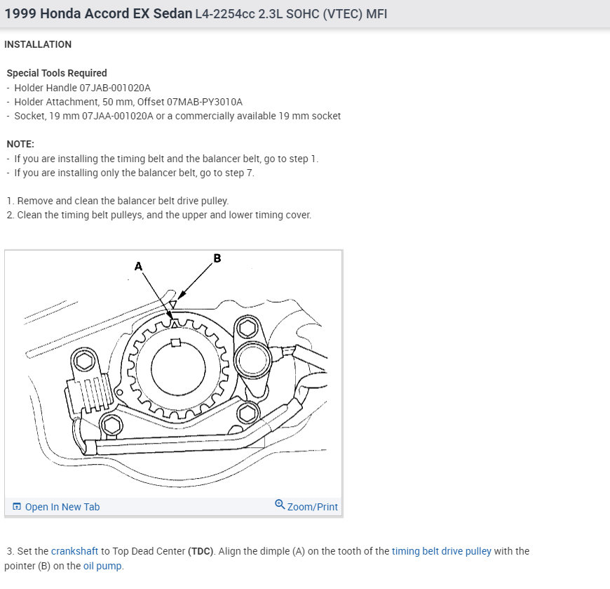

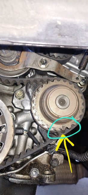

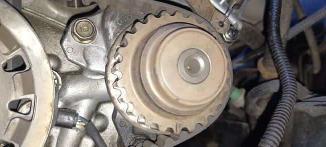

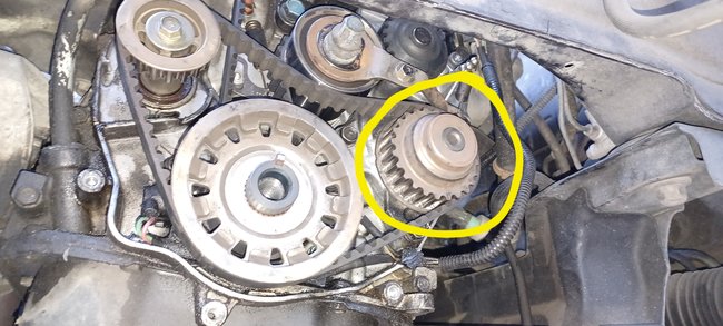

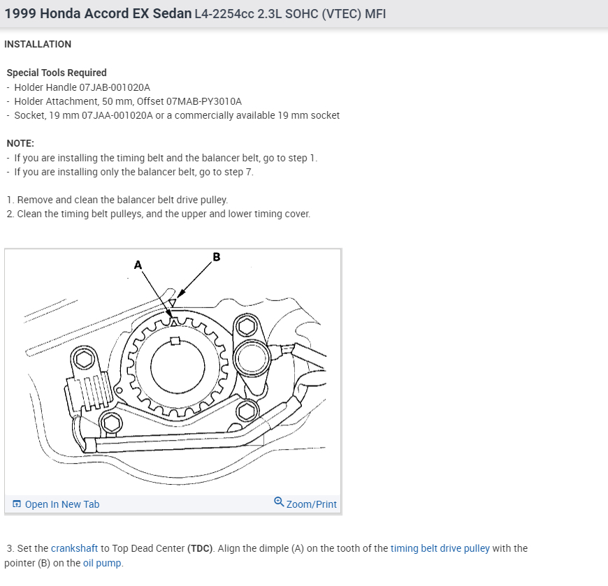

My timing is off on the vehicle and I'm trying to correct it. I have the Haynes manual but I'm not finding the specifications for one of these sprocket alignments that has a mark. I'm going to include a picture and hopefully that will help to identify where this Mark is supposed to be at and what the actual sprocket is called.
Aug 29, 2022 at 9:29 AM
SQM
  • 6,383 POSTS

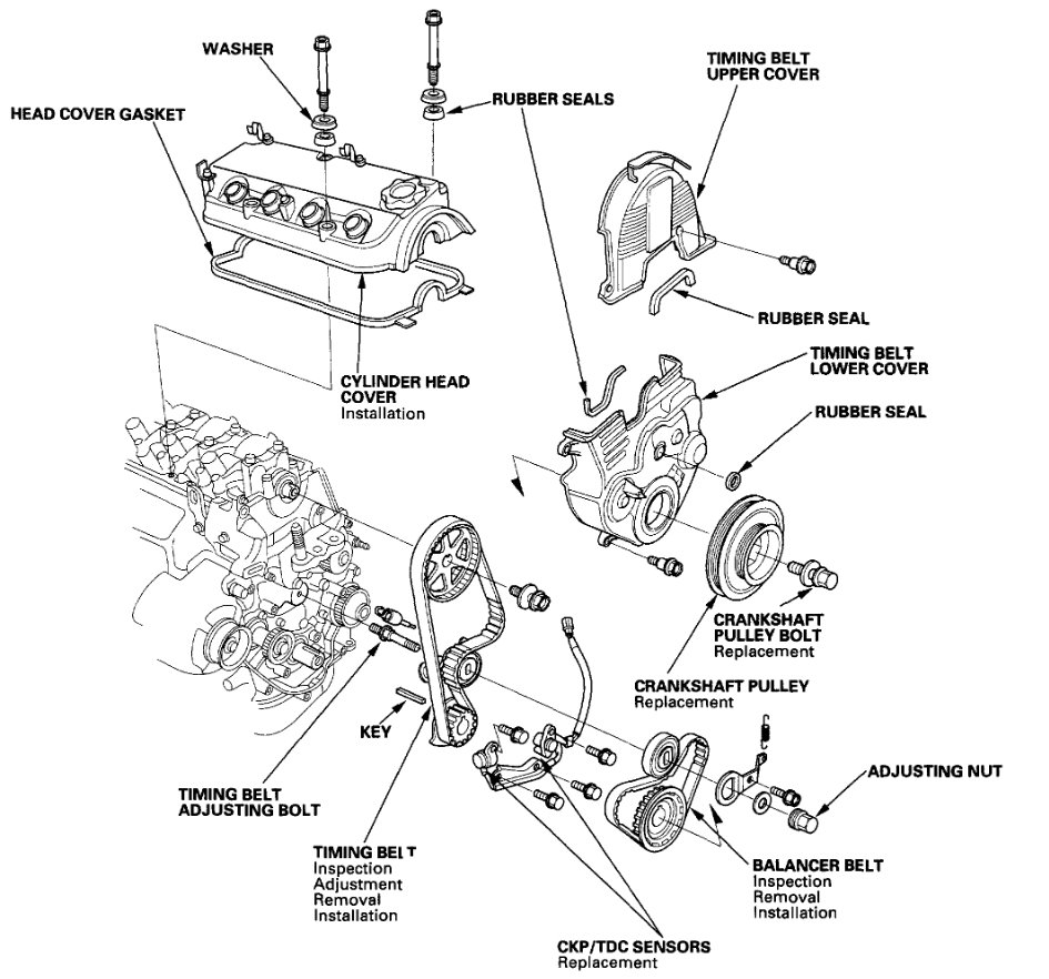

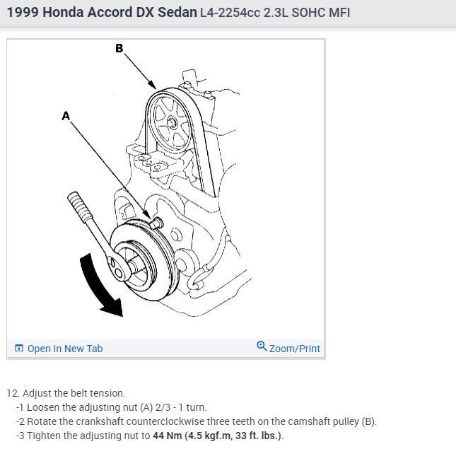

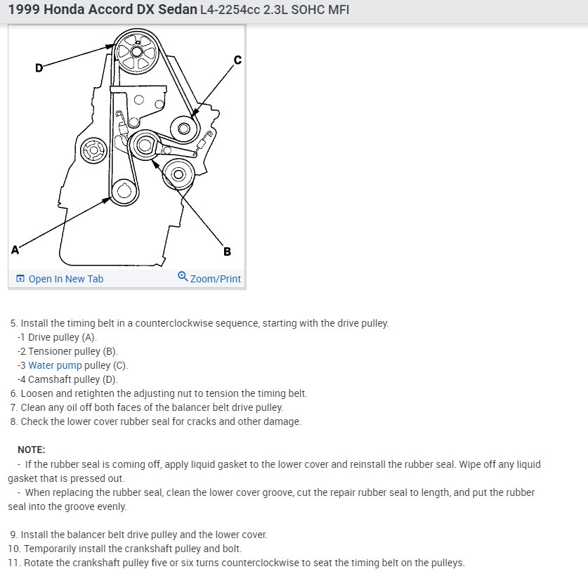

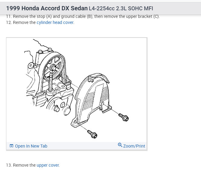

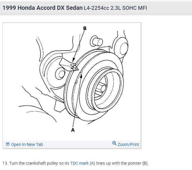

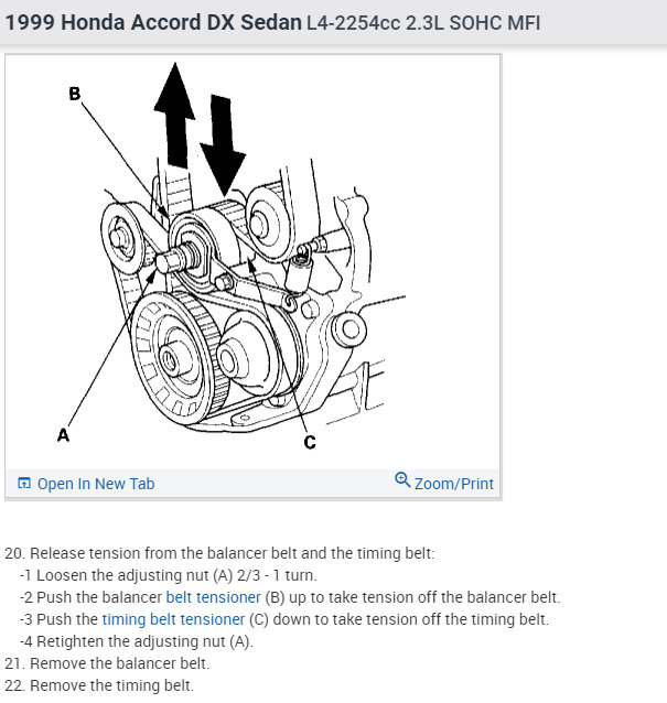

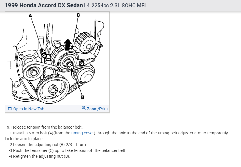

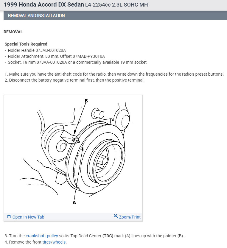

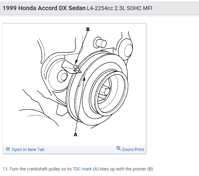

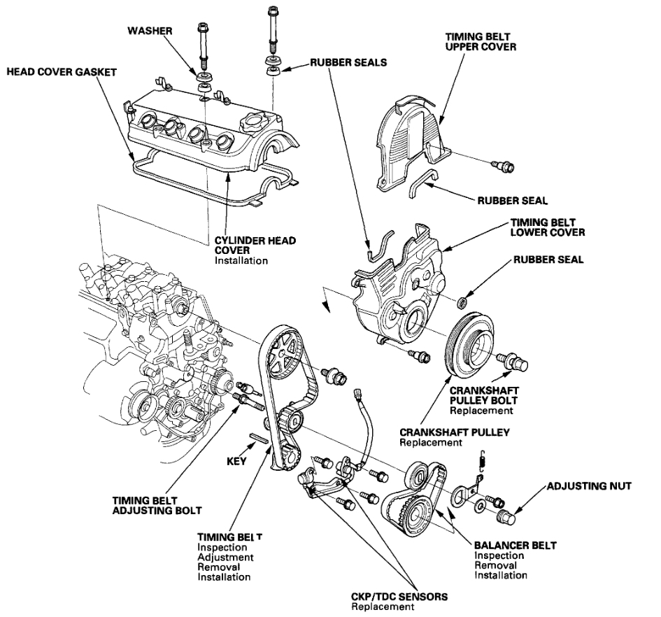

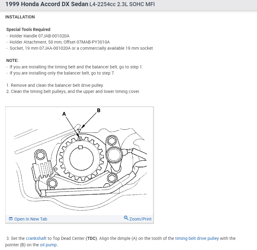

Take a look below. You will find the complete timing belt replacement procedure. Including all the markings and sequences.
This procedure is for the 2.3L Non-Vetch.
If you have the Vetch engine just let me know.
https://www.2carpros.com/articles/how-a-timing-belt-works

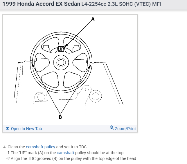

AMBI.SKYE
  • 21 POSTS

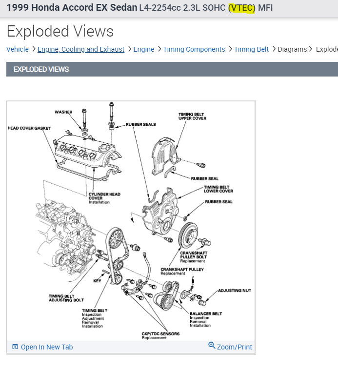

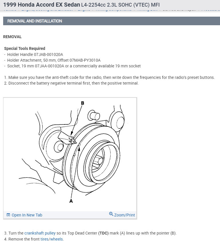

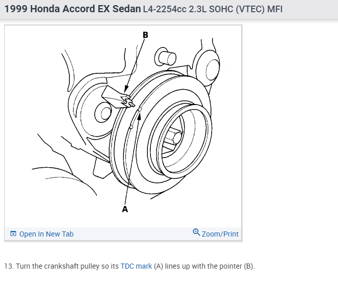

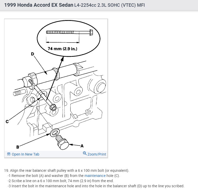

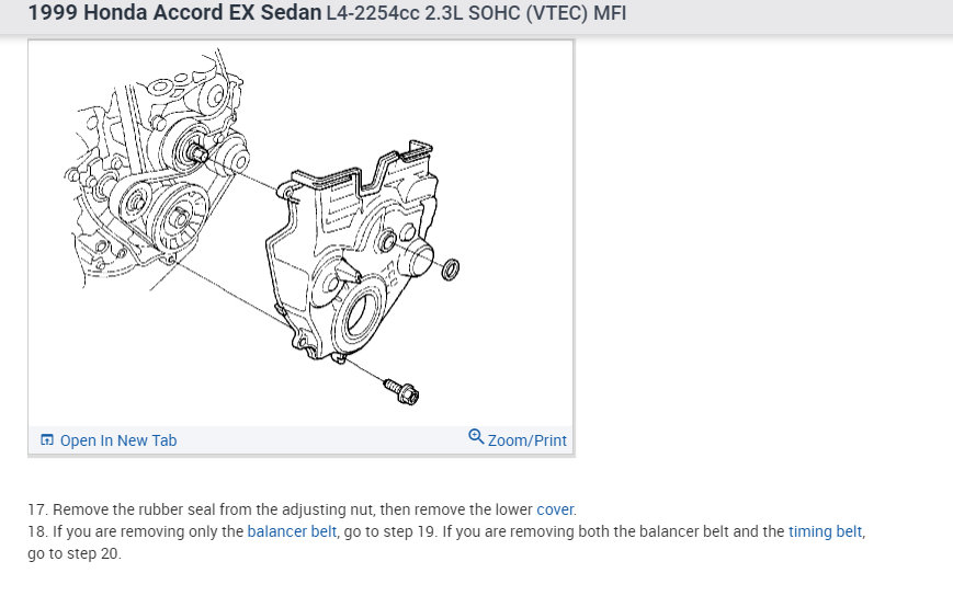

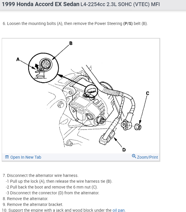

It is a Vetch motor.
Aug 29, 2022 at 2:43 PM

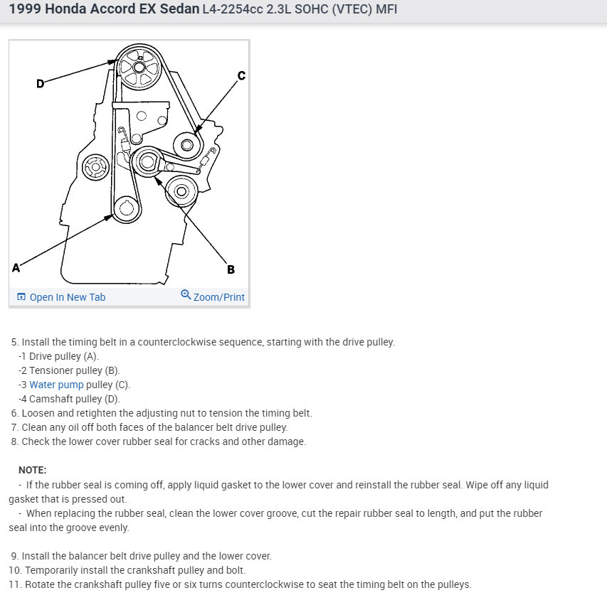

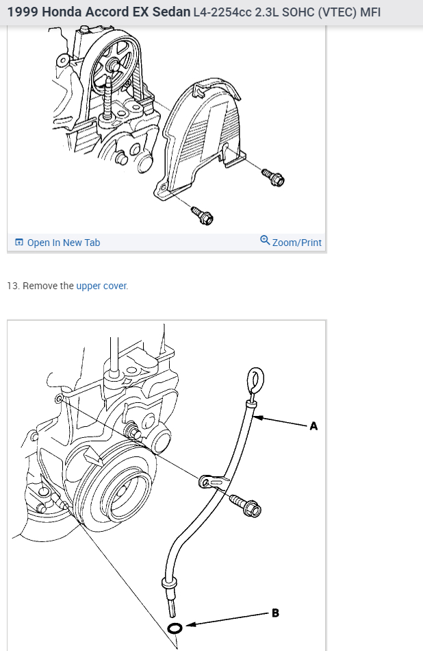

SQM
  • 6,383 POSTS

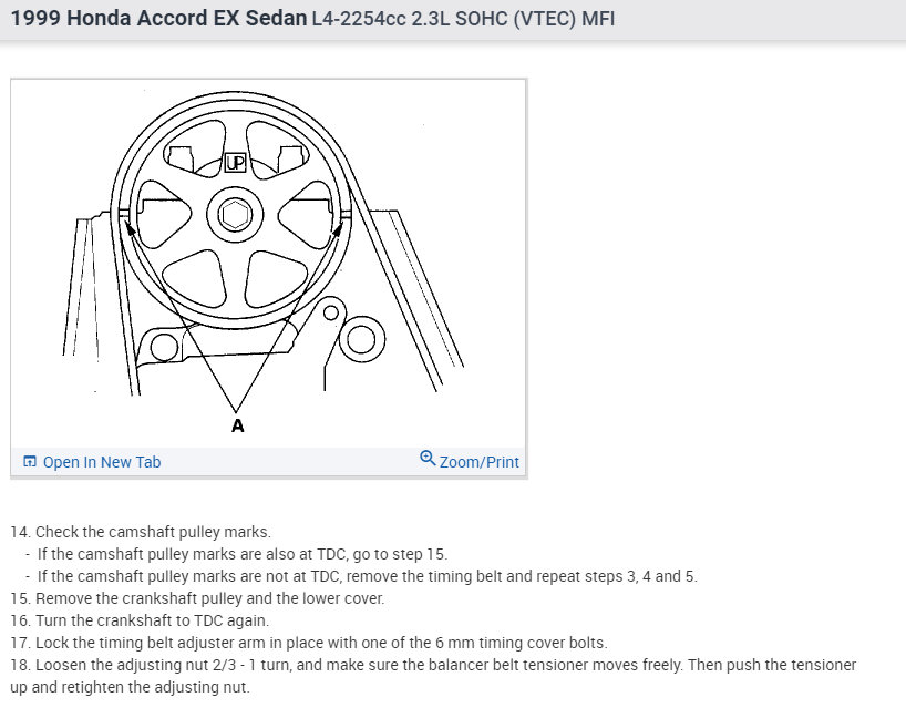

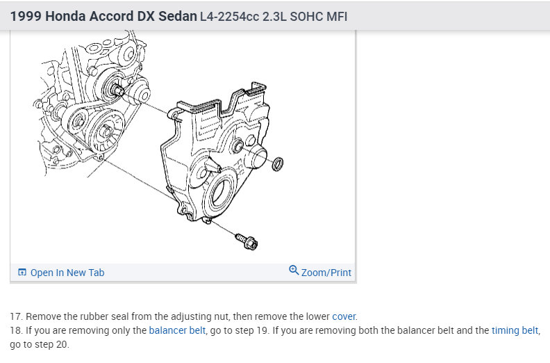

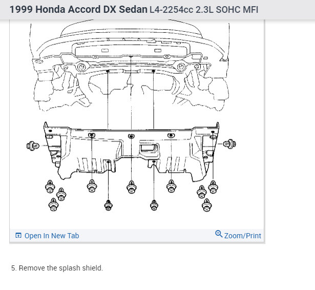

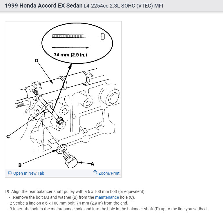

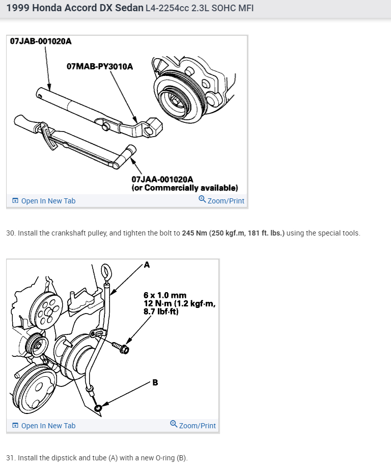

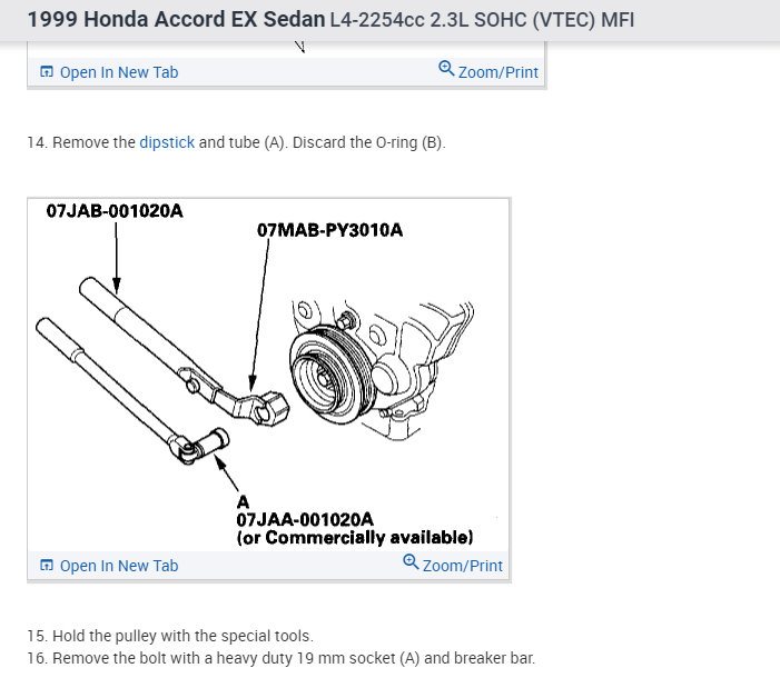

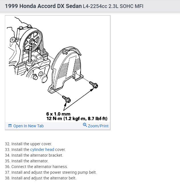

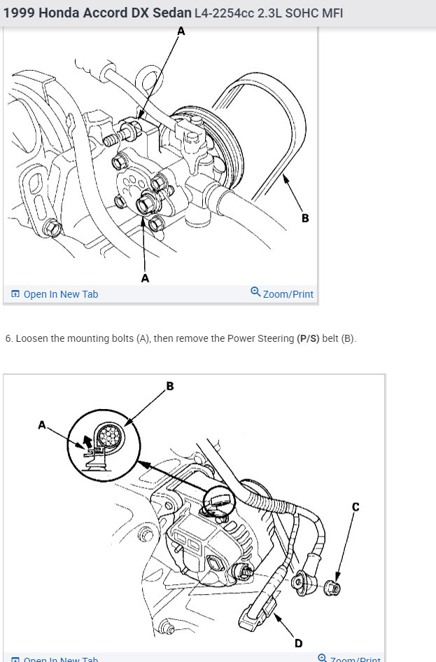

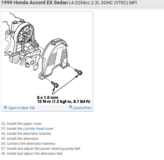

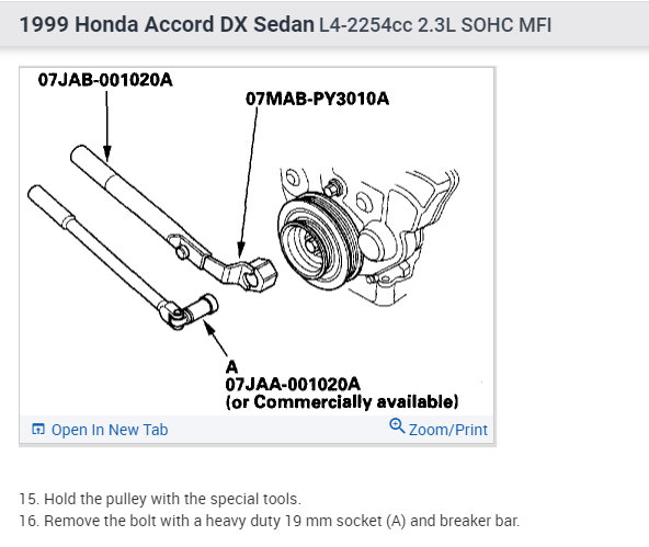

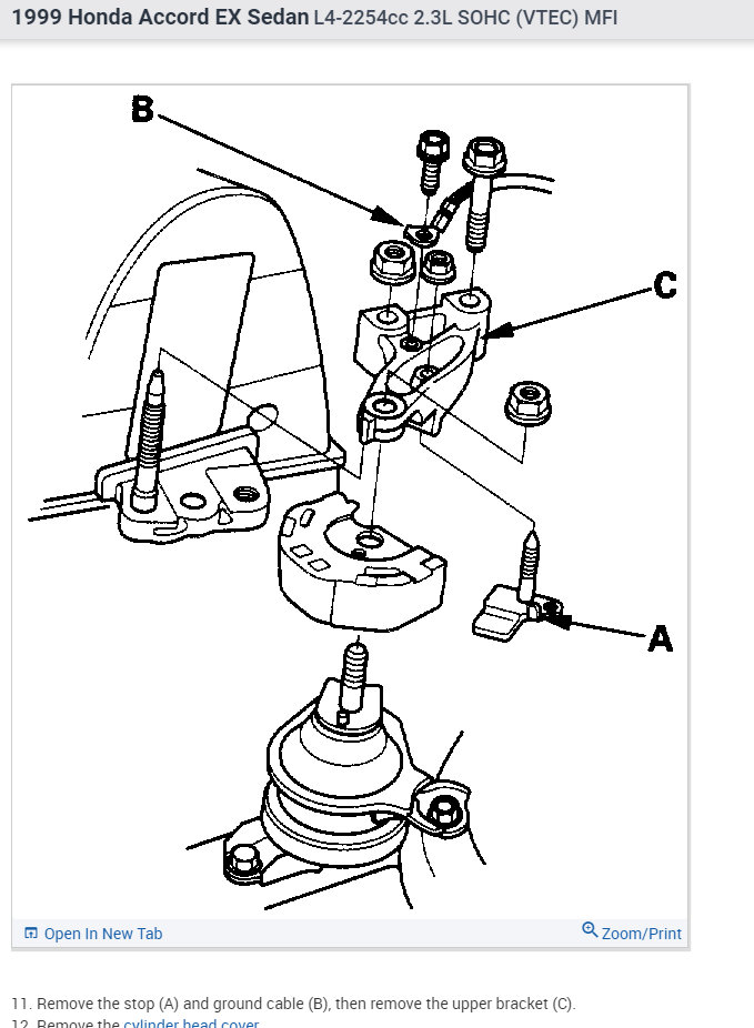

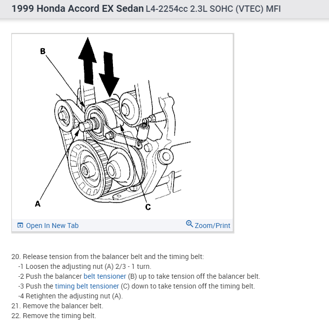

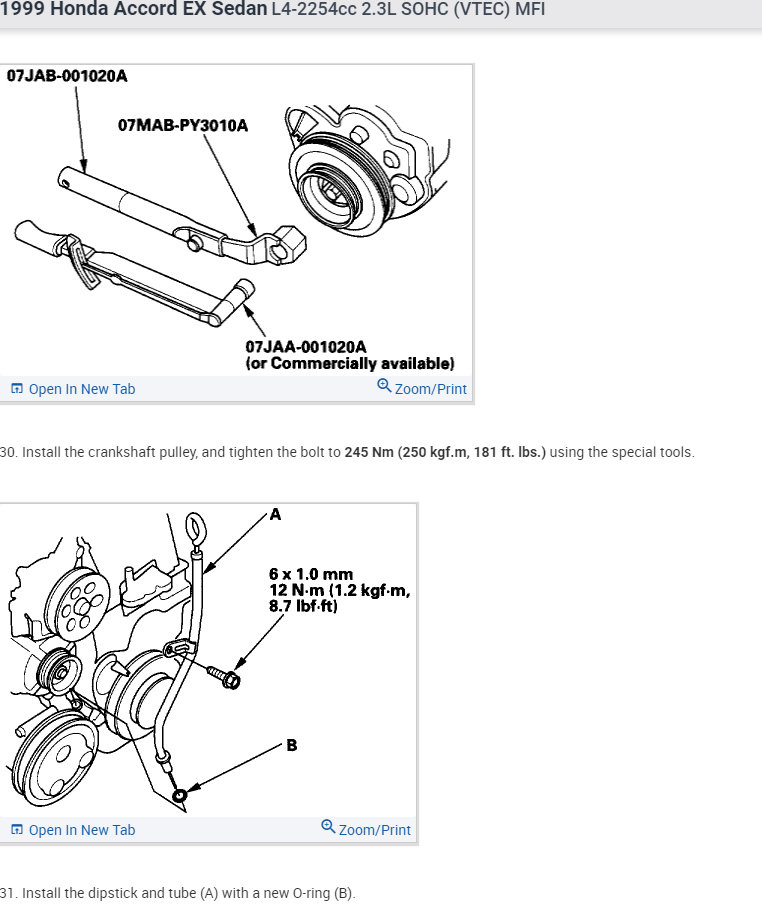

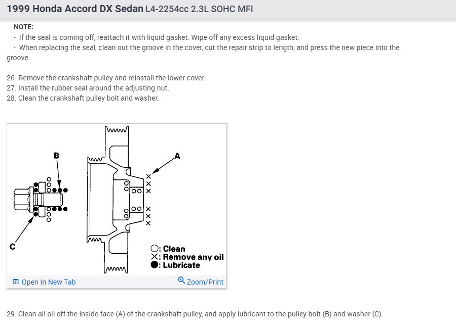

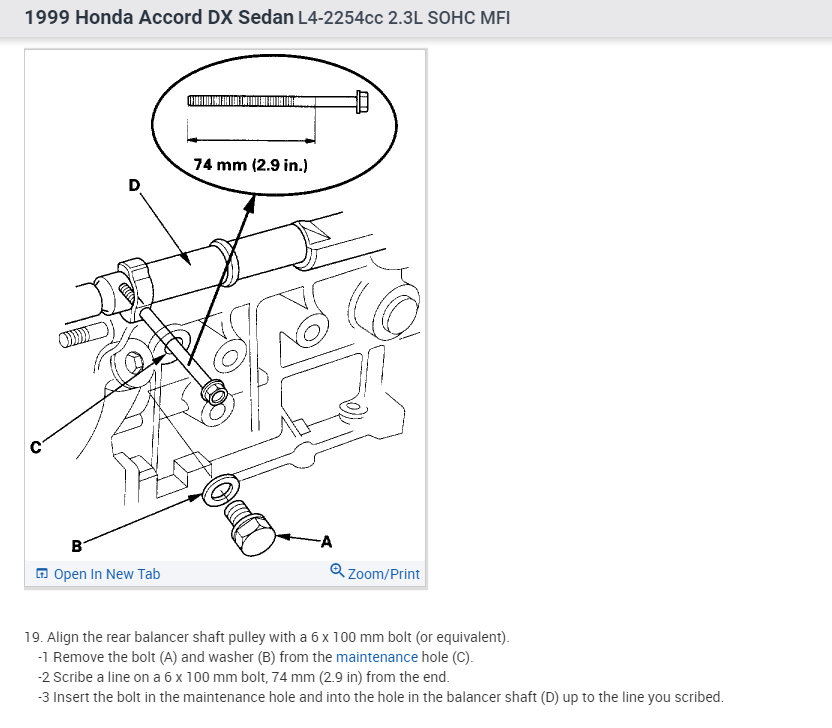

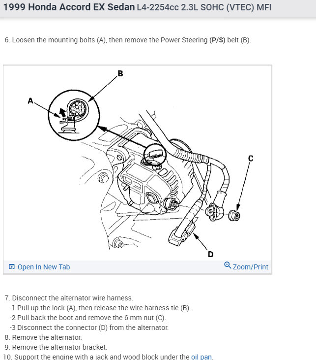

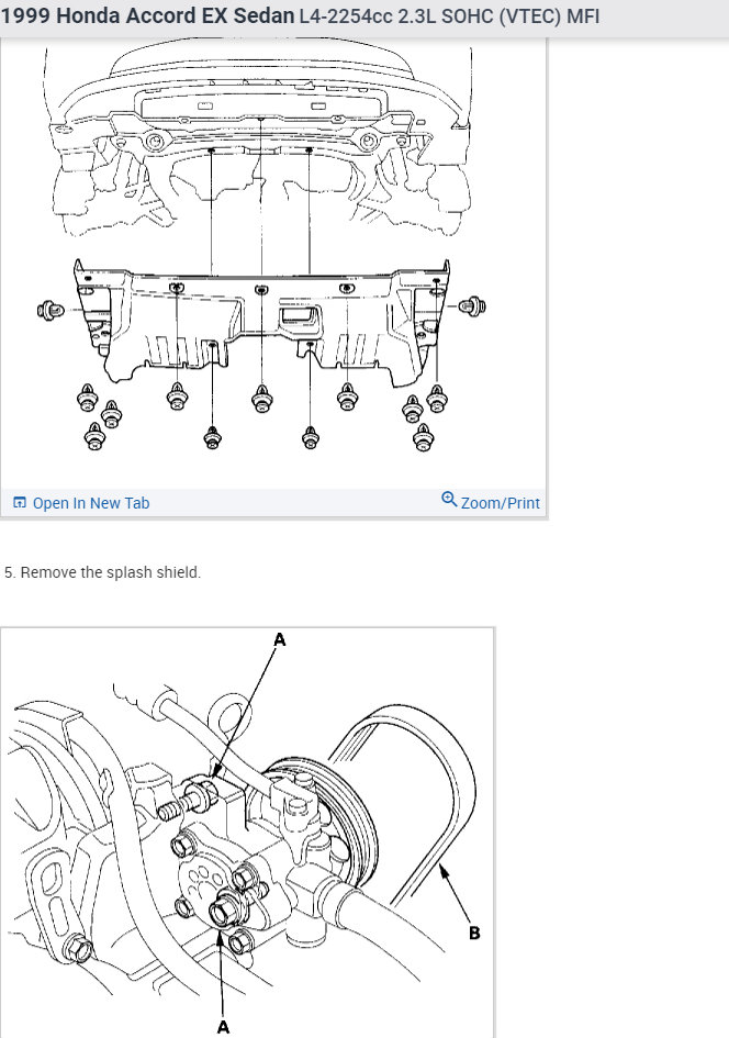

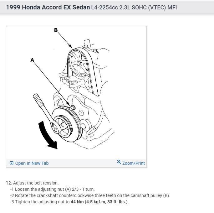

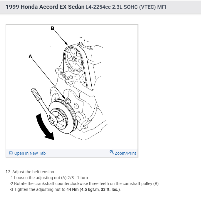

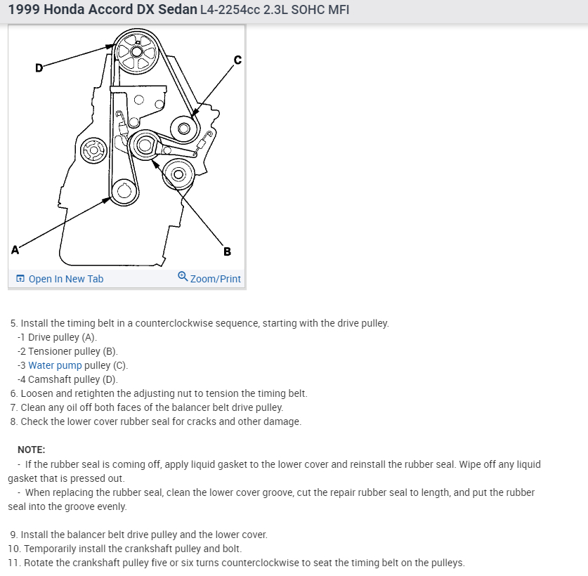

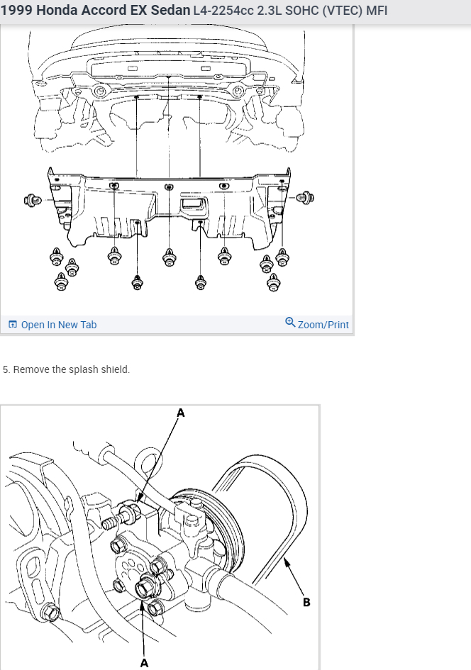

See attached for the VTEC timing belt instructions.
Aug 29, 2022 at 3:01 PM
AMBI.SKYE
  • 21 POSTS
Thank you!
