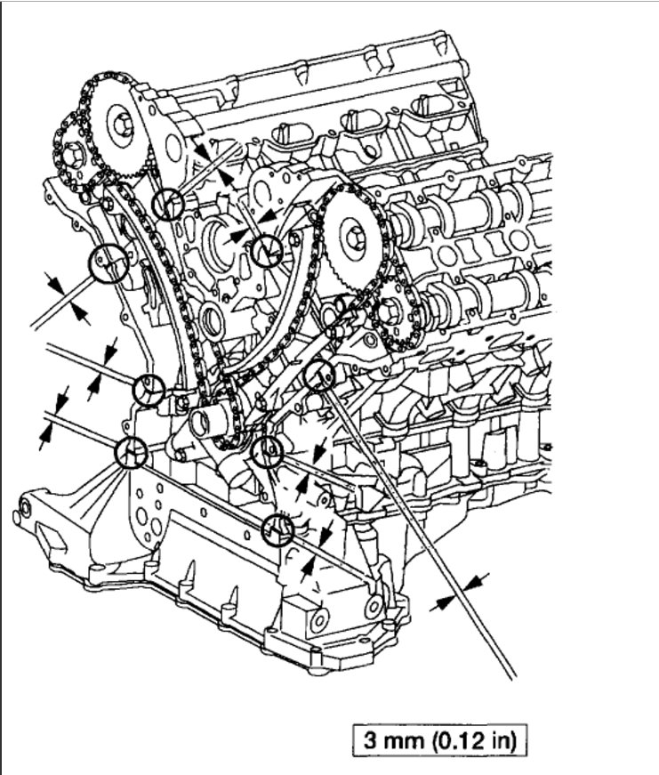

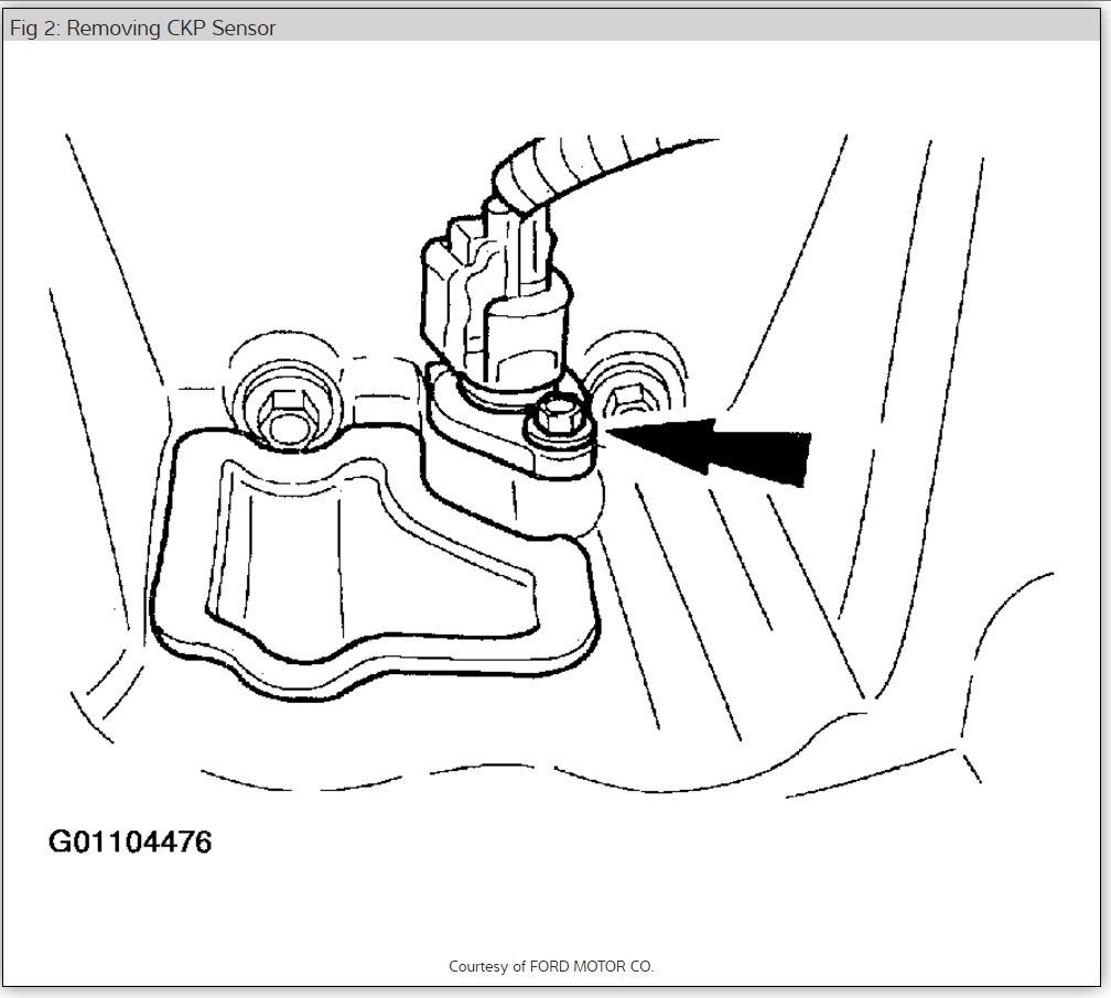

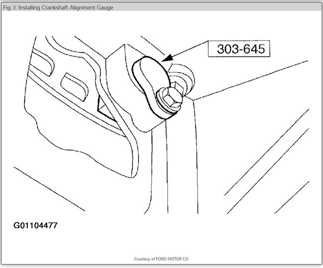

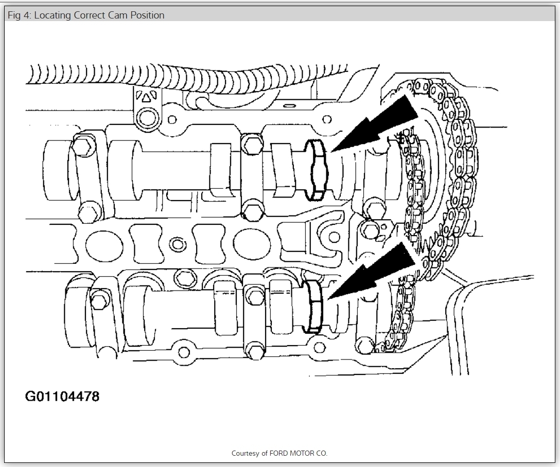

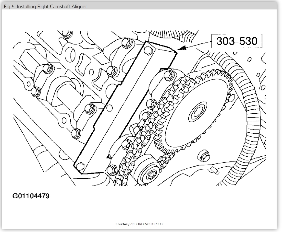

I took the right side head off to fix gasket, now I cannot figure out the timing there are no marks on the gears or chain. please help.

Hey Jeff,
I found this information for you.

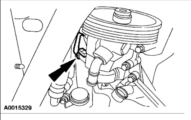

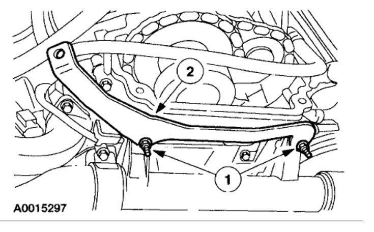

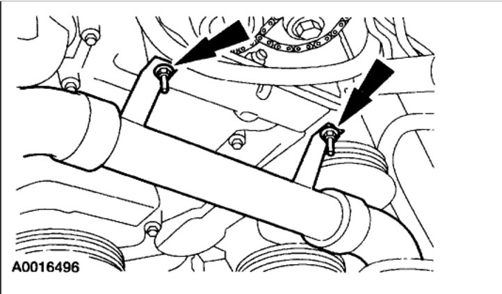

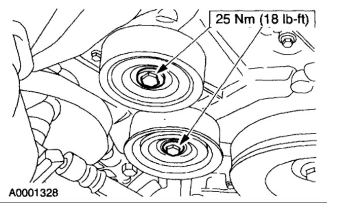

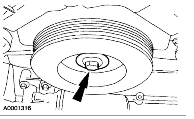

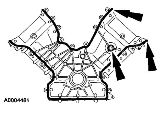

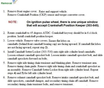

Remove the engine front cover. For additional information, see ENGINE FRONT COVER .
Raise the vehicle.

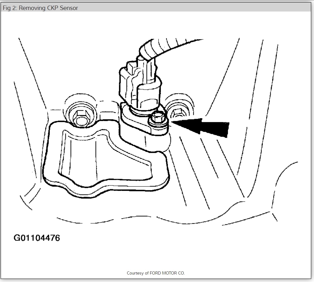

Remove the crankshaft position (CKP) sensor and the torque converter cover.
Fig 2: Removing CKP Sensor

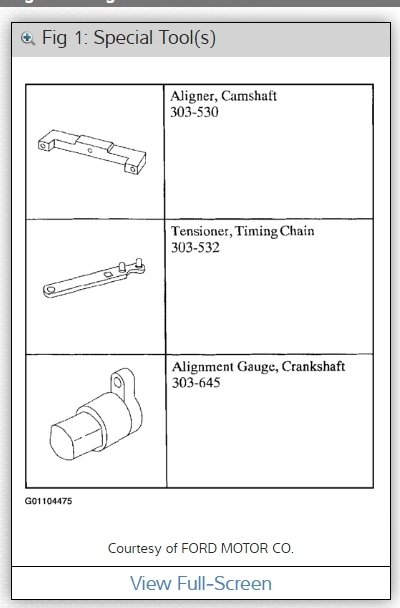

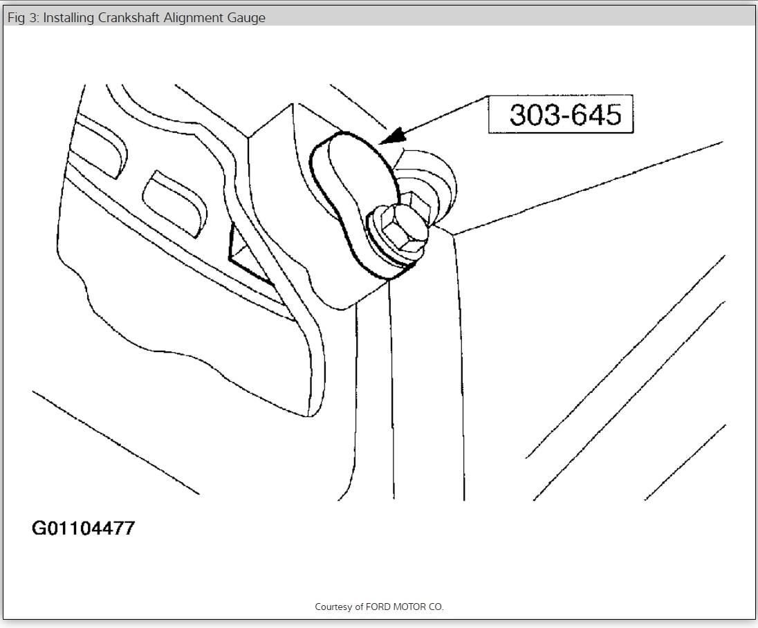

NOTE: There is one window on the ignition pulse wheel that is unique to accept the special tool.
Install the special tool.
Turn the crankshaft to 45 degrees ATDC. The crankshaft keyway will be in the 6 o'clock position.
Fig 3: Installing Crankshaft Alignment Gauge
Lower the vehicle.

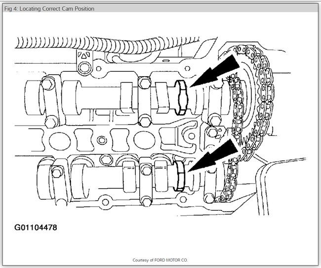

Make sure the lobes of the camshaft are facing upwards. If not, repeat Step 4.
Fig 4: Locating Correct Cam Position
Install the special tool on the RH cylinder head.
Fig 5: Installing Right Camshaft Aligner
CAUTION: An open-end wrench must be used on the flats of the camshaft or damage to the head will occur.
Loosen the exhaust camshaft sprocket bolt.

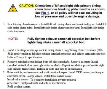

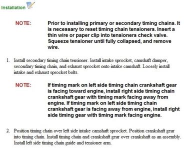

Installation

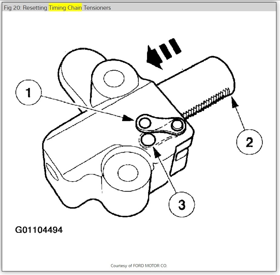

Reset the timing chain tensioners.
Hold the lever toward the tensioner piston.
Using finger pressure, compress the tensioner.
Push the lever down and install a drill rod to lock the piston.
Fig 20: Resetting Timing Chain Tensioners

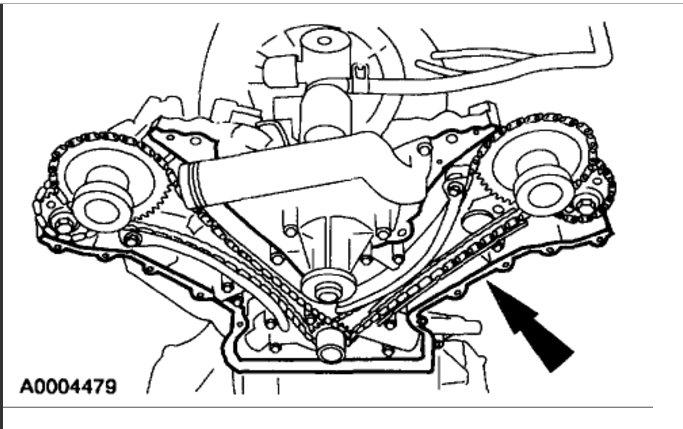

Position the LH timing chain and crankshaft gear.
Position the timing chain over the LH intake camshaft sprocket.
Position the crankshaft gear in the timing chain.
Position the timing chain and crankshaft gear over the crankshaft as an assembly.
Fig 21: Installing Left Timing Chain
Install the LH timing chain guide.
Fig 22: Installing Left Timing Chain Guide

Position the RH timing chain over the RH intake camshaft sprocket and over the crankshaft gear.
Fig 29: Installing Right Timing Chain
Install the RH timing chain guide.
Fig 30: Installing Right Timing Chain Guide

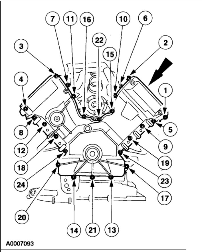

See images below,
Please let us know happens so it will help others.

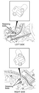

I have a 2001 lincoln ls that the secondary tensioners went. I Pulled valve covers and confirmed.. I ordered 2 new chains with master links and two new tensioners. I Cut the old chains off without lining up the motor with the special tools. I did not move the cams but this motor has no timing marks. Any idea how to make sure cams are in time with crank?
Jul 10, 2020 at 5:19 AM (Merged)
  • 110,240 POSTS
Here are the instruction to remove the timing cover, the marks are in the post above. Check out the diagrams (Below). Please let us know what happens.
NSCURO
Thank you i have that diagram.. Thats explaining if i was changing master chains as well.. I had a secondary chain failure and im not touching the main chains at all. my main timing is still untouched but my timing on the exhaust cams may be off im not sure.. From what ive seen and researched there is no timing marks on the cam gears.. Should i do it as if i was lining the whole motor up?
Jul 10, 2020 at 5:20 AM (Merged)
  • 110,240 POSTS
That is what I would recommend. I can't believe there are no marks. There may be a special tool or something. Ford has several of those.

BLUELIGHTNIN6
  • 16,542 POSTS
https://images.2carpros.com/forum/automotive_pictures/261618_Noname_2190.jpg
https://images.2carpros.com/forum/automotive_pictures/261618_Noname2_710.jpg
https://images.2carpros.com/forum/automotive_pictures/261618_Noname3_266.jpg
FIG. 1
https://images.2carpros.com/forum/automotive_pictures/261618_1_172.jpg
