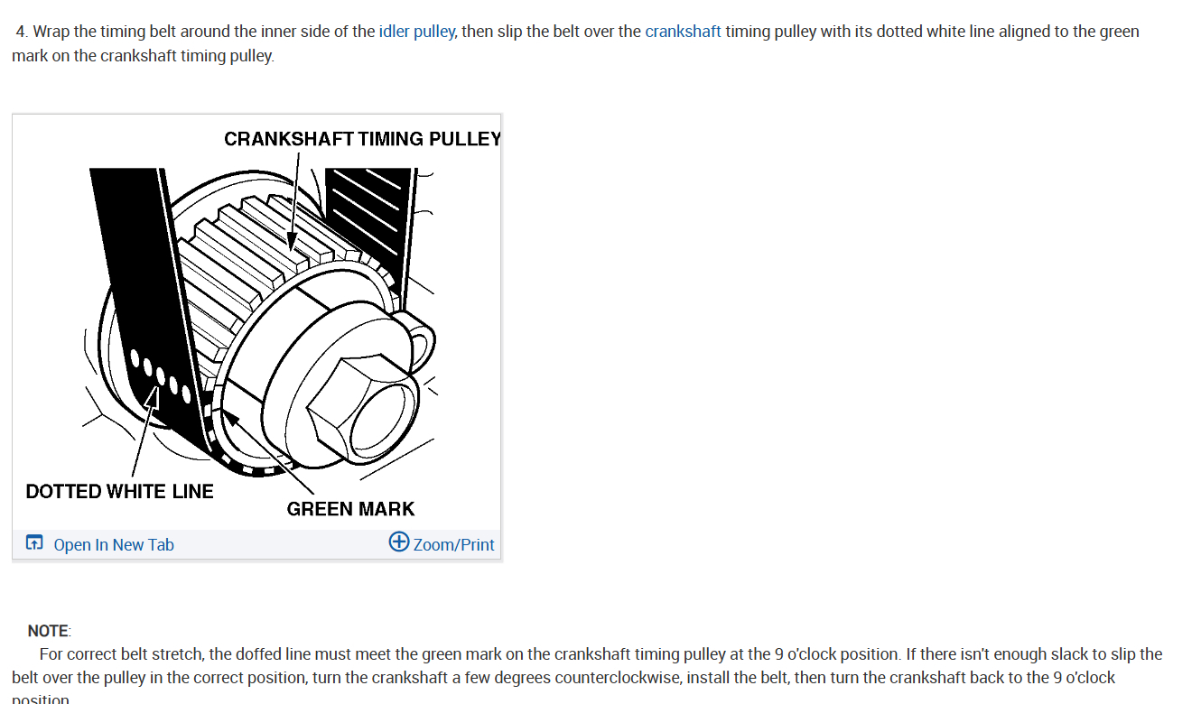

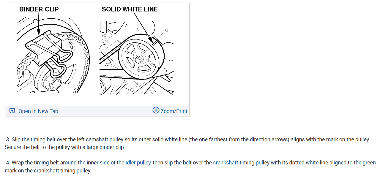

How is the timing mark supposed to be placed?
1999 ISUZU AMIGO
4,000 MILES
GLADYS00001

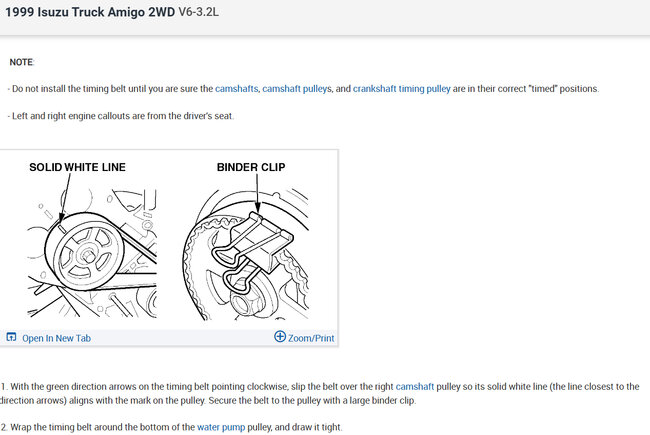

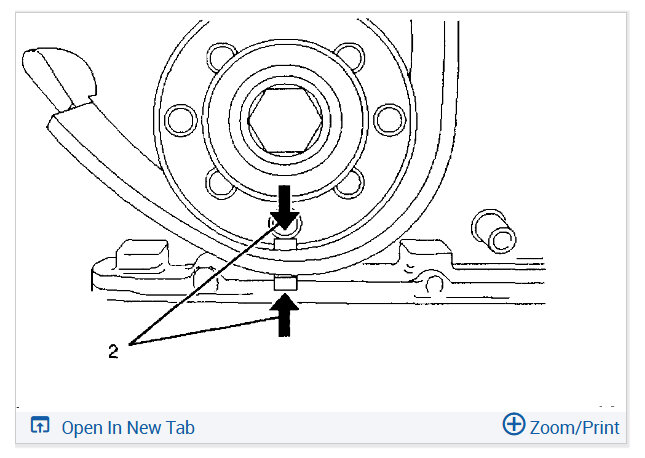

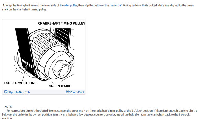

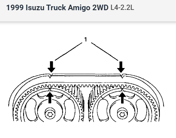

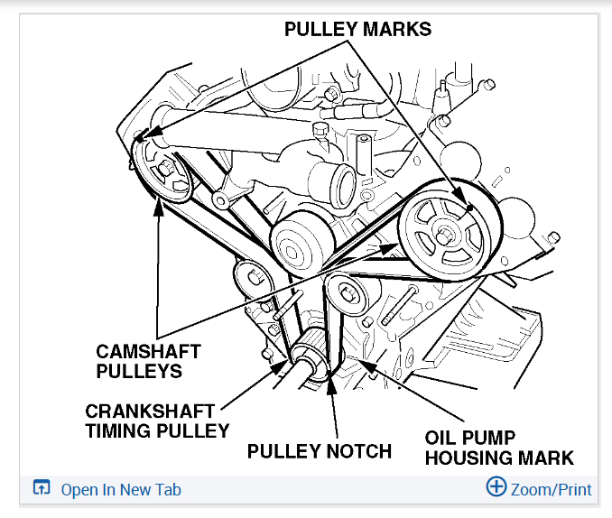

Please can I get a clear image and on how the timing belt is supposed to be placed on an Isuzu amigo engine?
Oct 24, 2024 at 10:13 PM
  • 55,433 POSTS
Sure, these came with two engines, the 4 and 6 cylinder which I have included both engine's timing belt marks. Check out the images (below). Let us know if you need anything else.
