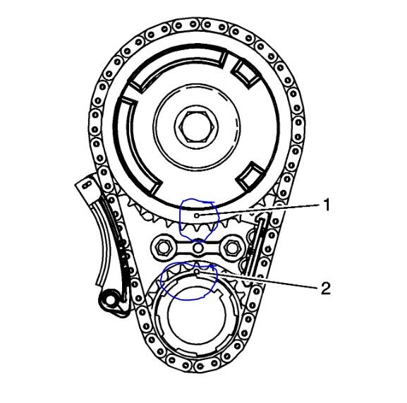

Can you please tell me the marks for the timing chain?
May 28, 2020 at 10:02 PM
Good morning,
I attached a picture for you of the marks.The cam gear, the mark is at 6 o'clock. The crank gear mark is at 12 o'clock. Let me know if you have any other questions. Check out the diagrams (Below). Please let us know if you need anything else to get the problem fixed.

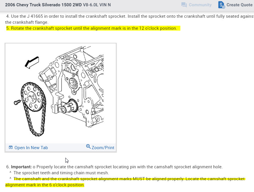

I'm trying to change my timing chain and sprockets but when the camshaft and crankshaft marks are at the 6 and 12 o'clock position the #1 piston is not at the compression TDC. When it is at TDC the camshaft and crankshaft are both at the 12 o'clock position. How do I fix this? Or when removing the chain and camshaft sprocket does it matter if the #1 piston is at the compression TDC? Everything I've read says it does. Help.
Aug 21, 2020 at 12:32 PM (Merged)
Hi.
You are to set the crank and cam so they line up 6 and 12 o'clock. Don't worry about #1 TDC. The crank has a key on it and the cam has a specific bolt pattern to ensure they are timed.
You really only need to worry about #1 TDC when installing a distributor if equipped. This way you get the #1 plug to fire on TDC.
Due to having the crank key way and bolt pattern, it allows you to only align them one way and you need to have them lined up when removing the chain and sprockets and then do not make a crank or cam rotation with the chain off or you will be out of time and the engine will be damaged. It is okay if they move a little because you can just line them back up but if they make a rotation then you will be in trouble.
Here is the detail about how to do it. As you see the book doesn't mention anything about TDC.
Let me know if you need anything else. Thanks
