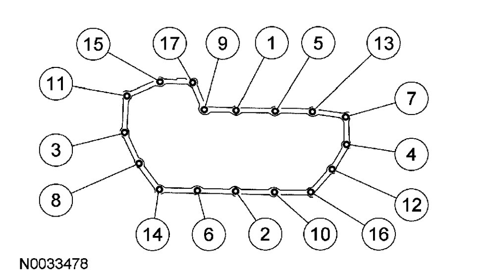

4. Remove the 17 bolts and the oil pan.
^ Discard the gasket.
Installation
1. CAUTION: Do not use metal scrapers, wire brushes, power abrasive discs or other abrasive means to clean the sealing surfaces. These tools cause scratches and gouges, which make leaks paths. Use a plastic scraping tool to remove all traces of sealant.
Clean the gasket sealing surfaces.
2. NOTE: Make sure all gasket sealing surfaces are clean and dry.
imageZoom/Print
Install a new oil pan gasket, oil pan and 17 bolts.
^ Tighten the bolts in the sequence shown in two stages.
- Stage 1: Tighten to 5 Nm (44 inch lbs.).
- Stage 2: Tighten to 12 Nm (9 ft. lbs.).
