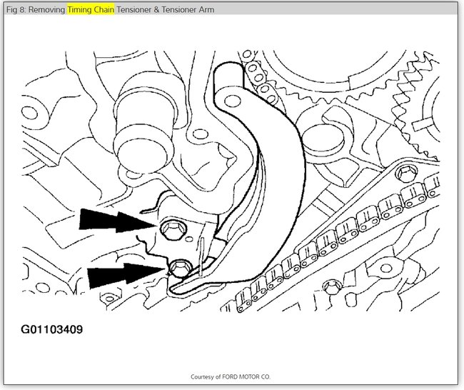

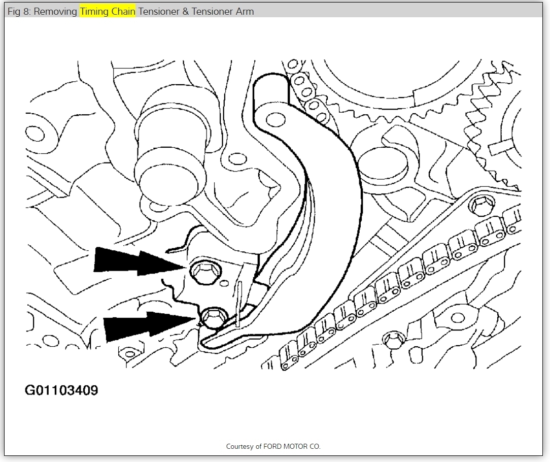

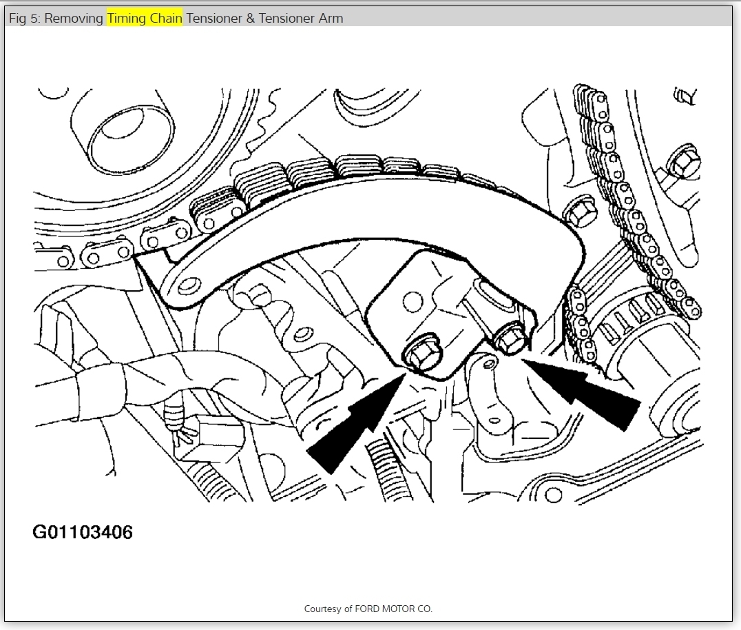

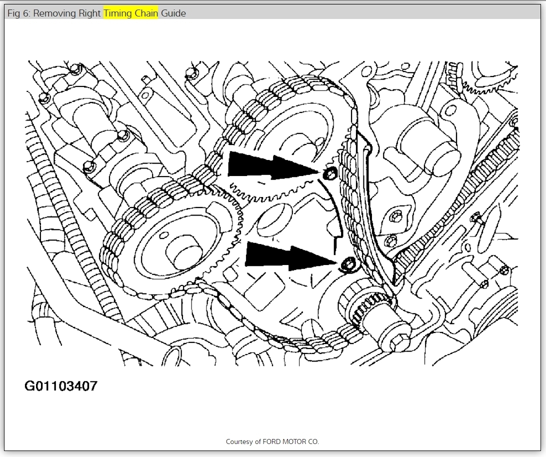

I would like to replace the whole timing kit, but I have not found one that matches up with my original ones off the block, O'Reilly set me cloyoes kit and the guide's were too long and the holes did not line up or the shape of the guides. please, please help in pointing me in the right direction. some say it could be from a 2000 ls that would fit my car, but I do not know.

About all I can tell you is it sounds like they sold you the wrong kit. Let them do some research on how that happened.

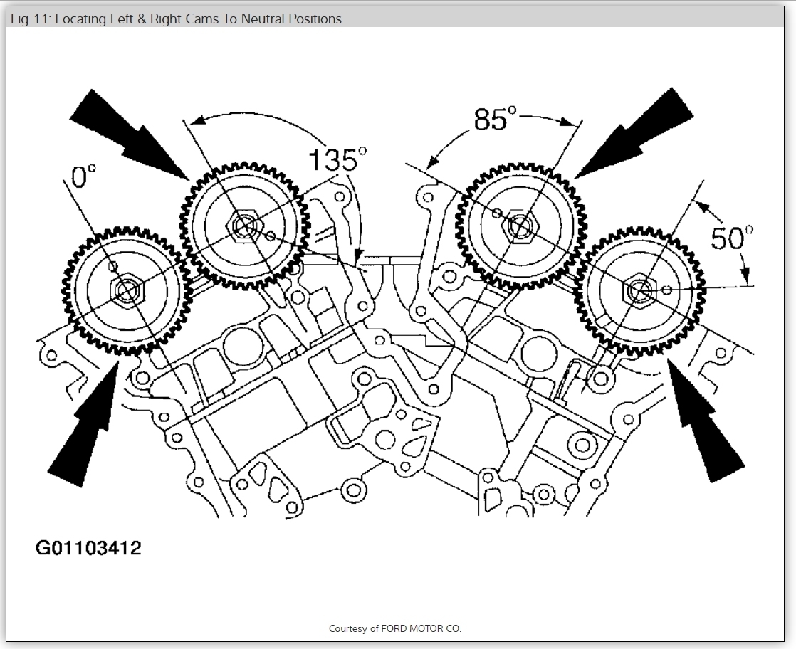

Here is the instructions for doing that, the best place to get the parts is from the dealer. Try to mark the cams before you take it apart.

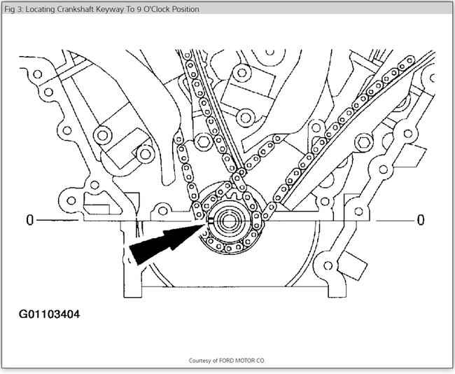

Verify that the crankshaft keyway is in the nine o'clock position.
Fig 10: Verifying Crankshaft Keyway Is In 9 O'Clock Position
CAUTION: The crankshaft keyway must remain in the nine o'clock position until the cams are located, or damage to the valves may occur.

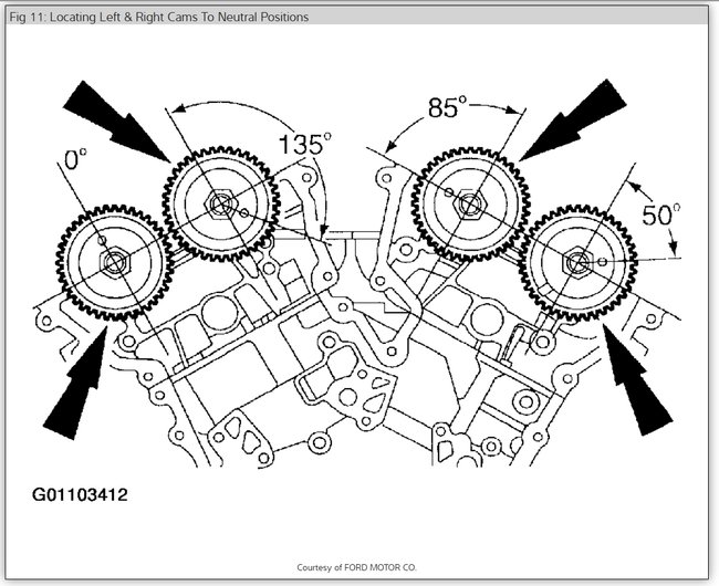

Rotate the LH and RH intake and exhaust camshafts to locate them in their neutral positions.
Fig 11: Locating Left & Right Cams To Neutral Positions

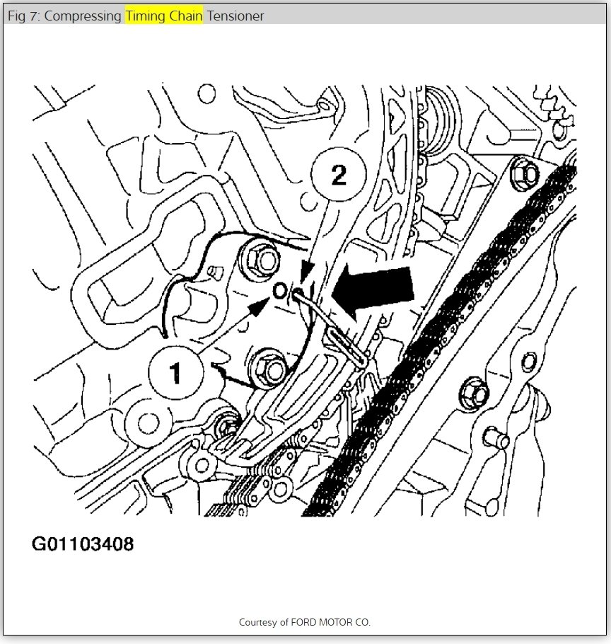

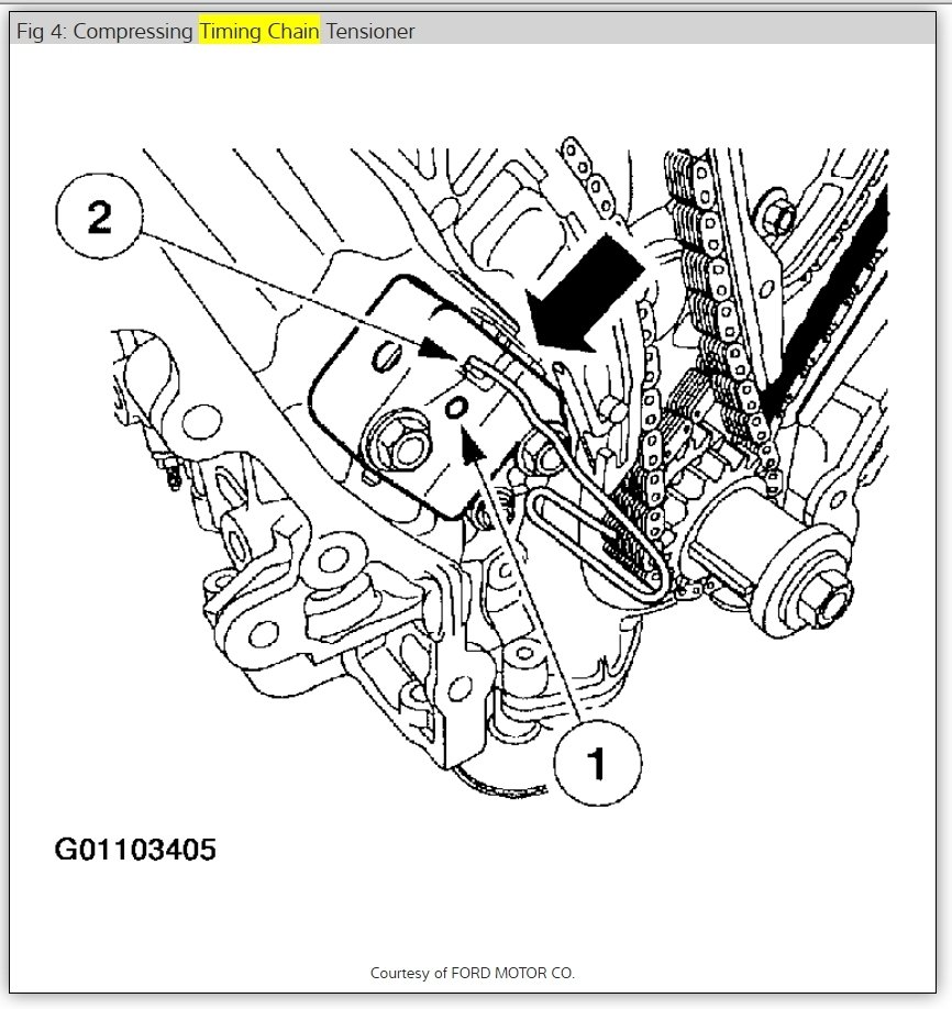

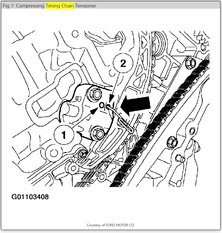

NOTE: Be sure to position the tensioner so that the tensioner piston is fully engaged in the tensioner arm.
Install the LH tensioner arm, tensioner and bolts.
Fig 15: Install Left Tensioner Arm & Tensioner
Remove the wire or paper clip from the tensioner.
Fig 16: Removing Wire From Tensioner

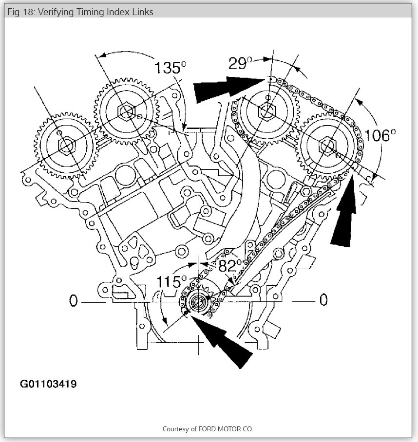

Verify that the timing index links (gold color) on the LH timing chain are in alignment with the timing index marks on the camshaft and crankshaft sprockets.
Fig 18: Verifying Timing Index Links

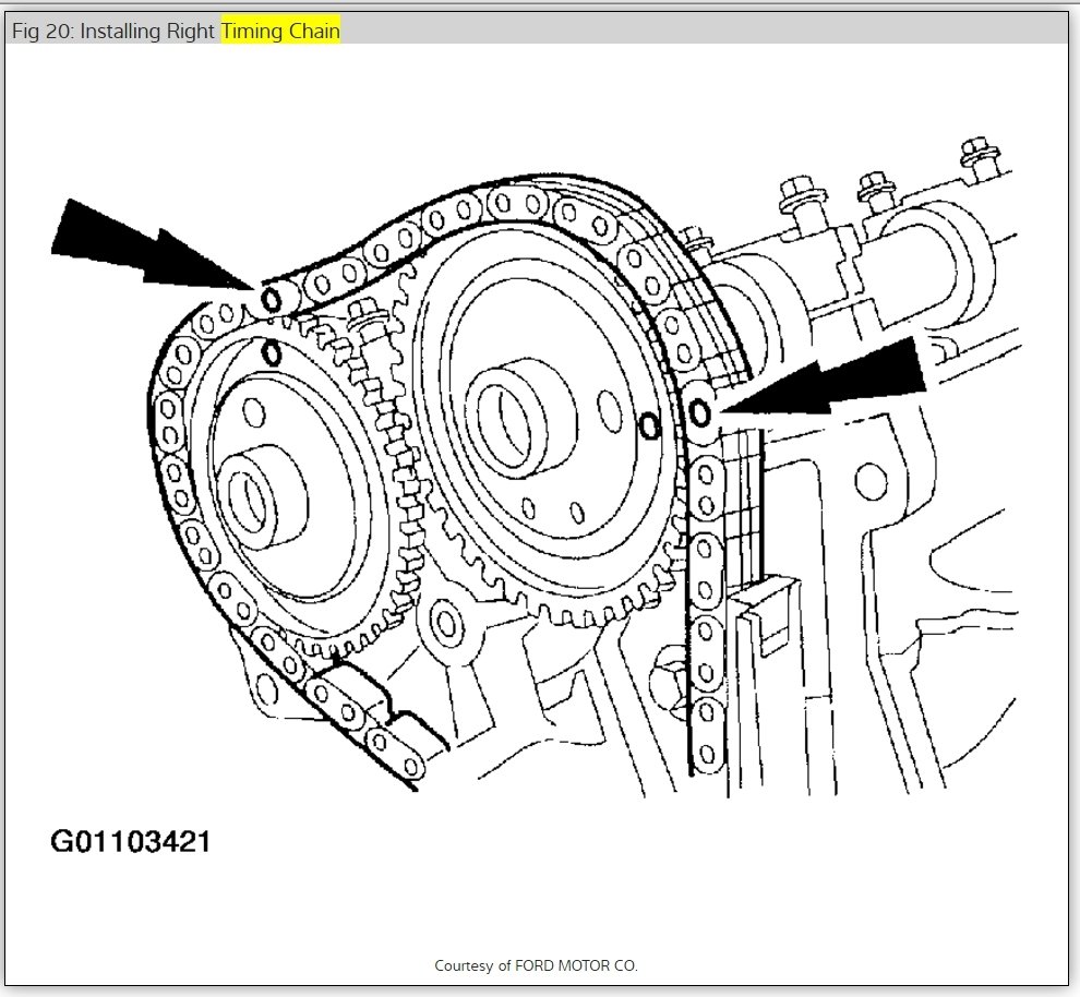

Install the RH timing chain, aligning the timing index links (gold color) with the marks on the camshaft and crankshaft sprockets.
Fig 20: Installing Right Timing Chain

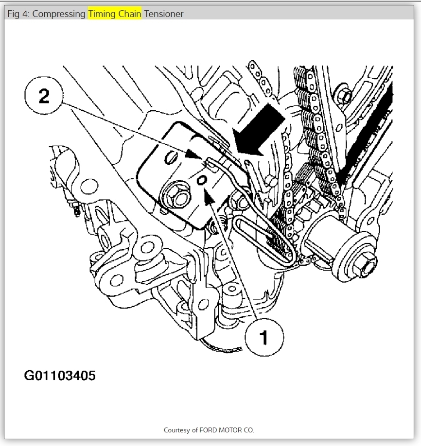

Remove the wire or paper clip from the RH tensioner.
Fig 22: Removing Wire From Right Tensioner
Verify that the timing index links (gold color) on the RH timing chain are in alignment with the timing index marks on the camshaft and crankshaft sprockets.
Fig 23: Verifying Timing Index Links On Right Timing Chain

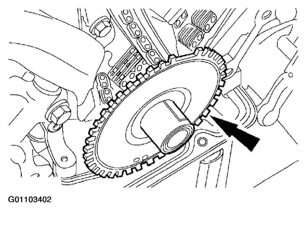

Install the ignition pulse ring.
Fig 25: Installing Ignition Pulse Ring

im looking into getting jaguar guides off a 2000-2001 would those fit cause all the kits ive order the guides are what are not matching up to my 02'Lincoln ls v6

Its hard to say, I would get the kit from the dealer, please let us know how it goes so it will help others
