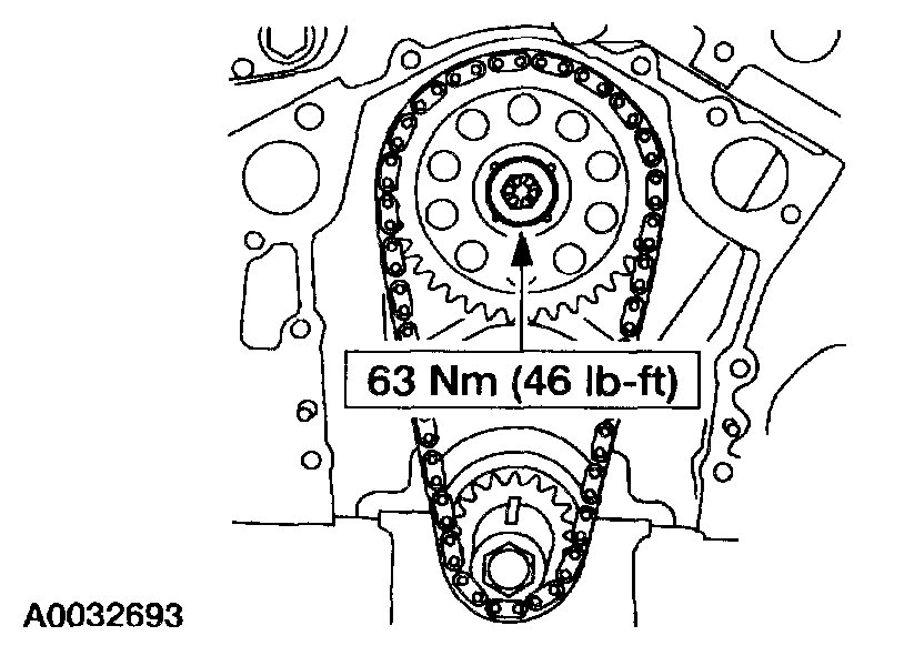

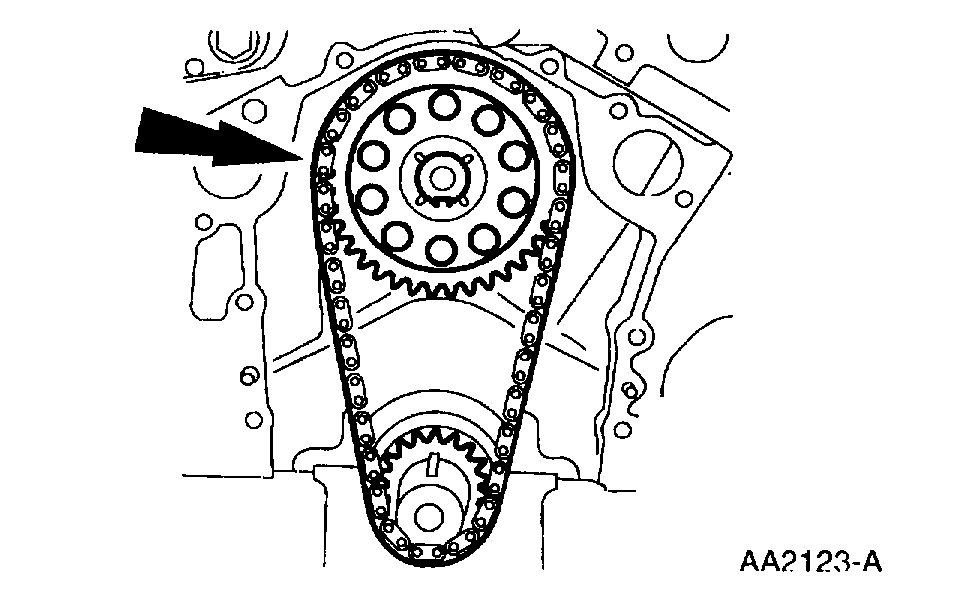

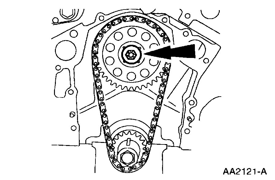

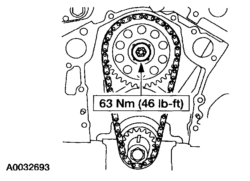

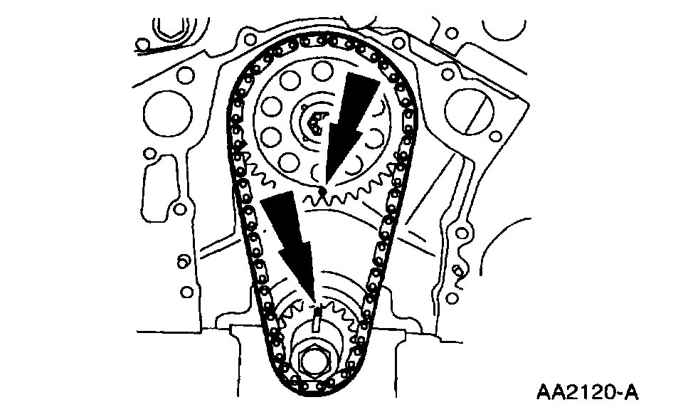

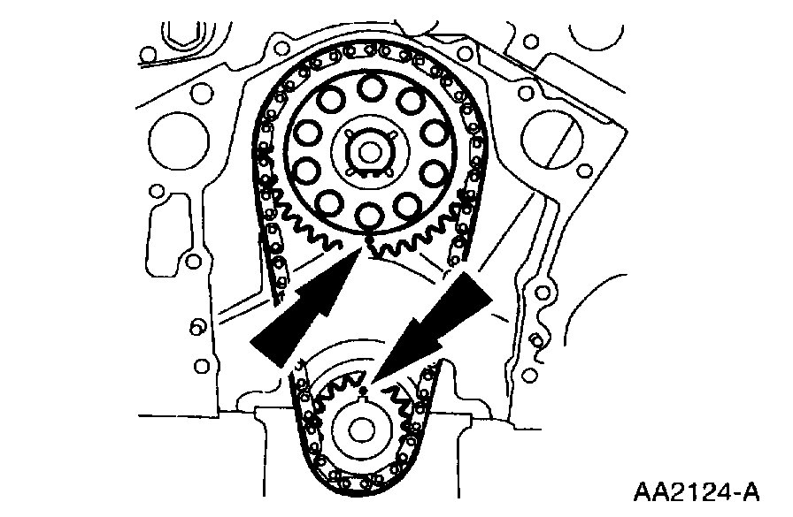

Before removing the chain, you should align the timing marks. Here are the directions specific to your vehicle for replacing the timing chain. It is a straight forward job. All attached pictures correlate with these directions.
__________________________
Timing Chain
Removal
1. Disconnect the battery ground cable.
2. Remove the engine front cover.
3. Rotate the crankshaft and align the timing marks.
4. Remove the bolt.
5. Remove the timing chain, the camshaft sprocket and the crankshaft sprocket as an assembly.
Installation
1. Align the timing marks.
2. Install the timing chain, the camshaft sprocket and the crankshaft sprocket as an assembly.
3. Install the bolt.
4. Install the engine front cover.
5. Connect the battery ground cable.
_______________________________________

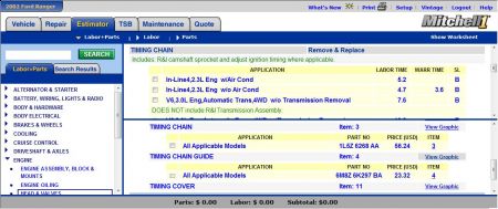

My ranger is making a rattling noise, especially at low speeds. After taking it to dealer, their diagnosis is the timing chain gear needs to be replaced. Is this normal at this mileage? What should the average cost for the repair be?
Nov 12, 2020 at 2:44 AM (Merged)
  • 75,992 POSTS
Labor rate per hr could range from $70.00-$130.00 and varies with location see below quotes

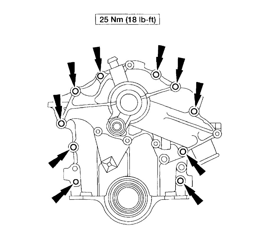

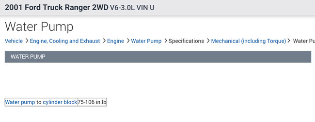

What would be the recommended product to use to coat the threads of water pump and timing cover bolts when installing pre-cut gaskets such as Fel-Pro? Would it be Blue/Red threadlocker, PTFE thread sealant, anti-sieze compound, or something else?
SCGRANTURISMO
  • 4,897 POSTS
You really shouldn't have to put anything on these bolts, but if you are going to put something on them, I would recommend anti seize compound. I hope this helps.

Hello, I'm Danny.
I would suggest none! There is no reason to use anything on the bolt threads. You can use a small amount of silicone RTV on the gaskets/mating surfaces but no reason to use anything on the bolt threads.Hope this helps and thanks for using 2CarPros.

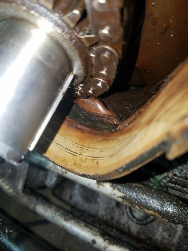

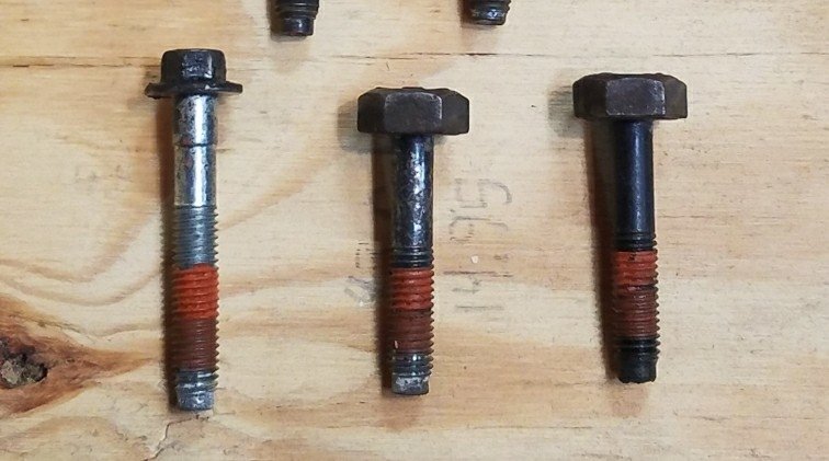

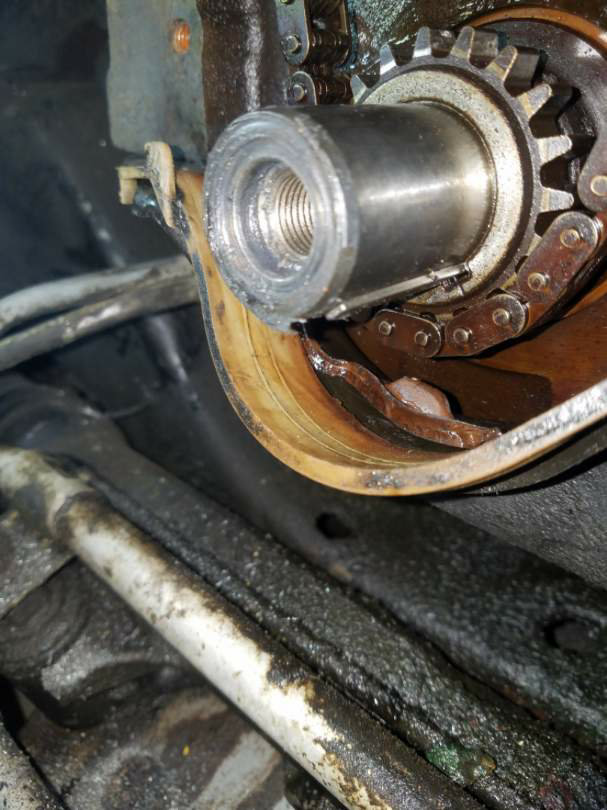

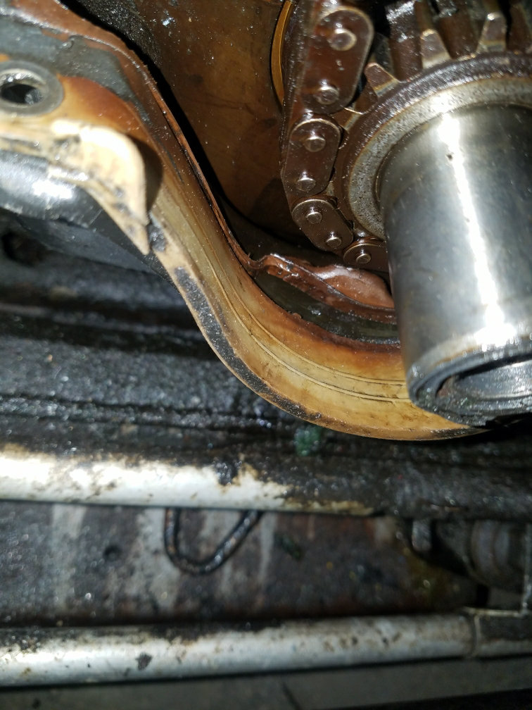

RDANNENFELSER
  • 43 POSTS
The three bolts in the photo with the red substance on the threads are the three lowest bolts that pass only through the timing cover and bolt to the block. They do not pass through the water pump housing.
While I couldn't say with certainty that the red substance on those threads is a threadlocker, it definitely isn't just rust.
Nov 12, 2020 at 2:45 AM (Merged)

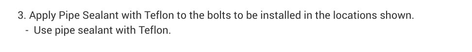

SCGRANTURISMO
  • 4,897 POSTS
Hello again,
Did you have a chance to read my last diagrams that I sent. The third one states that you should use pipe sealant with teflon on the bolts in diagram 4. This is straight from the vehicle manufacturer.
Thanks,
Alex
2CarPros

DANNY L
  • 5,648 POSTS
Hello again.
That reddish/orange coating is actually a type of sealer/thread-lock that was applied to the bolts when new. If you don't plan on using new bolts to reinstall I would say those are still good to be used.Hope this helps and thanks again for using 2CarPros.
Danny-

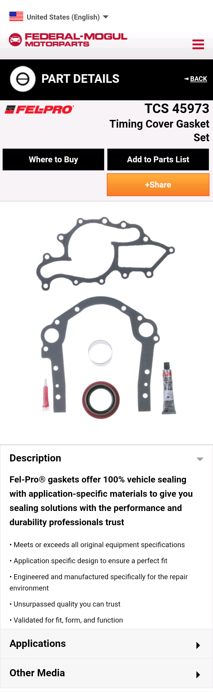

RDANNENFELSER
  • 43 POSTS
Thank you for all the information. Making a selection gets confusing with the wide variety of sealant/maker products available out there.
I totally understand the importance of a clean surface for gasket application and definitely will not half-ass the surface prep during this repair.
I'm planning to use pre-cut Fel-Pro timing cover/water pump gaskets from a set I purchased from O'Reilly Auto Parts. The Fel-Pro item number for that set is TCS 45973 and attached is an image.
I actually called the Fel-Pro technical support phone number and spoke with someone regarding the instructions for application of the gaskets and use of the included black RTV silicone. The person I spoke with told me that both the timing cover and water pump gaskets should be applied dry with the black RTV silicone ONLY being used at the lower section where the timing cover gasket meets the oil pan gasket.
While I'm not disregarding the manufacturer instructions, I wanted to ask if you'd recommend following them exactly or if you'd do anything different?
Also, if I do install the gaskets dry as instructed, what are your thoughts on using a aerosol spray gasket tack adhesive just to mist the gasket surfaces to help them stay in place during installation?

CARADIODOC
  • 34,381 POSTS
I never used the mist-type of products but I don't see a problem with that idea. If the gasket feels like felt, I wouldn't worry about it squirting out. That material does a better job of sealing into scratches and conforming to them, so it's true, additional sealants aren't necessary. If I was watching a coworker do this repair, I wouldn't argue for or against them using additional sealant with the gasket. We tend to stick with what we've had good luck with in the past.
Their comment about using a small dab of sealant at corners is a common and accepted practice because it is unlikely a fiber gasket is going to stretch to fill the voids when it is compressed. This is common with two-piece valve cover gaskets too.
When you stick the gasket in place, stick it to the engine, then put the cover on. That way you can insure the gasket stays in place. If you stick it to the cover first, there could be things on the engine that bump the gasket out of place as you put the cover on. You likely won't see that happen.
A related place where I've run into minor trouble is when a gasket is cut wider in one area compared to the original gasket. Look around the sealing surface on the engine, and often you'll see little bolted-on housings, covers, or brackets that interfere with the new, wider gasket. Sometimes you have to trim the gasket a little, and sometimes the edge of it will just be lifted, or held up a little, but it doesn't get hit by the cover. You'd see that when you stick the gasket to the engine first, then you can decide if it needs attention or if you can just slide the cover on and let the gasket bend up in that area. That obstruction would cause more of a problem if you stuck the gasket to the cover first. It could push the gasket off-center as you slide the cover in place.
Sometimes a new gasket will have some of the bolt holes smaller in diameter than the rest. You'll usually find this with transmission pan gaskets. There's too many areas to keep an eye on when you slap the pan in place, so those smaller holes will hold the pan bolts in place to hold the gasket from sliding out of place. If your timing cover gasket is set rather deep in the engine where it's hard to poke your fingers, you may have to put the gasket on the cover first. When that is expected, the gasket manufacturer may also use those smaller holes for you to use some of the bolts to hold the gasket. I'd trust the bolts a lot more than sealants from a tube or spray-on gasket glues.
