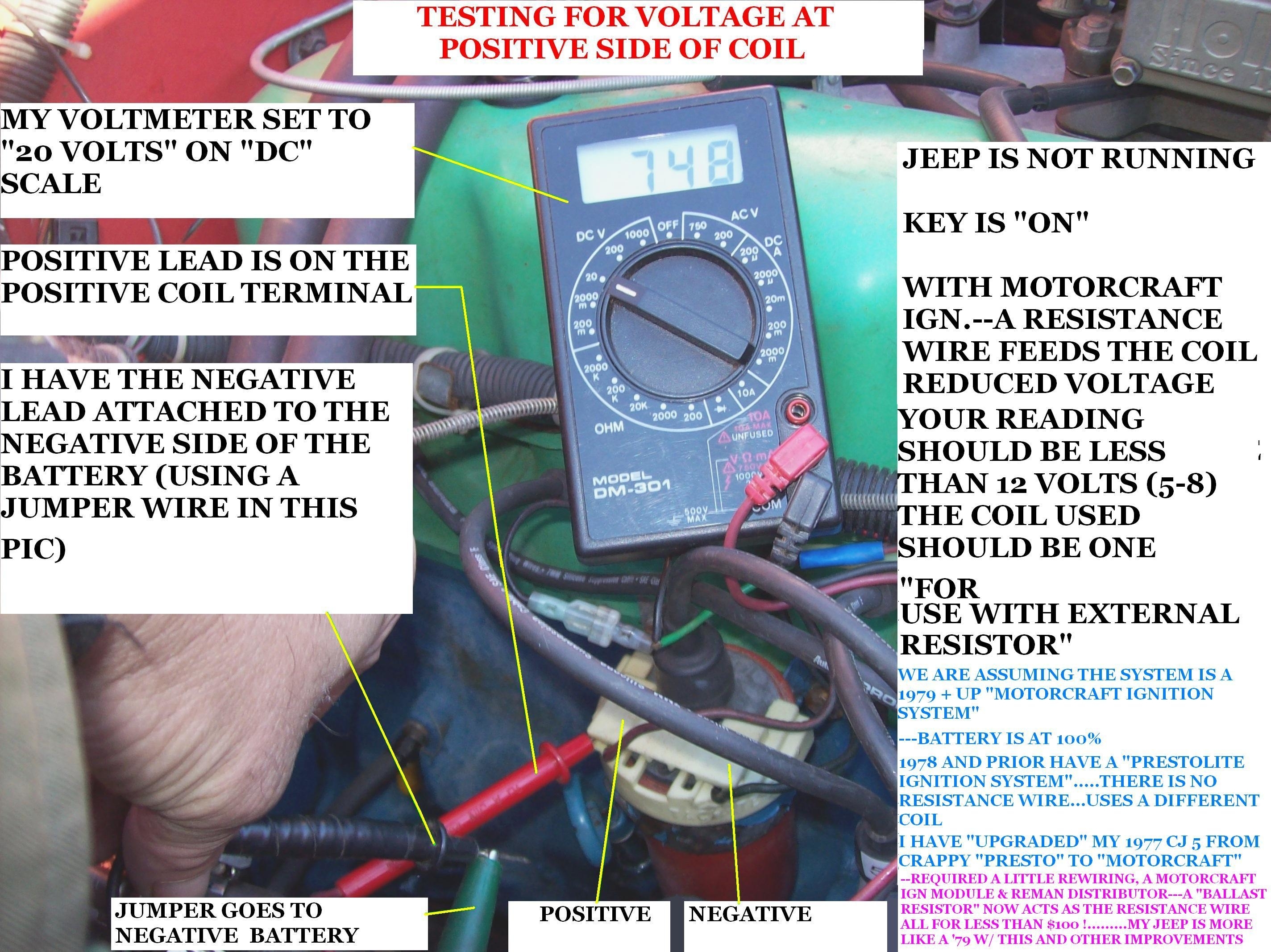

Turn the key "on".
What is the voltage at the positive side of the distributor?

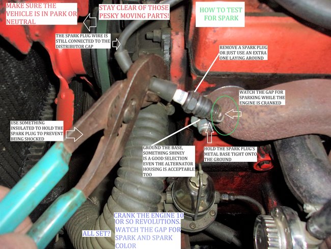

Do you have spark at any (just check one) spark plug?
Pic 1) of my '77 Jeep CJ-5
Pic 2) My '46 Willys Jeep

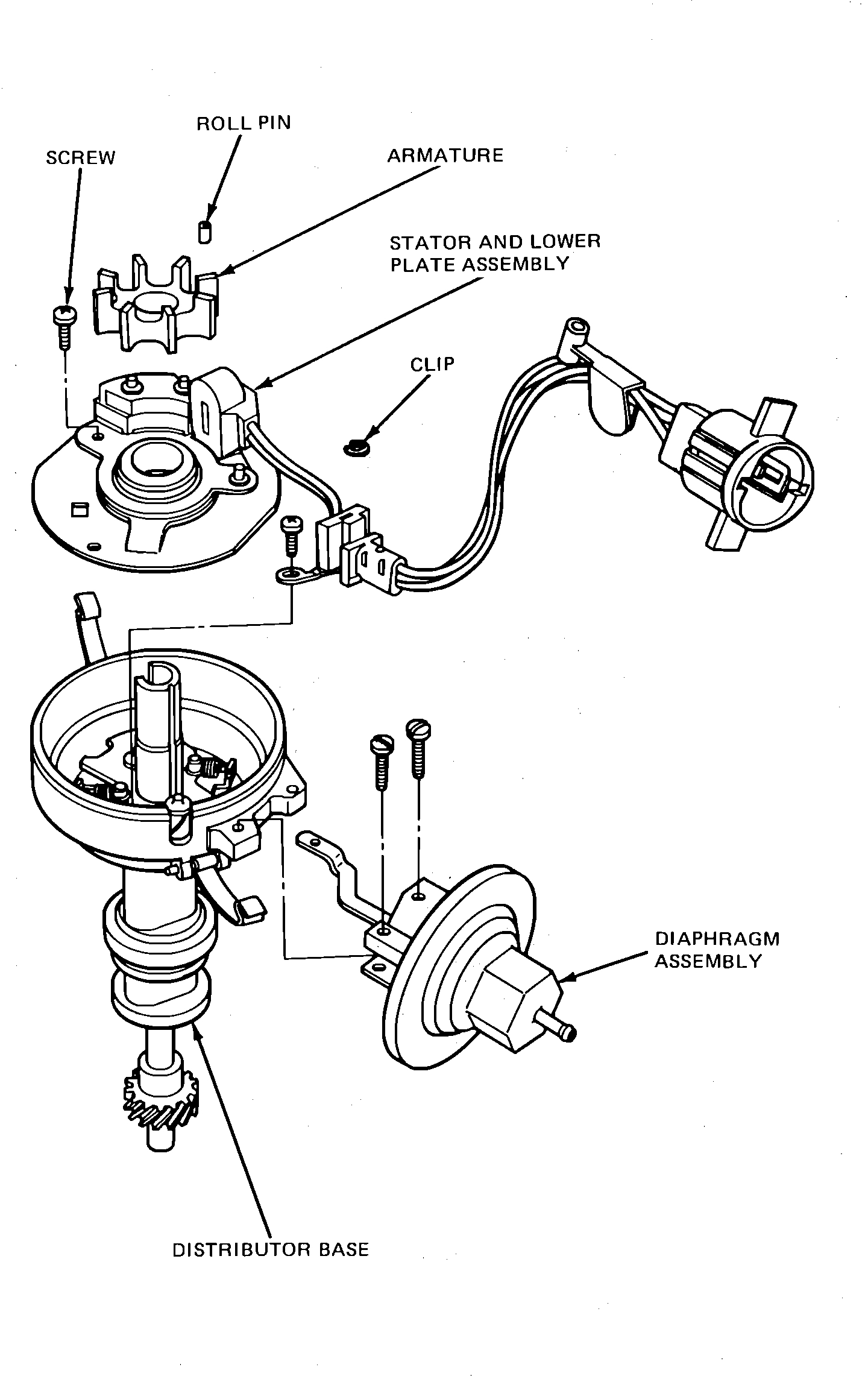

I don't know if this will help, but here are the directions for installing the distributor. The attached pic correlates with the directions.
__________________________________
1982 Ford Truck F 250 2WD Pickup V8-351 5.8L
DS II
Vehicle Powertrain Management Ignition System Distributor Service and Repair Procedures Removal and Installation DS II
DS II
Distributor - Exploded view
Pic 1
REMOVAL
On some models, it may be necessary to position thermactor air pump aside to gain access to distributor. It may also be necessary to disconnect the thermactor air filter.
1. Disconnect distributor electrical connector from engine wiring harness.
2. Disconnect vacuum advance hose, then remove distributor cap and position aside.
3. Remove rotor and adapter, then reinstall rotor.
4. Mark position of distributor in engine and position of rotor on distributor housing for installation reference.
5. Remove distributor hold-down bolt and clamp, then lift distributor out of engine. Do not crank engine after distributor has been removed.
INSTALLATION
1. If engine was not cranked after distributor was removed, proceed as follows:
a. Position distributor in engine, aligning housing to block marks and rotor to housing marks made during removal.
b. Install distributor hold-down bolt and clamp. Do not tighten at this time.
c. Install distributor cap and wire, then connect distributor electrical connector to engine wiring harness and attach vacuum advance hose.
d. Adjust ignition timing to specifications.
2. If engine was cranked after distributor was removed, proceed as follows:
a. Remove No. 1 spark plug and crank engine until compression pressure is felt in No. 1 cylinder. Slowly rotate engine until correct initial timing mark on crankshaft damper aligns with timing pointer.
b. Position distributor in engine with rotor at number one firing position and armature tooth aligned with starter . Ensure oil pump intermediate shaft properly engages the distributor shaft. It may be necessary to crank engine with starter after distributor drive gear is partially engaged in order to engage the oil pump intermediate shaft.
c. Install distributor hold down bolt and clamp. Do not tighten at this time.
d. Install distributor cap and wires, then connect distributor electrical connector to engine wiring harness and attach vacuum advance hose.
3. Adjust ignition timing to specifications. Due to higher ignition system voltage, a timing light specifically designed for this system should be used when checking ignition timing. If a timing light designed for this system is not available, an inductive pickup type timing light may operate satisfactorily in a piece of split vacuum hose is first placed around the spark plug wire.
NOTE: Refer to ADJUSTMENTS for rotor alignment.

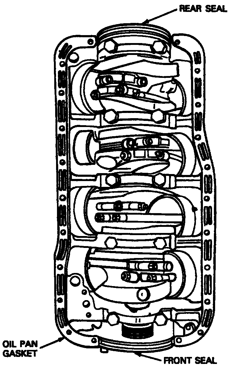

Here are directions for removal and replacement of the oil pan. Once it is off, the pump will be accessible.
Removal
Vehicle Engine, Cooling and Exhaust Engine Engine Lubrication Oil Pan Service and Repair Procedures Oil Pan, Engine Removal
REMOVAL
1. Remove the oil dipstick (on pan entry models only).
2. Remove the bolts attaching the fan shroud to the radiator and position the shroud over the fan.
3. Remove the nuts and lockwashers attaching the engine support insulators to the chassis bracket.
4. If equipped with an automatic transmission, disconnect the oil cooler line at the left side of the radiator.
5. Raise the engine and place wood blocks under the engine supports.
6. Drain the crankcase.
7. Remove the oil pan attaching bolts and lower the oil pan onto the crossmember.
8. Remove the two bolts attaching the oil pump pick up tube to the oil pump. Remove nut attaching oil pump pickup tube to the number 3 main bearing cap stud. Lower the pick-up tube and screen into the oil pan.
9. Remove the oil pan from the vehicle.
_________________________________________-
Installation
Vehicle Engine, Cooling and Exhaust Engine Engine Lubrication Oil Pan Service and Repair Procedures Oil Pan, Engine Installation
INSTALLATION
1. Clean oil pan, inlet tube and gasket surfaces. Inspect the gasket sealing surface for damages and distortion due to overtightening of the bolts. Repair and straighten as required.
See pic 1
2. Position a new oil pan gasket and seals to the cylinder block.
3. Position the oil pick up tube and screen to the oil pump and install the lower attaching bolt and gasket loosely. Install nut attaching to number 3 main bearing cap stud.
4. Place the oil pan on the crossmember. Install the upper pick-up tube bolt. Tighten the pick-up tube bolts to specifications.
5. Position the oil pan to the cylinder block and install the attaching bolts. Tighten to 13 - 14 N.m (9 - 11 ft. lbs.).
6. Raise the engine and move the wood blocks. Lower the engine and install the insulator to chassis bracket nuts and washers. Tighten the nuts to 73 - 100 N.m (54 - 74 ft. lbs.).
7. if equipped with an automatic transmission, connect the oil cooler line at the radiator.
8. stall the fan shroud attaching bolts.
9. Fill the crankcase with the proper grade and quantity of engine oil. Install the oil dipstick. Start the engine and operate it until it reaches normal operating temperature, then check for leaks.
