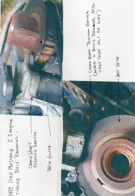

I was trying to upload pictures of my issue but taking forever. I thought I may be able to redo here, but does not look so. My issue is the belt guide is blocked by the crankshaft position sensor. I removed two bolts from it, but it still will not budge. I put a screwdriver behind it and tried to tap it off, still no luck. Can you help?
Thanks

Hello, '
there must be a bolt around the side or near the bottom you are not seeing, can you upload pictures of the whole sensor and mount please?

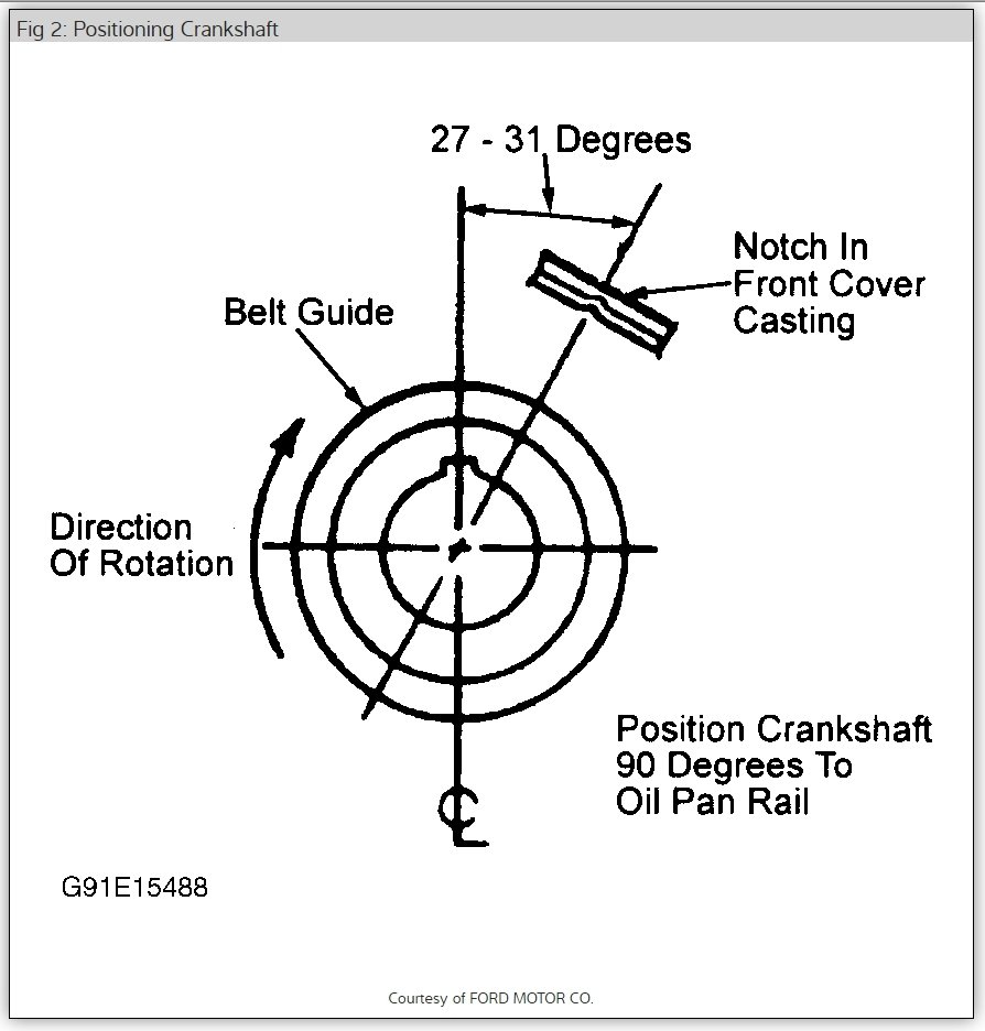

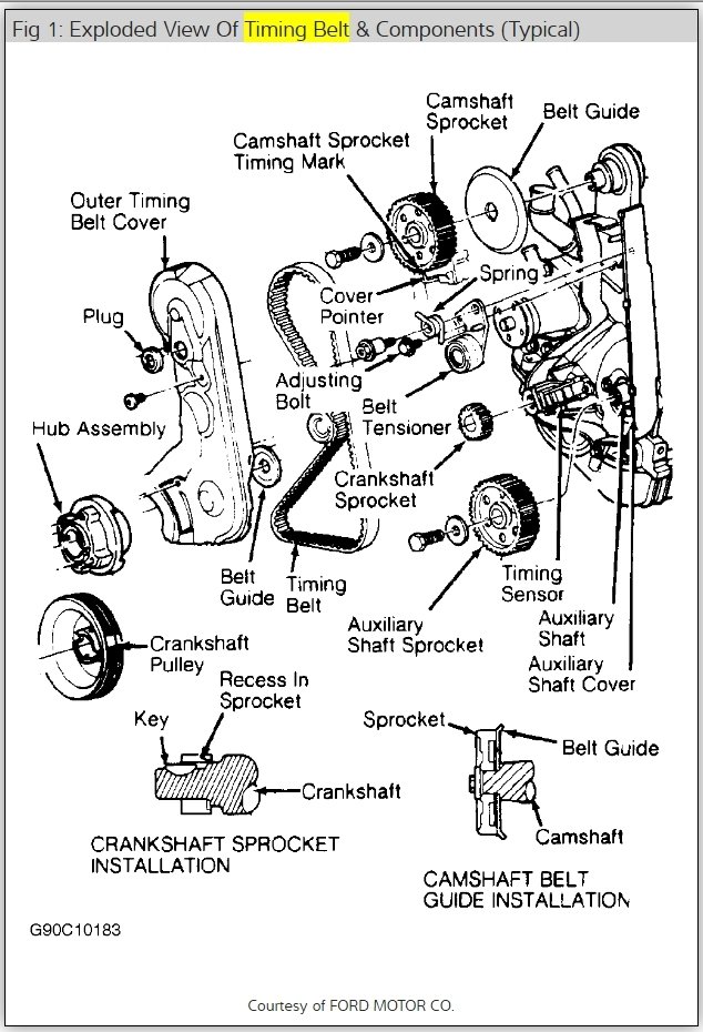

Thanks for your reply. I was finally able to get it removed. There was a stud that the sensor was kinda frozen to. After rotating it and pulling at the same time it came off. New belt has been installed, but there seems to have too much play in the belt. It almost seems to be off about a half a tooth. We marked position of the cam and crank shaft with whiteout to ensure nothing moved. But in order to get the slack out, looks like we will have to move those marks about an 1/8" to 1/4". Will this present a problem? Or any other suggestions?
Thanks Fred Lewis

Good to hear you got the sensor off of there, I found these diagrams for you to get a reference from.
Let me know how it goes so it will help others.
