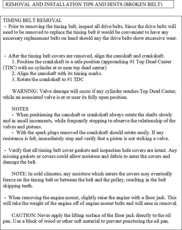

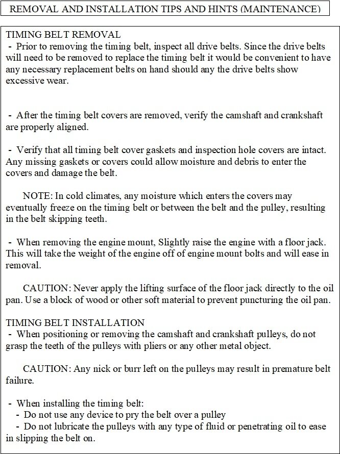

Cost of the belt varies, but for my '88 Grand Caravan, it was very inexpensive. The 3.0L engine is not an interference engine, so if the belt breaks or jumps a few teeth, the worst is you'll be sitting on the side of the road needing a tow. Timing belts typically break while driving. They most commonly jump a tooth or more when the engine is turned off.
The timing belt also runs the water pump, and since replacing the pump takes just as long, every conscientious mechanic will want to replace the water pump at the same time, along with any idler pulleys. Add another 0.1 hour for the tensioner, and an additional 0.2 hours for the water pump.

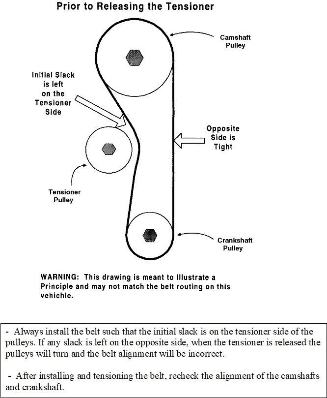

Also be aware the tensioner pulley is spring-loaded. You loosen a bolt, allow the spring to pull the belt tight, then tighten the bolt. On one of my 3.0Ls, the pivot was sticking and the spring didn't pull the belt tight enough. If that happens, just put a little extra pressure on it with a small pry bar.
The 3.3 / 3.8L used in other models uses a timing chain. Those are also non-interference engines. Chrysler's first domestic interference engine was used in the '95 Neons. Those were four-cylinder engines.
