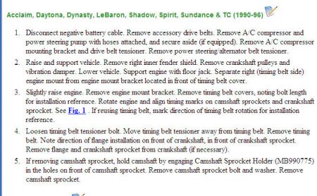

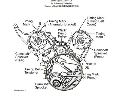

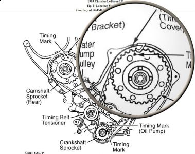

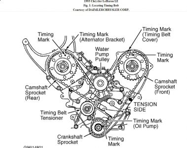

I broke the timing belt, I am unsure of how to set up the timing marks to ensure that I have TDC on No 1 Cyl. Do I just set the timing marks up that are on the Crankshaft gear to the mark on the oil pump housing? Or is there something else I need to do?

TDC can be checked with a long screwdriver and marked for when it is at TDC. Then after aligning the marks, recheck with the marked screwdriver.
