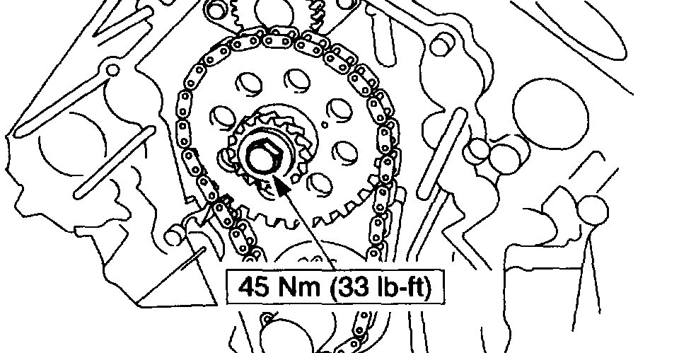

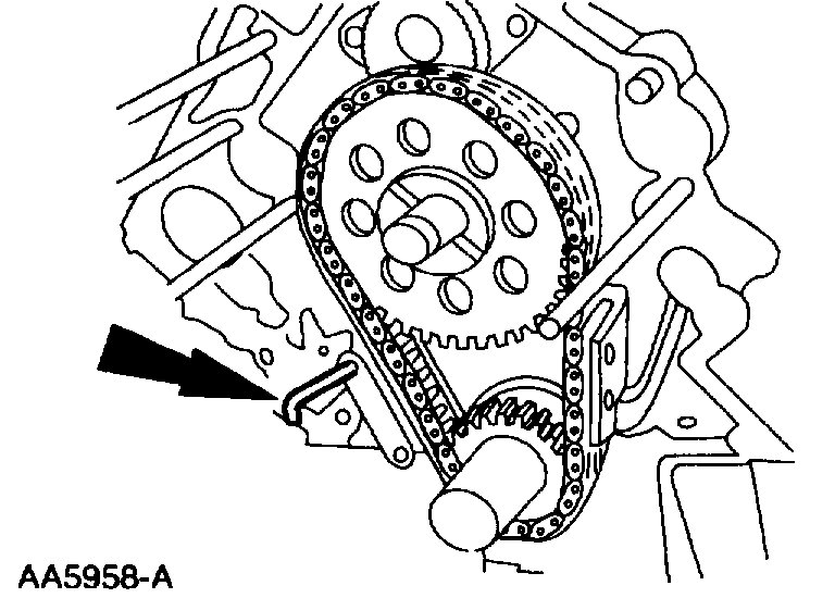

I installed a little bigger than stock comp cams can with 480.lift. I also installed the recommended push rods and valve springs. I installed all new gaskets, rear main seal,timing chain, cam position sensor and crankshaft position sensor. Since I got it all reassembled I can't get it to fire, it just backfires once and that's it. I set the timing according to the factory manual but that's for stock cam so I don't know if that's the problem or what. I need help!

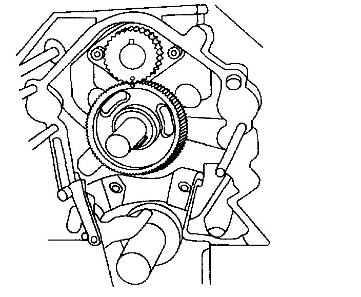

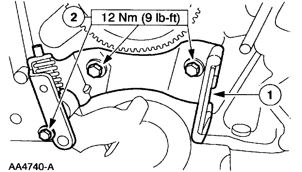

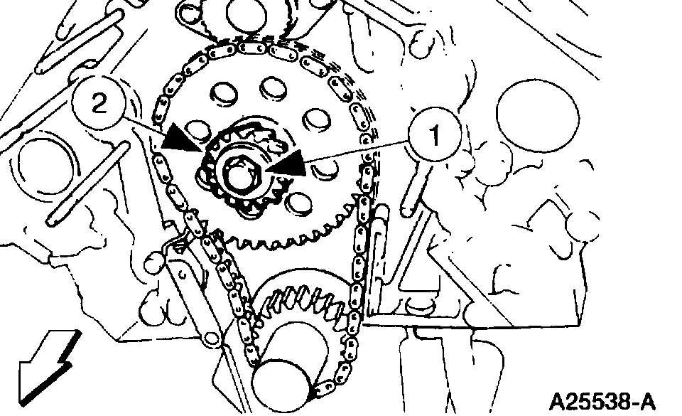

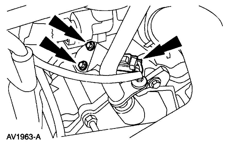

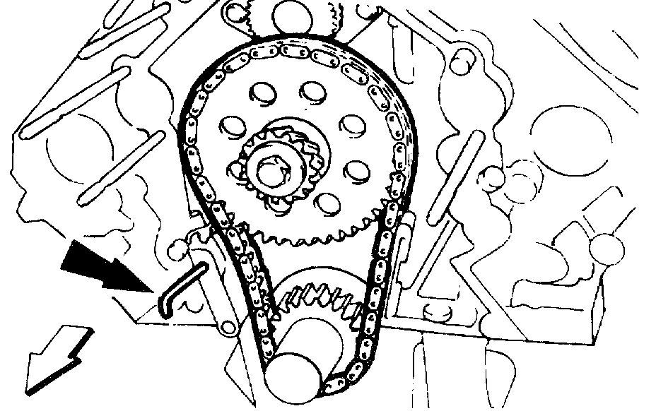

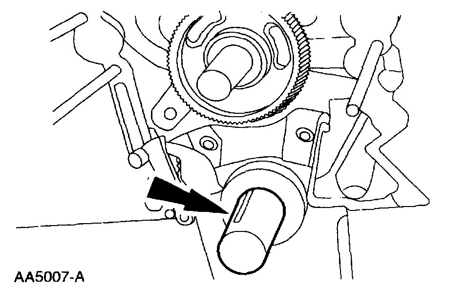

Timing won't change due to the cam. I am going to provide both the removal and install directions for the chain and the cam sensor. Take a look through everything and confirm you did it as indicated. The attached pictures correlate with the directions.

1. Remove the timing cover.
pic 1
2. Remove the camshaft position sensor drive gear.
1. Remove the bolt.
pic 2

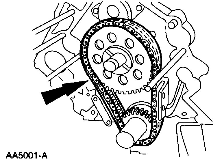

3. Rotate the crankshaft until the timing marks and keyways align.
pic 3

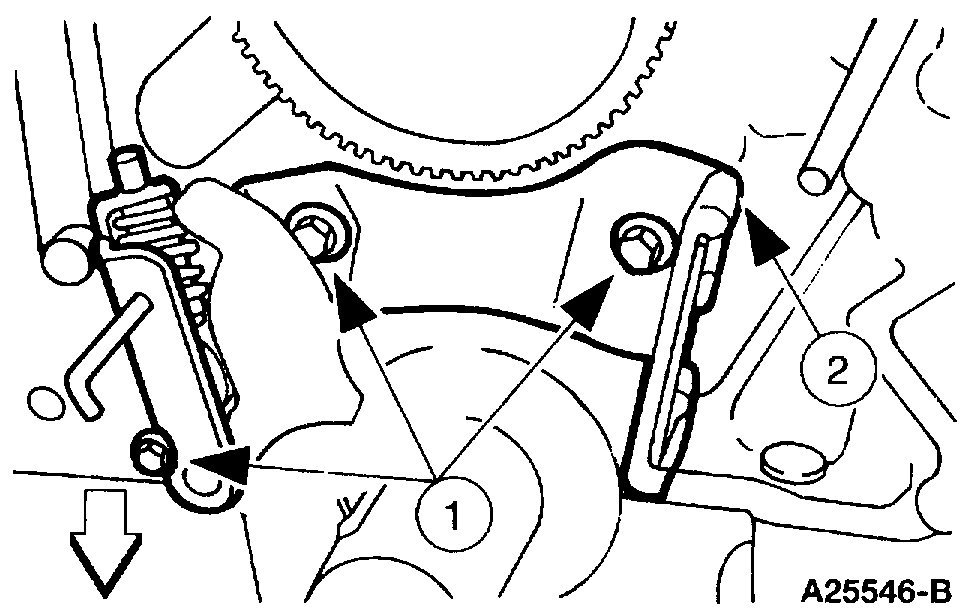

4. Compress and install a retaining pin to hold the timing chain tensioner.
pic 4
5. Remove the camshaft sprocket, the crankshaft sprocket and the timing chain/belt as an assembly.
pic 5
6. Remove the timing chain tensioner.
1. Remove the bolts.
2. Remove the timing chain tensioner.
Installation
pic 6

2. Rotate the crankshaft so the number one piston is at Top Dead Center (TDC) and the key is at the 12 o'clock position.
pic 8

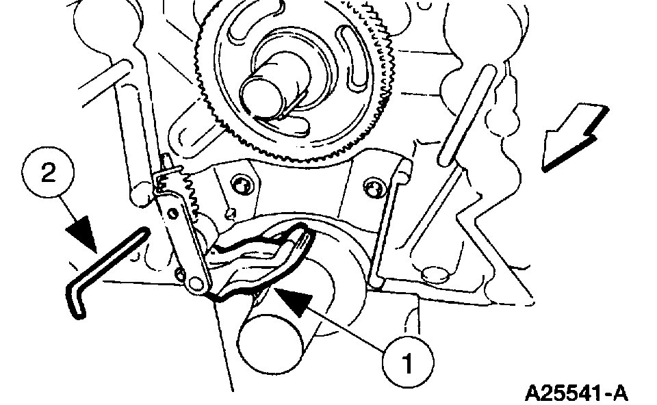

3. If necessary, retract the tensioner pad retracting mechanism.
1. Compress the tensioner pad retracting mechanism.
2. Insert a retaining pin.
pic 9

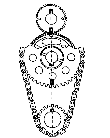

4. Turn the camshaft sprocket so that the timing mark is on the bottom of the balance shaft.
pic 10
5. Install the timing chain, the camshaft sprocket and the crankshaft sprocket.
pic 11
6. Make sure that the timing marks and the keyways are aligned.
pic 12
7. Install the camshaft position sensor drive gear.
pic 13
8. Remove the retaining pin.
9. Install the engine front cover.

Let me know if this helps or if you have other questions. Also, let me know what you are referring to with the cam sensor. It should be a plug and play component.

I did everything as indicated. Those are the exact same pictures as in my factory manual. I just don't know if I can camshaft sycronyzer at the degrees from engine center-line.

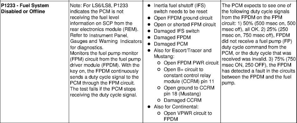

I have checked compression, all cylinders were over 100 except for 1 at 80. I think I had noticed wet plugs in the past. Also last night I got a code I believe p1233 or 1223 for fuel pump driver module (disabled or offline). Have located the module, not quite sure how to go about testing it.
Aug 19, 2019 at 2:54 PM
  • 110,248 POSTS
Welcome back:
Take a look at the picture I attached. It shows possible causes and describes the code. Check the inertia switch first.
