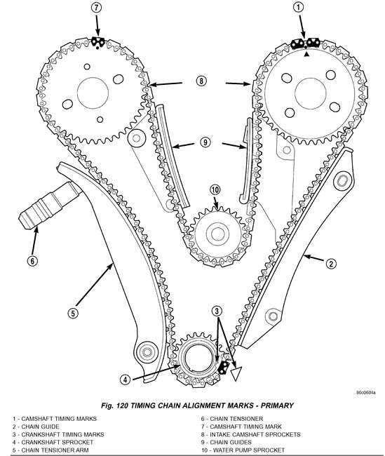

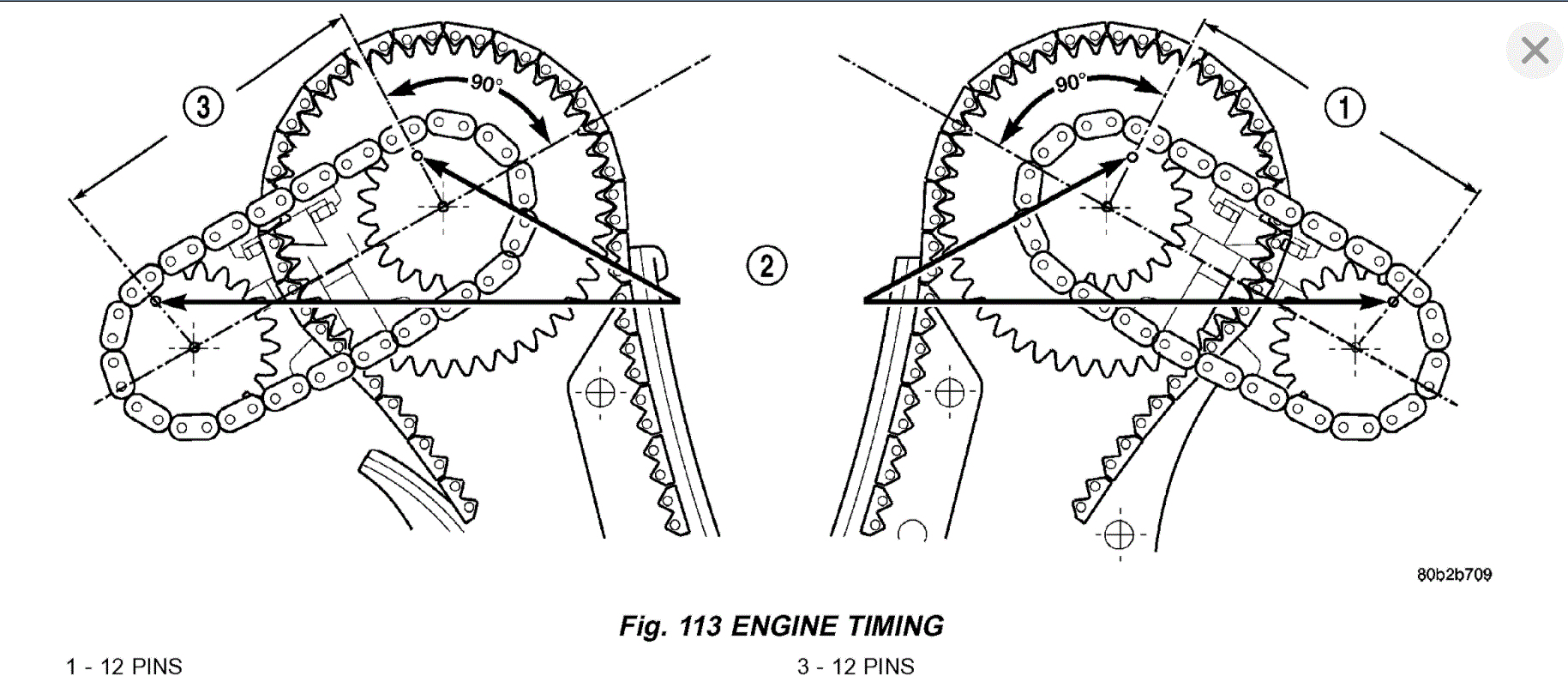

This engine is an interference engine. Basically, if the timing was off, it may have caused internal damage to the valves or pistons.
I attached a pic below of the timing mark positions. Is that where they were?
Aug 29, 2020 at 2:12 PM
NOSDUHONE
  • 7 POSTS
Yes, twice.

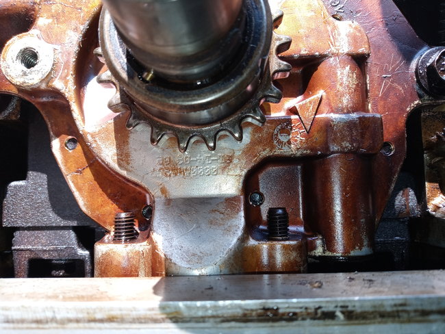

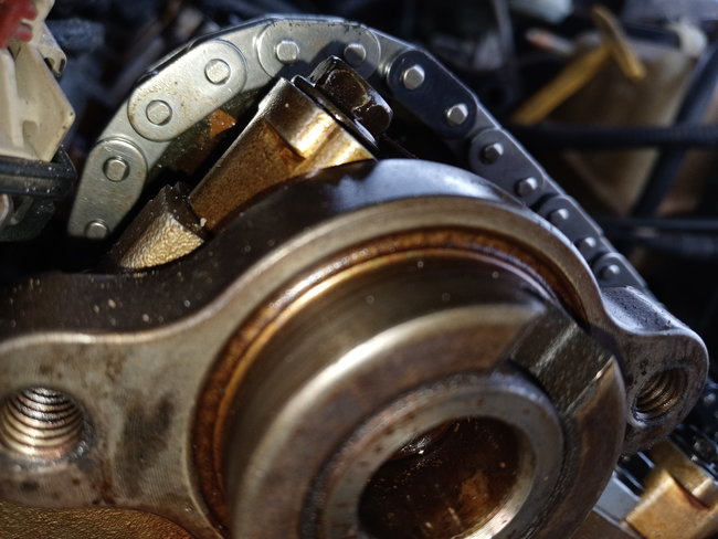

Will the test be accurate with the way it is cranking over? Also, on the left bank cam sprockets, what is the triangle for?
Aug 31, 2020 at 8:03 AM
  • 110,194 POSTS
Sorry for the delay in getting back to you. The internet caused me issues.
As far as the compression, you will remove all plugs so it will turn faster and yes it will work.
As far as the triangle, I'm not sure what you are referring to. I attached a pic below. Copy and circle what you are referring to.

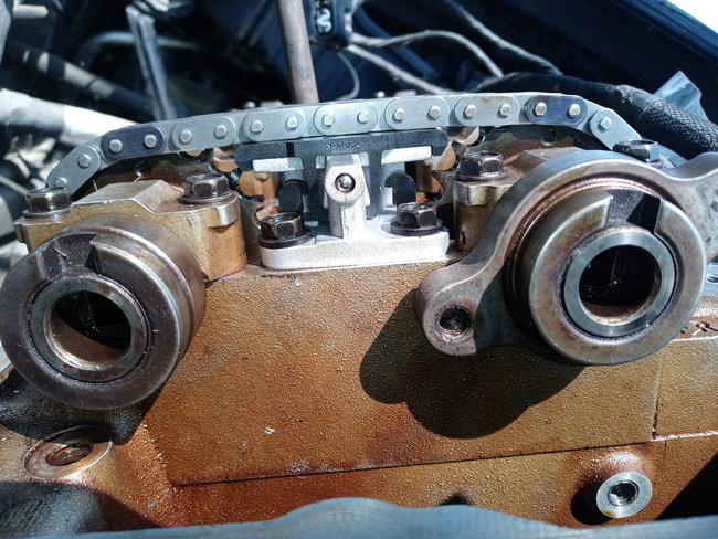

NOSDUHONE
  • 7 POSTS

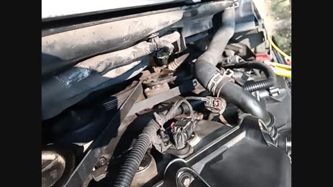

Another attempt same situation. This time new kit was put in.
Sep 11, 2020 at 8:43 PM
  • 110,194 POSTS
The timing marks look spot on. What is happening?

pic 1

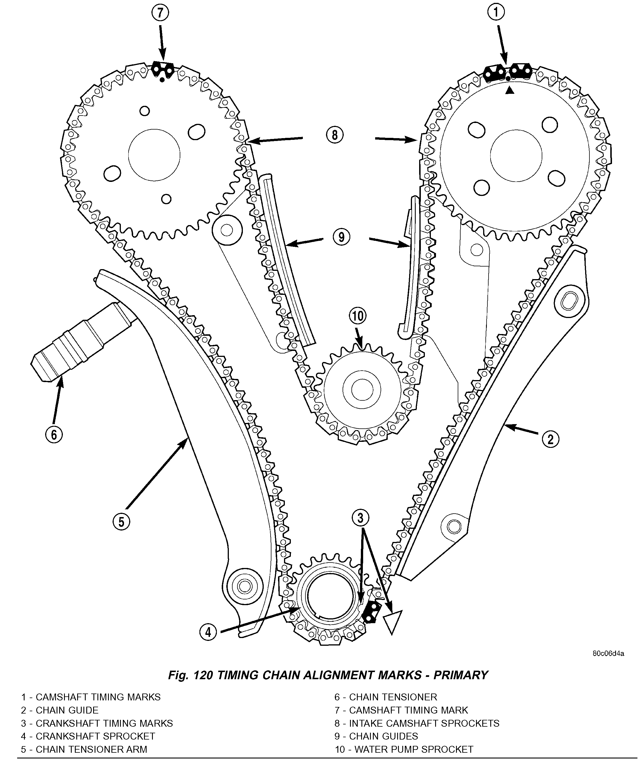

4. Align crankshaft sprocket timing mark to the mark on oil pump housing (Fig. 120).
NOTE: Lubricate timing chain and guides with engine oil before installation.
5. Place left side primary chain sprocket onto the chain so that the timing mark is located in-between the two (plated) timing links (Fig. 120).
6. Lower the primary chain with left side sprocket through the left cylinder head opening.
NOTE: The camshaft sprockets can be allowed to float on the camshaft hub during installation.
7. Loosely position left side camshaft sprocket over camshaft hub.
8. Align timing (plated) link to the crankshaft sprocket timing mark (Fig. 120).
9. Position primary chain onto water pump drive sprocket.
10. Align right camshaft sprocket timing mark to the timing (plated) link on the timing chain (Fig. 120) and loosely position over camshaft hub.
11. Verify that all chain timing (plated) links are properly aligned to the timing marks on all sprockets (Fig. 120).

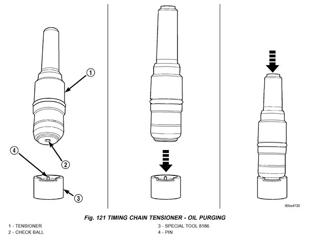

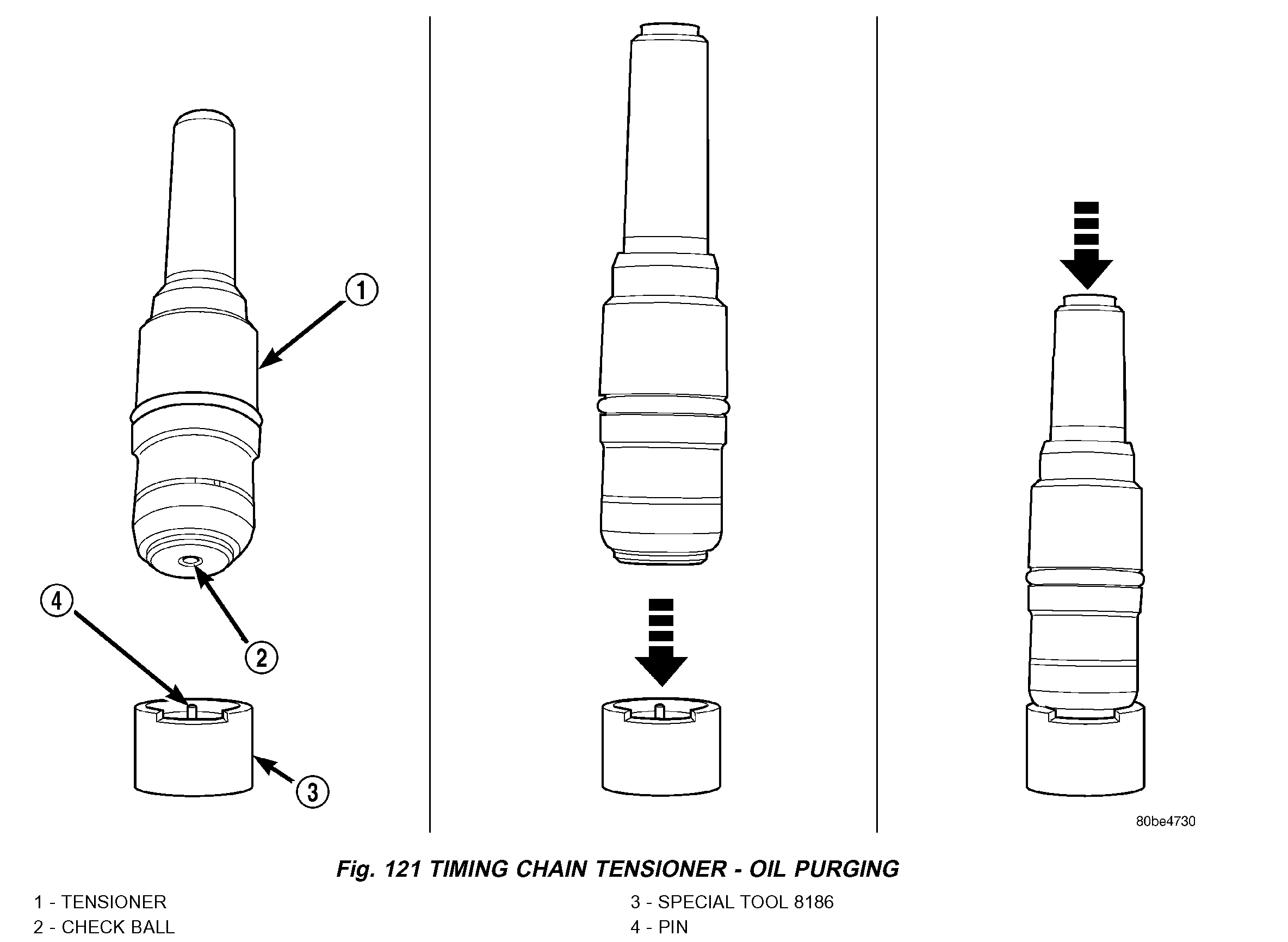

NOTE: To reset the primary timing chain tensioner, engine oil will first need to be purged from the tensioner (Fig. 121).
14. Purge oil from timing chain tensioner using the following procedure:
a. Place the check ball end of tensioner into the shallow end of Special Tool 8186 (Fig. 121).
b. Using hand pressure, slowly depress tensioner until oil is purged from tensioner (Fig. 121).

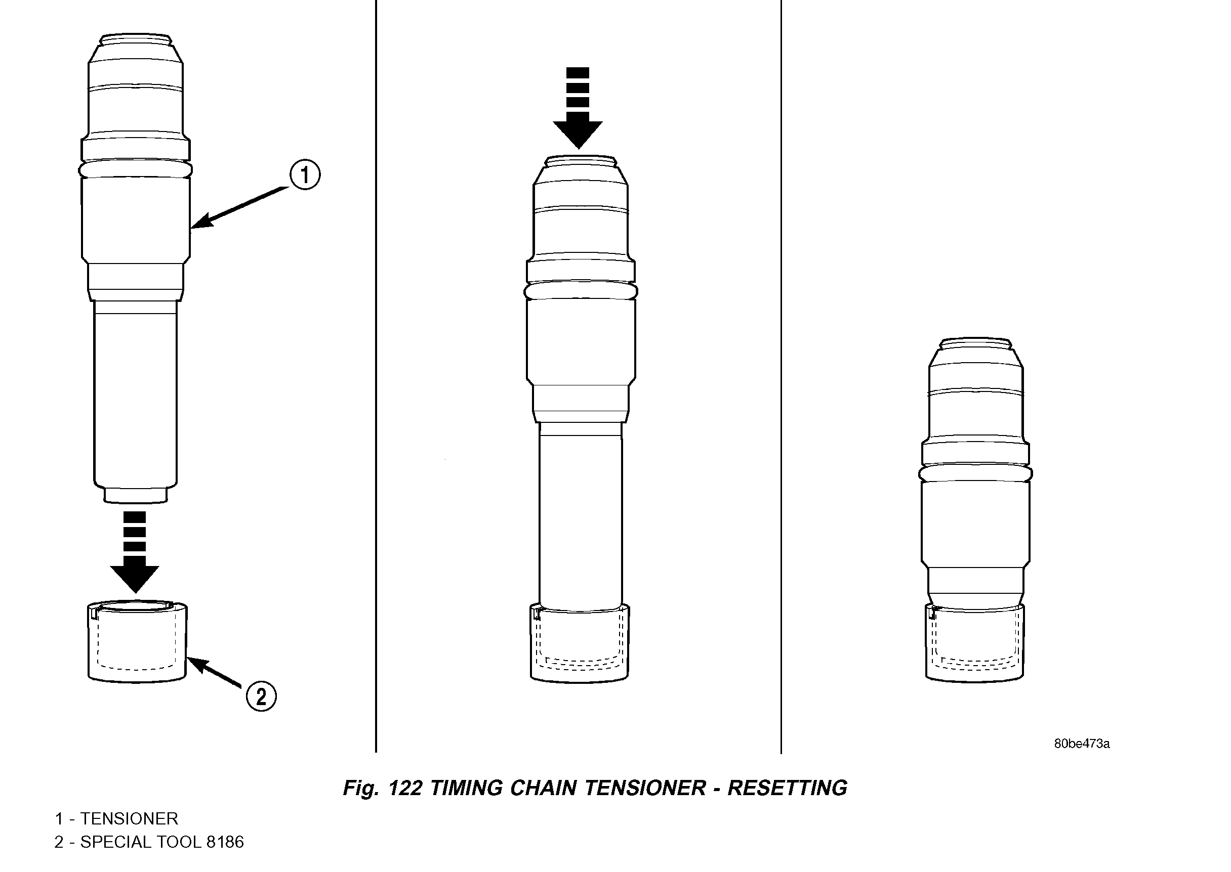

15. Reset timing chain tensioner using the following procedure:
pic 3
a. Position cylinder plunger into the deeper end of Special Tool 8186 (Fig. 122).
b. Apply a downward force until tensioner is reset (Fig. 122).
NOTE: If oil was not first purged from the tensioner, use slight finger pressure to assist the center arm pin of Special Tool 8186 to unseat the tensioner's check ball.
CAUTION: Ensure the tensioner is properly reset. The tensioner body must bottom against the top edge of Special Tool 8186. Failure to properly perform the resetting procedure may cause tensioner jamming.

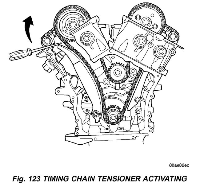

21. Activate the timing chain tensioner by using a flat bladed pry tool to gently pry tensioner arm towards the tensioner slightly (Fig. 123). Then release the tensioner arm. Verify the tensioner is activated (extends).
