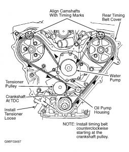

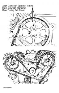

2002 Dodge Intrepid TIMEING
GARY EATON
MEMBER
2002 DODGE INTREPID
Engine Mechanical problem
2002 Dodge Intrepid 6 cyl Front Wheel Drive
WHAT IS THE TIMEING FOR A 2002 V6 INTREPID
ON THE CRANK AND OTHER COMPOTEDS
TOP DEAD CENTER WHAT
Wednesday, June 23rd, 2010 AT 5:38 PM
BLUELIGHTNIN6
MECHANIC
16,542 POSTS
SPONSORED LINKS
Wednesday, June 23rd, 2010 AT 9:04 PM
